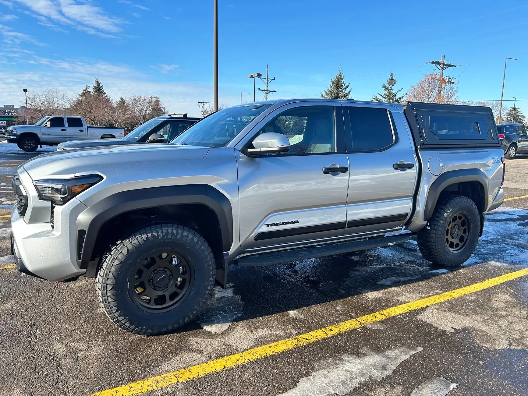

I finally decided on wheel and tire combo. Thank you to everyone for advice and pics.
Wheels: Method 705 +35 offset
Tires: Nitto G3 285/70/17

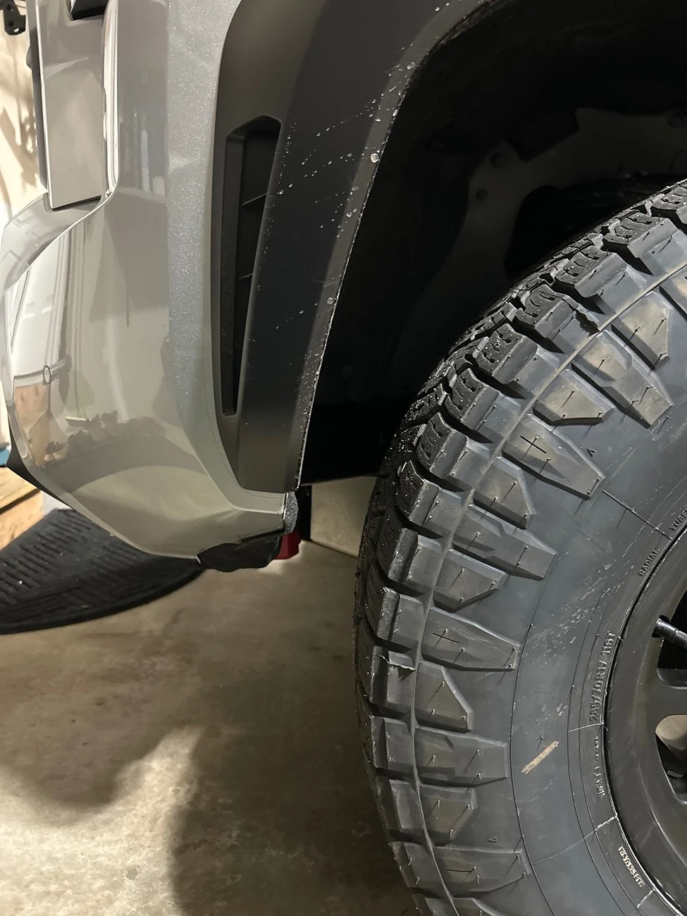

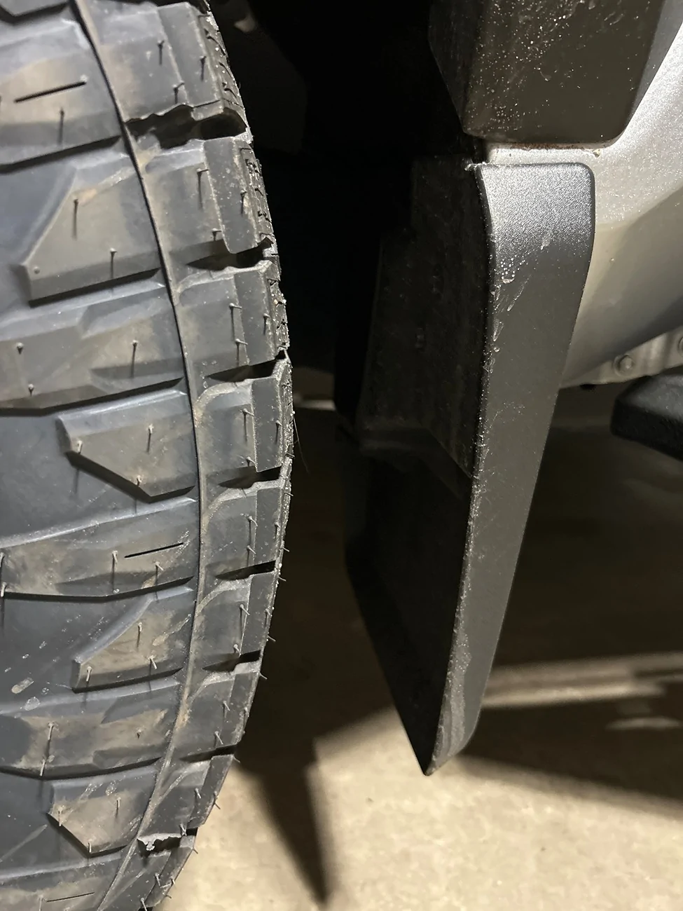

Looks good. Have you got it to full articulation? I'm considering the same set-up with a 35mm offset and 285/70/17 MT Baja Boss A/Ts. With tires wider than stock with +20 mm offset and narrower tires by an inch or so I'm wondering about rubbing at full articulation and an unlocked stabilizer bar. Any info would be appreciated.
There is no rubbing with my set up. I’ve had it full articulation going up and down my driveway at the curb and there is plenty of room. I was initially worried about the inside dimple of the Canadian mud guards I have allowing enough clearance. However, happy to report no issues. Here’s a couple pics to see how the front tire sits.
