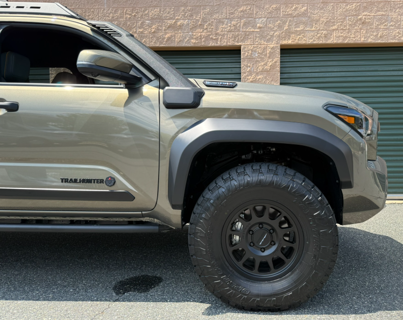

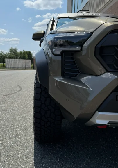

I'll get some better pics, I was in the same boat where I felt like the trialhunter wheels were sort of what set it apart and didn't want to get rid of them. There are definitely limited options for 18" wheels when it comes to load rating and that's what made me finally switch over to the methods - plus the added benefit of bead grip. I went with a +35mm offset and with the 12.5" width of the 35" it's the exact same tire poke as factory. Perfectly lines up with the fenders. Had to remove the crash bracket as well.

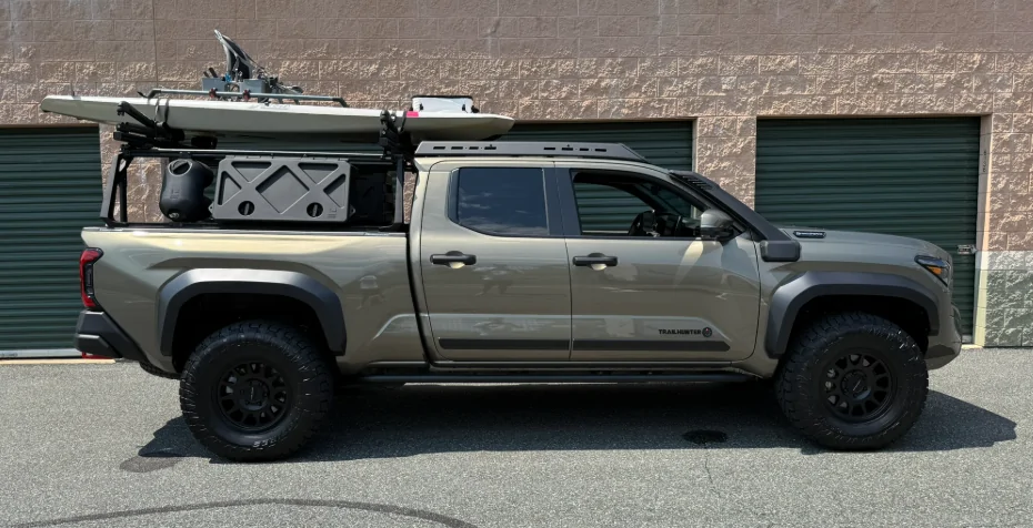

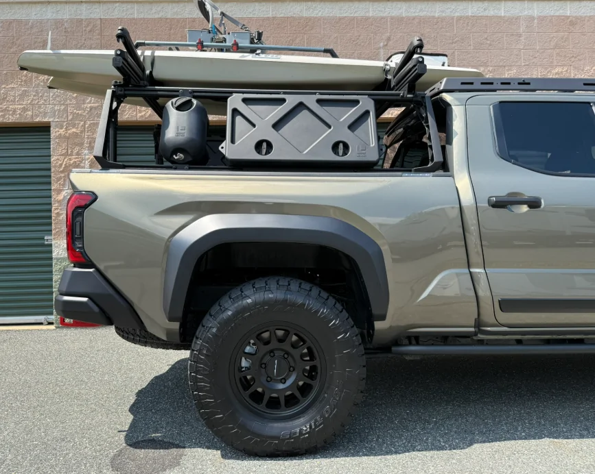

Got some quick pics while i was unloading my fishing gear. The kayak only weighs about 50lbs right there, everything else is out of the bed so that's the normal ride height without being loaded up on gear.

That looks great. You may have persuaded me! Thanks for the pics!
