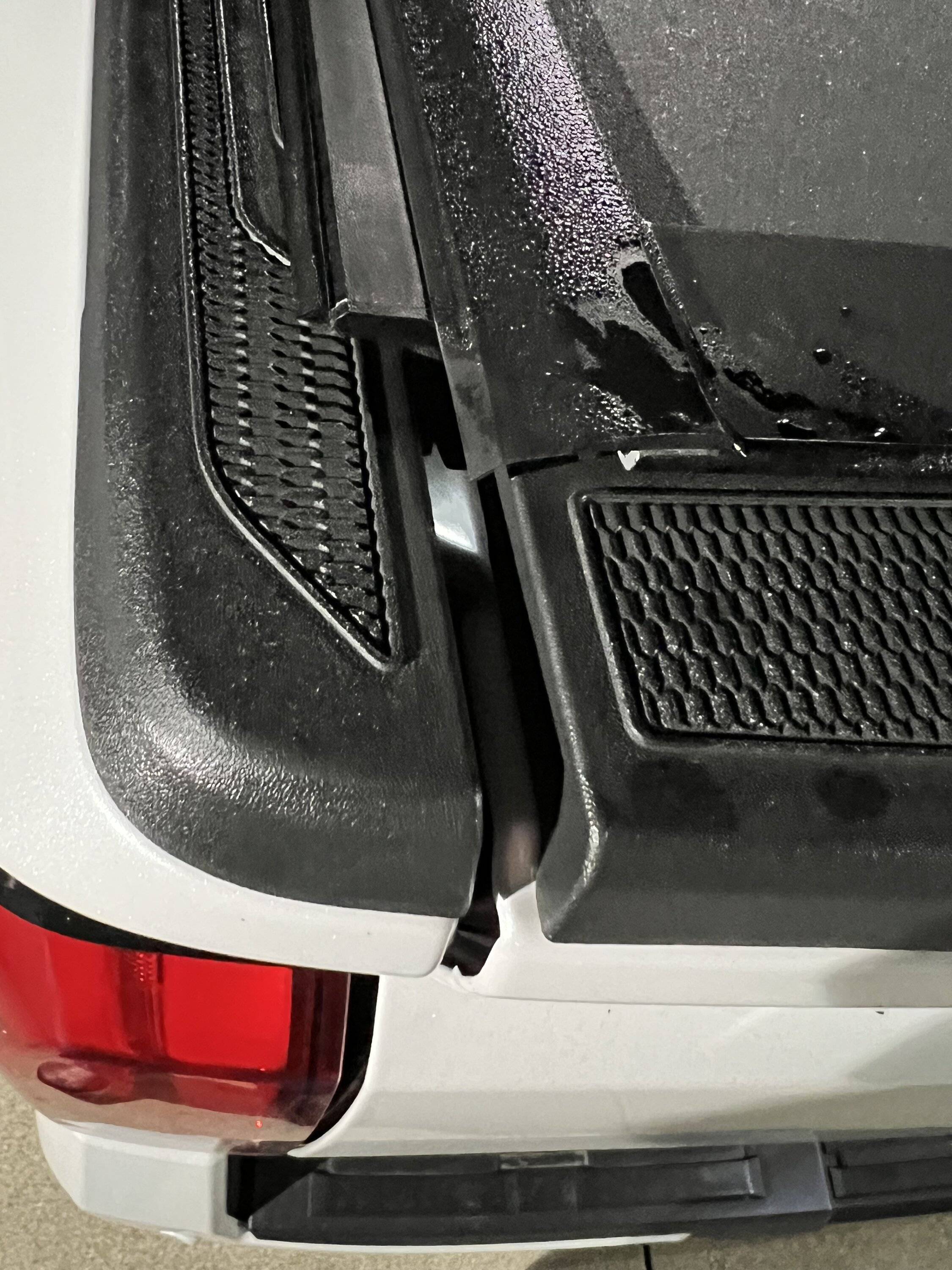

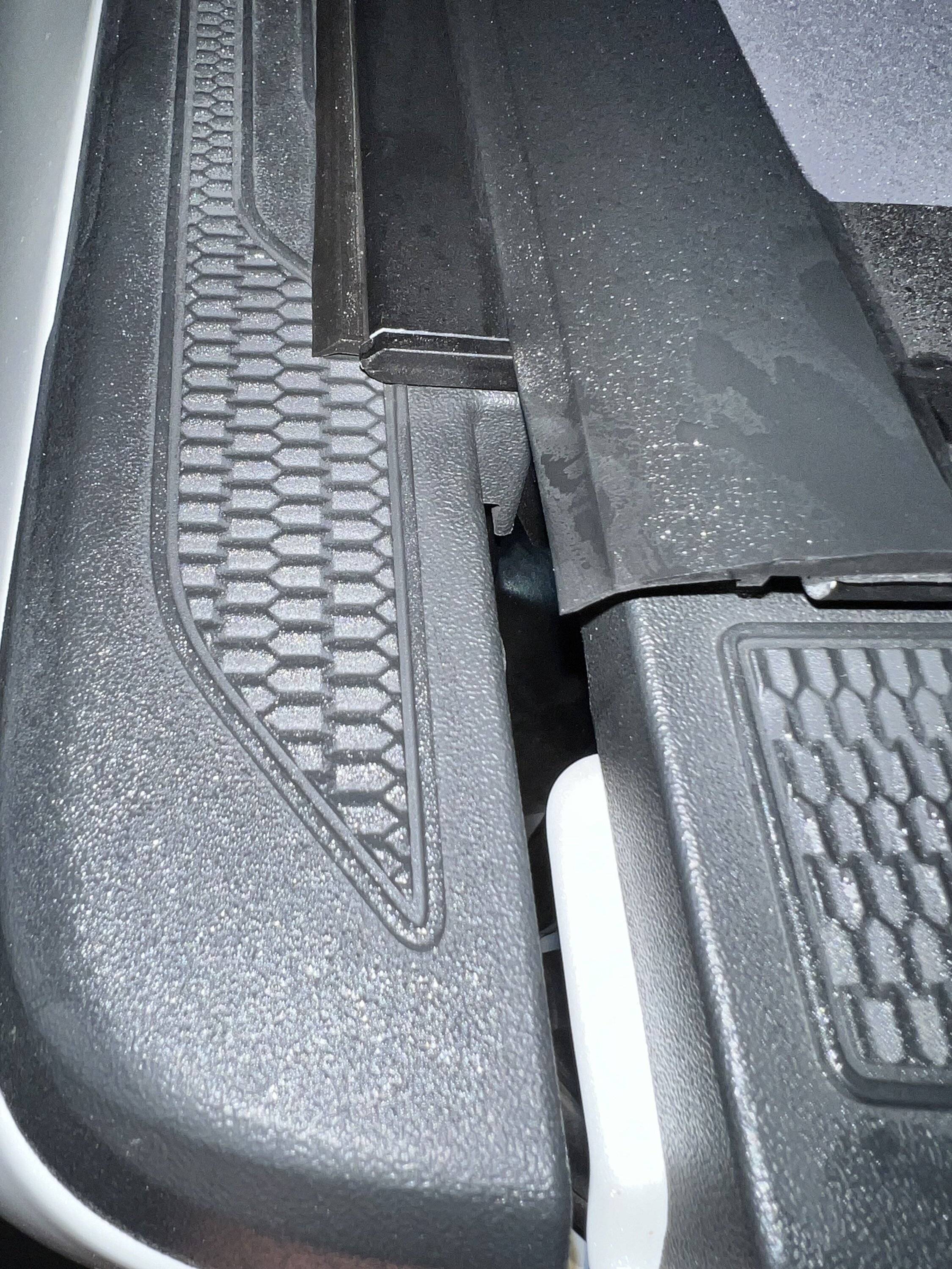

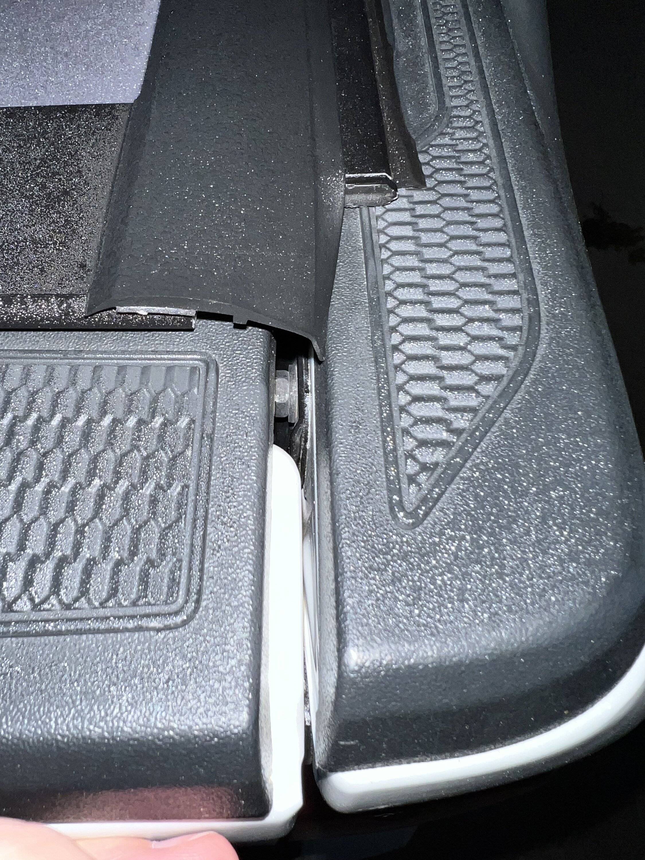

The gaskets don’t cover the corner gap at the tailgate…. Is this normal?

Bring it back a little. I had to do that as well as add some weatherstripping on all 4 corners

I'll look into that, I thought I had it pulled back as far as I could without the extruded aluminum not interfering with the tailgate. But I had just used the molded plastic tops to determine that. I'll see if I can move it back more and hopefully that'll span that gap to keep water out.
Would any of you that have installed the OEM cover post a photo of the corners at the tailgate so I can see what it looks like in proper position?
Thank you all...

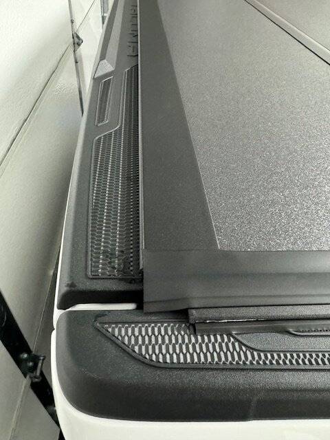

Here is mine. I have been through 4-5 car washes and 2 torrential downpours with zero water getting in. I even have a printer sitting in the back by the tailgate plugged into the AC outlet. Never had a drop on it.

Your cover is definitely back farther than mine. I'll have to see if I can get mine back. Thanks for the photo.
