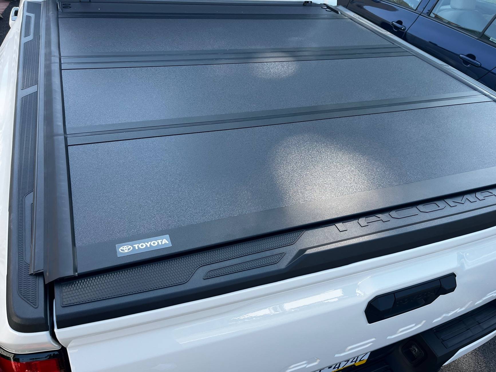

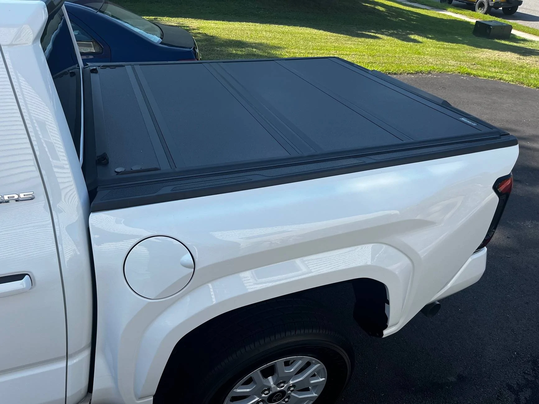

Just installed my OEM Toyota hard bed cover. Super high quality and easy to install. Looks great too, if anyone is on the fence call your Toyota dealer and order one.
I noticed on your pictures that the "old style" mount extends out to the plastic rails. That's nice. The new MX4 doesn't extend that far out so there are some gaps where water can get in. Too late for me since I've already installed the MX4 but worth noting if anyone else is trying to decide in the future. Sounds like the OEM one is the way to go.
Oem one is deff way to go

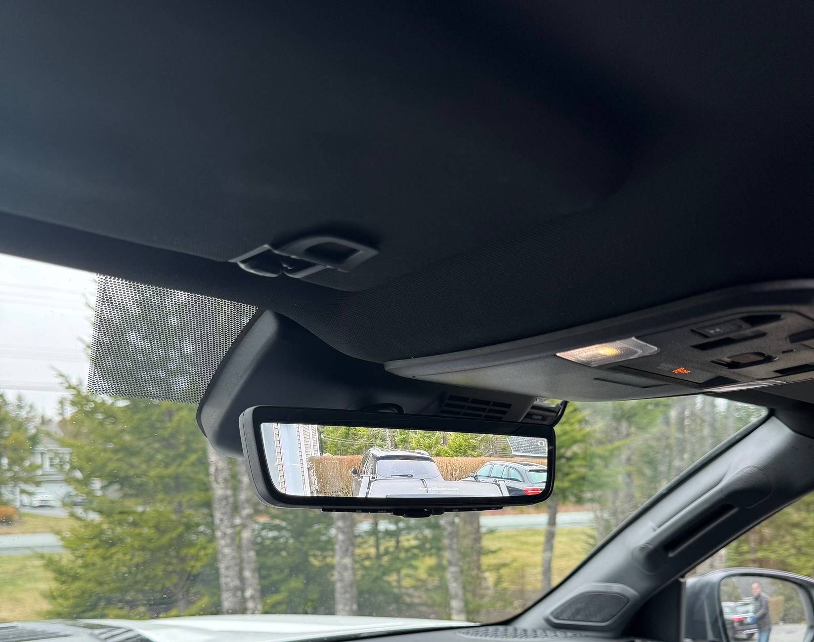

I seen everyone talking about how it covers the cameras when it’s folded up and I wanted to see what I could do about it, I loosened the nuts on my tonneau and slid them all the way back towards the tailgate and sure enough when it’s locked in my camera can see over top of it
