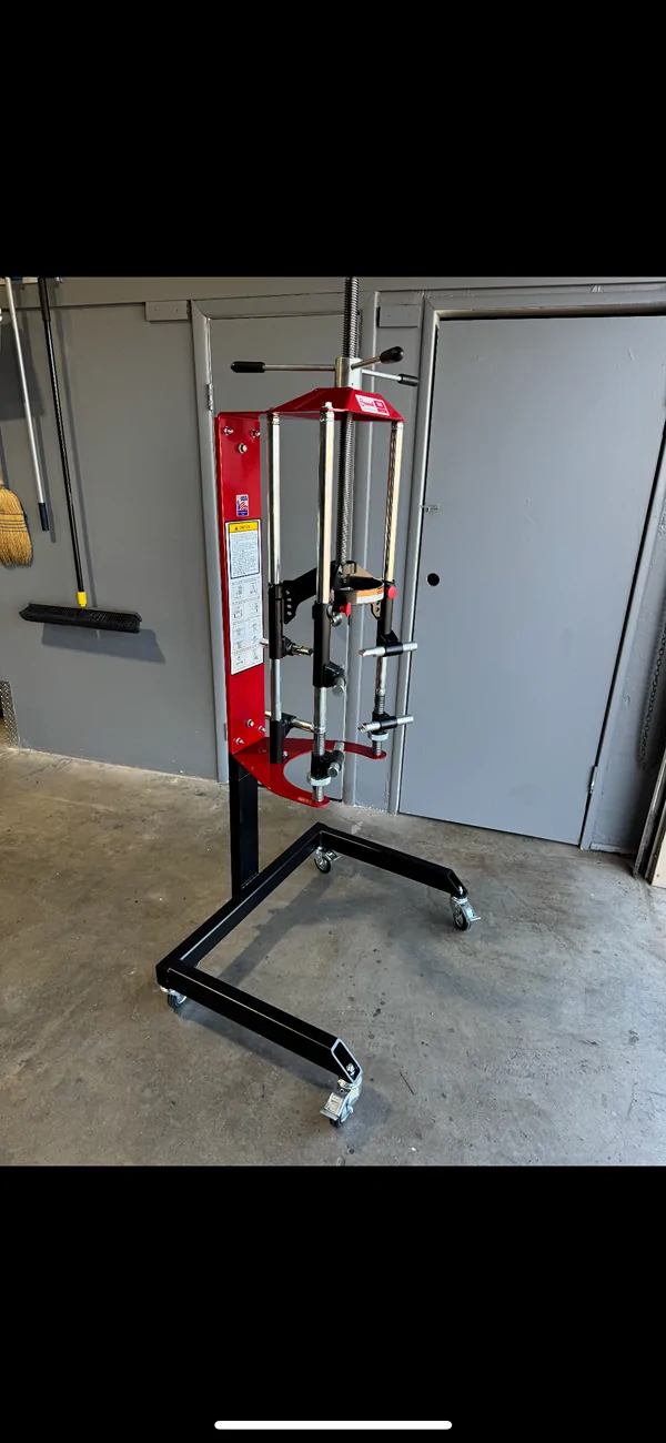

I’m getting a spring compressor in the coming days to adjust them as well.

My buddy has a floor compressor and they don’t have to take anything apart and took about 10 min to do both. If the shop gives you shit about adjusting it for cost that’s BS. It’s super simple
2024 Tacoma OME MT64 - Question IMG_3856
