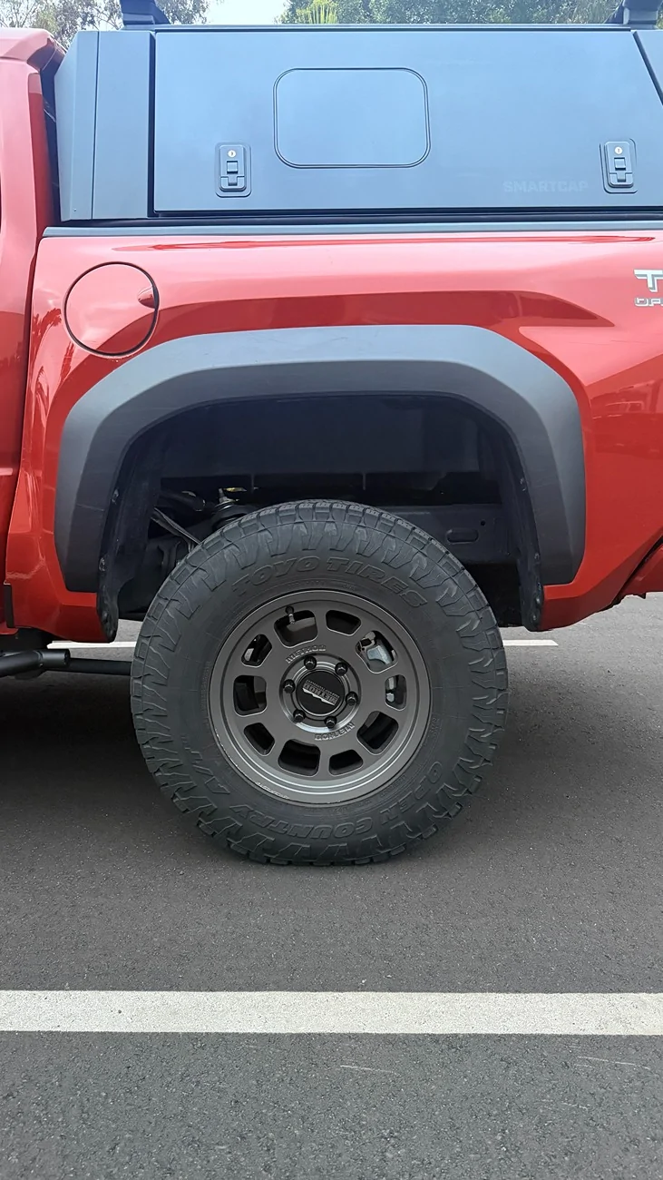

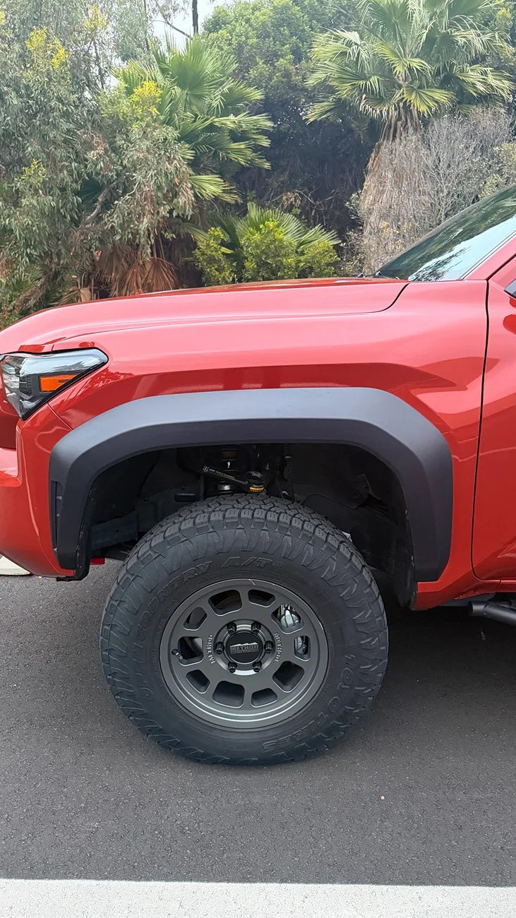

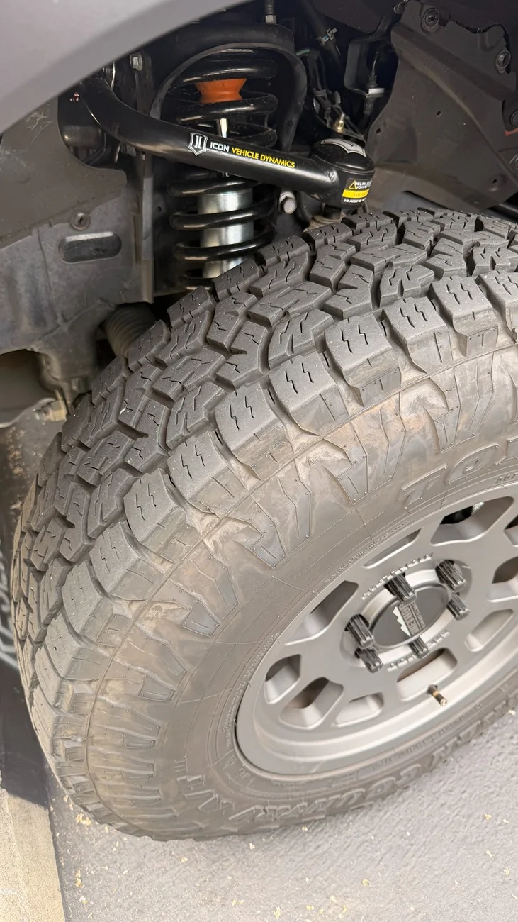

As one of a handful of people in the country actually driving a 4g on 6112s so far (Still haven't seen a picture of another set installed?) I would ask what has made you reconsider? They're fucking amazing. I have no regrets and am 100% satisfied with them.
2024 Tacoma Lift Advice (Considering OME BP-51's) IMG_9613
2024 Tacoma Lift Advice (Considering OME BP-51's) IMG_0102
2024 Tacoma Lift Advice (Considering OME BP-51's) IMG_0099
2024 Tacoma Lift Advice (Considering OME BP-51's) IMG_0034

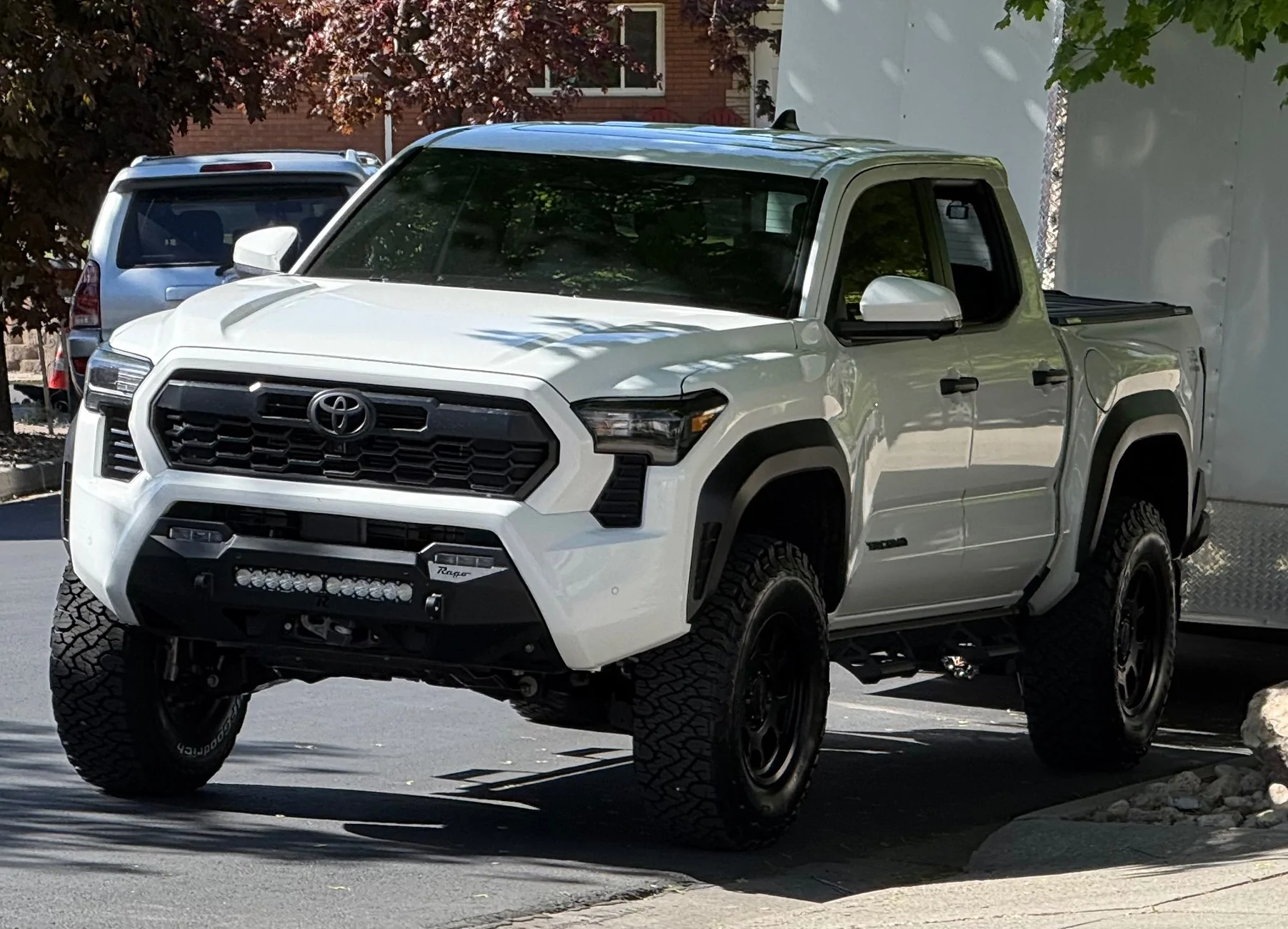

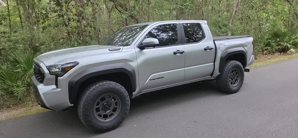

I went to my local shop requesting the Bilstien 61xx series but also wanted to customize for winch and from bumper and weight in bed. They recommended the OME so we ordered.
Just had OME BP51 installed last Friday
Super happy with the ride
also had method 705 wheels +35 offset
BFG KO3s 285/75-17 load range E for rock crawling
still have original wheels with 265/70-17 BFG KO3 in load range C….. but haven’t swapped back to smaller set just yet
2024 Tacoma Lift Advice (Considering OME BP-51's) IMG_4890
2024 Tacoma Lift Advice (Considering OME BP-51's) IMG_4861

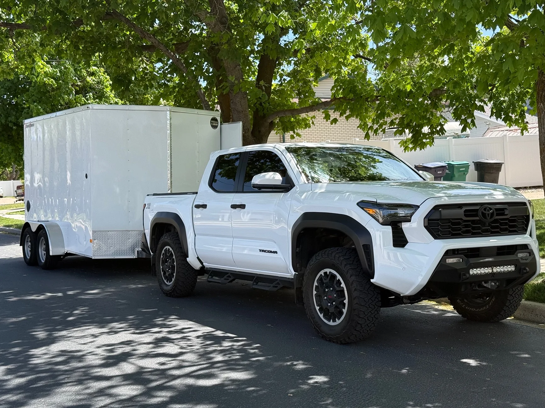

Looks great - what setting in the front, max height?
What rear springs? Do you have the trailer connected in the top pic?
Gearman
Kris
Jul 5, 2024
46
43
Utah
2019 F350 Platnum, 2025 Tacoma OffRoad Premium

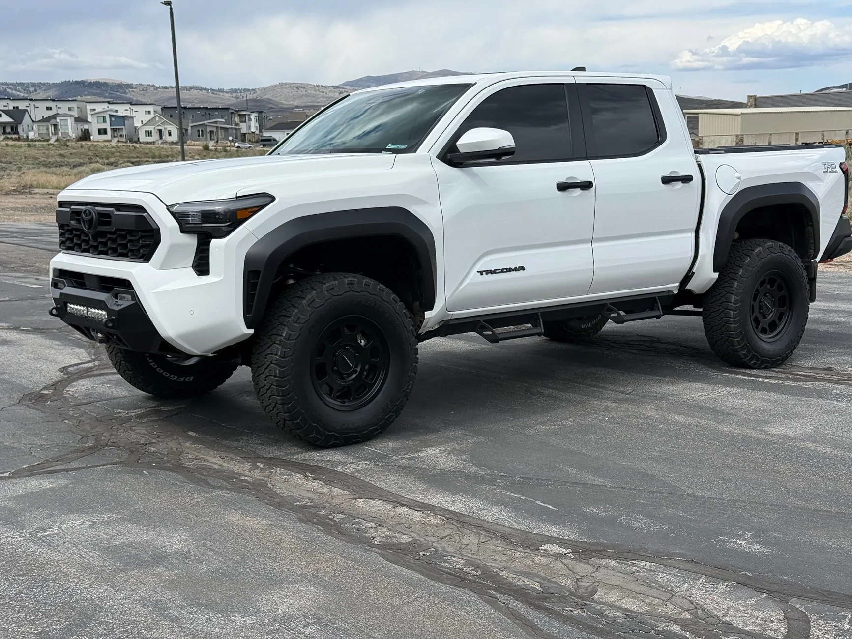

no idea what setting for the front, shop said they could turn it up still (which I will do as I don’t like the amount of rake when unloaded)
they said the put OME med duty spring in rear for load I requested (500lbs)
yes above before and after photos are with mowing trailer connected.
here is one with out trailer
2024 Tacoma Lift Advice (Considering OME BP-51's) IMG_4918
