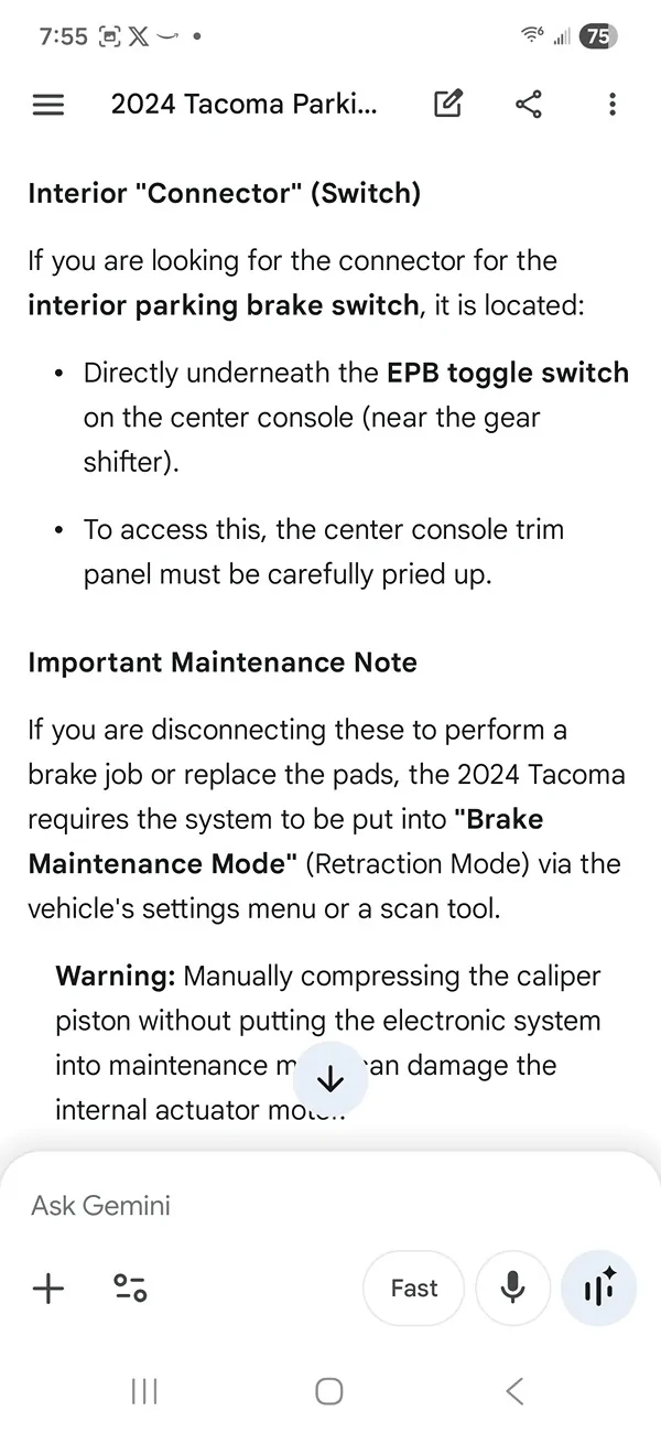

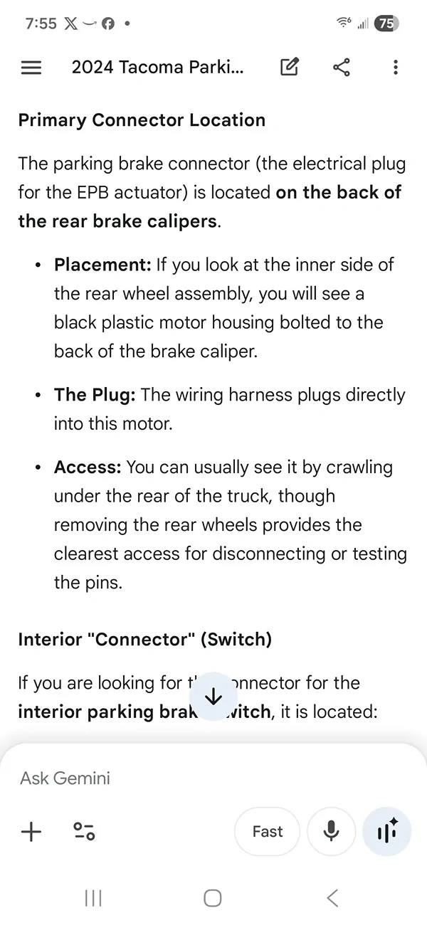

Hope this helps you figure it out.
2024 Tacoma Parking Brake connector location Screenshot_20260419_075501_Googl
2024 Tacoma Parking Brake connector location Screenshot_20260419_075513_Googl

Thanks for the info. I will crawl under the truck and see what I can see.
