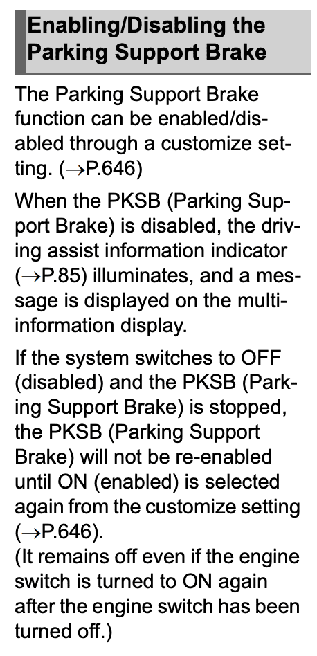

I had the same safety brake discovery yesterday with my hitch mounted bike rack. I could not back out of the driveway. You can disable the PKSB in the settings menu. I don’t think the Tacoma has the same physical button as the Tundra in the video, at least on the TRD Sport model.

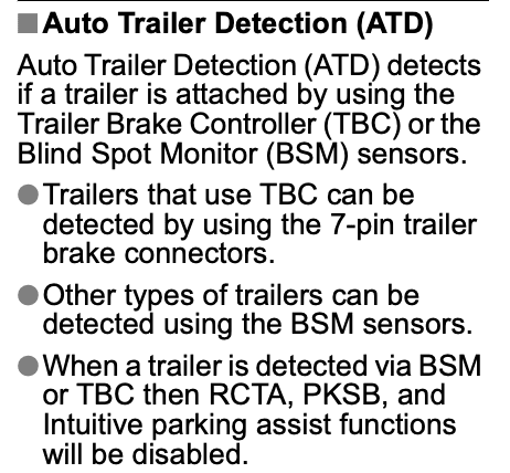

It looks like there are two instances where it will switch off. One is automatic with a trailer, the other is done with the multi-information display aka dash board. Seems like a switch like the tundra would be more convenient. Maybe it can be added in one of the blanks or a fake TBC connector.

Had the exact thing with my hitch mounted bike rack. Used the toggle switch located on the left side of the steering wheel to select Settings (shown on the display), then scroll down to PKSB and deselect it. I think that's what the post above says in a much more thorough way. lol.
