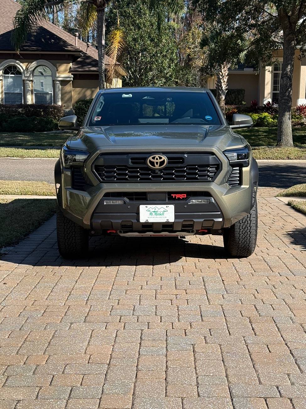

Used the spray can on my front emblem. Four coats and easy to use. Five months old now with multiple car washes, bugs, etc., and still looks like I just sprayed it. Happy so far.

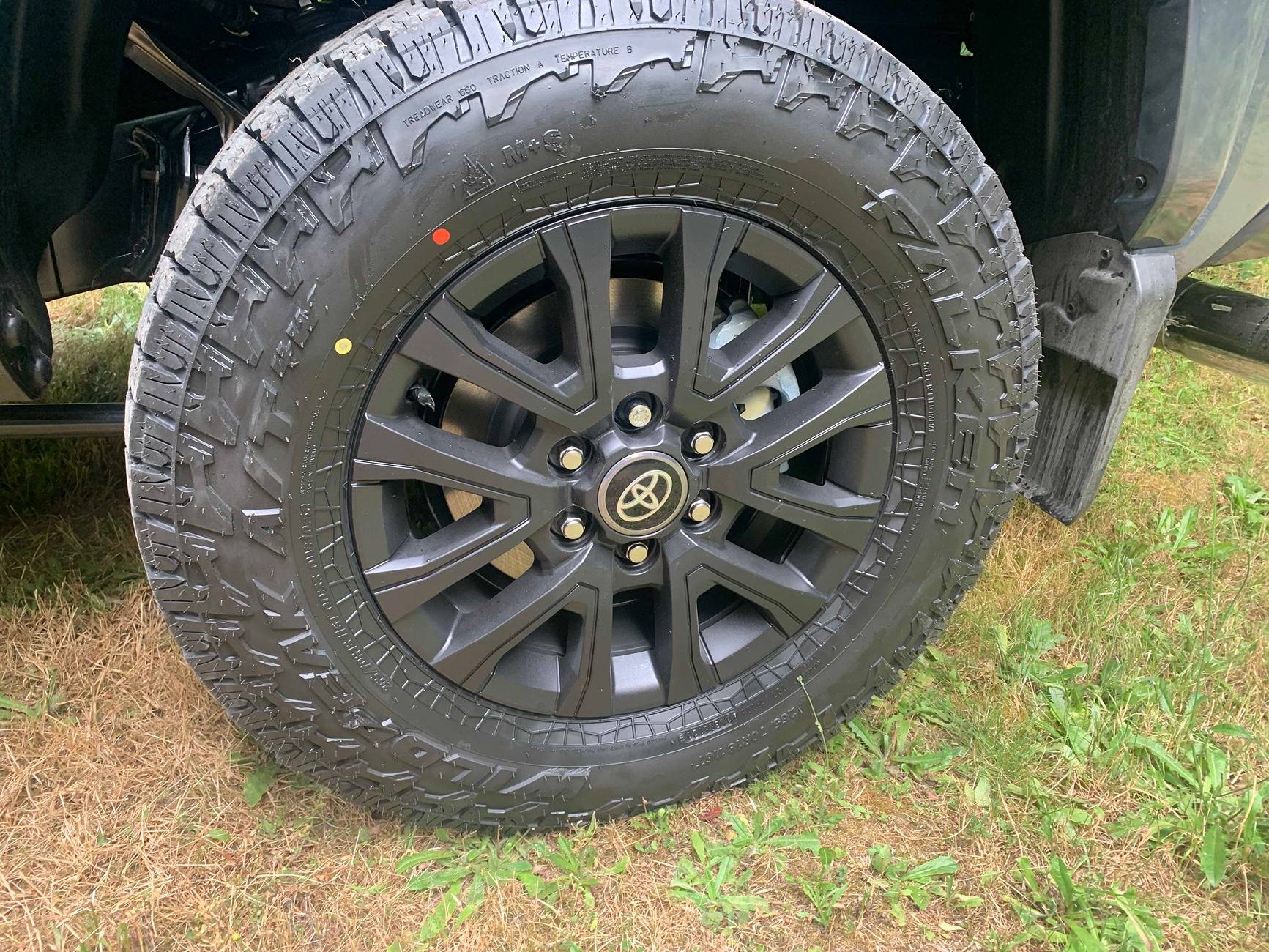

was at my wrap guys place & a ford raptor came in with it's wheels plasti dipped with some age on them . 2 year old truck
Yeah not 4 me . looks like it is a really deep charcoal but not a true black color .
