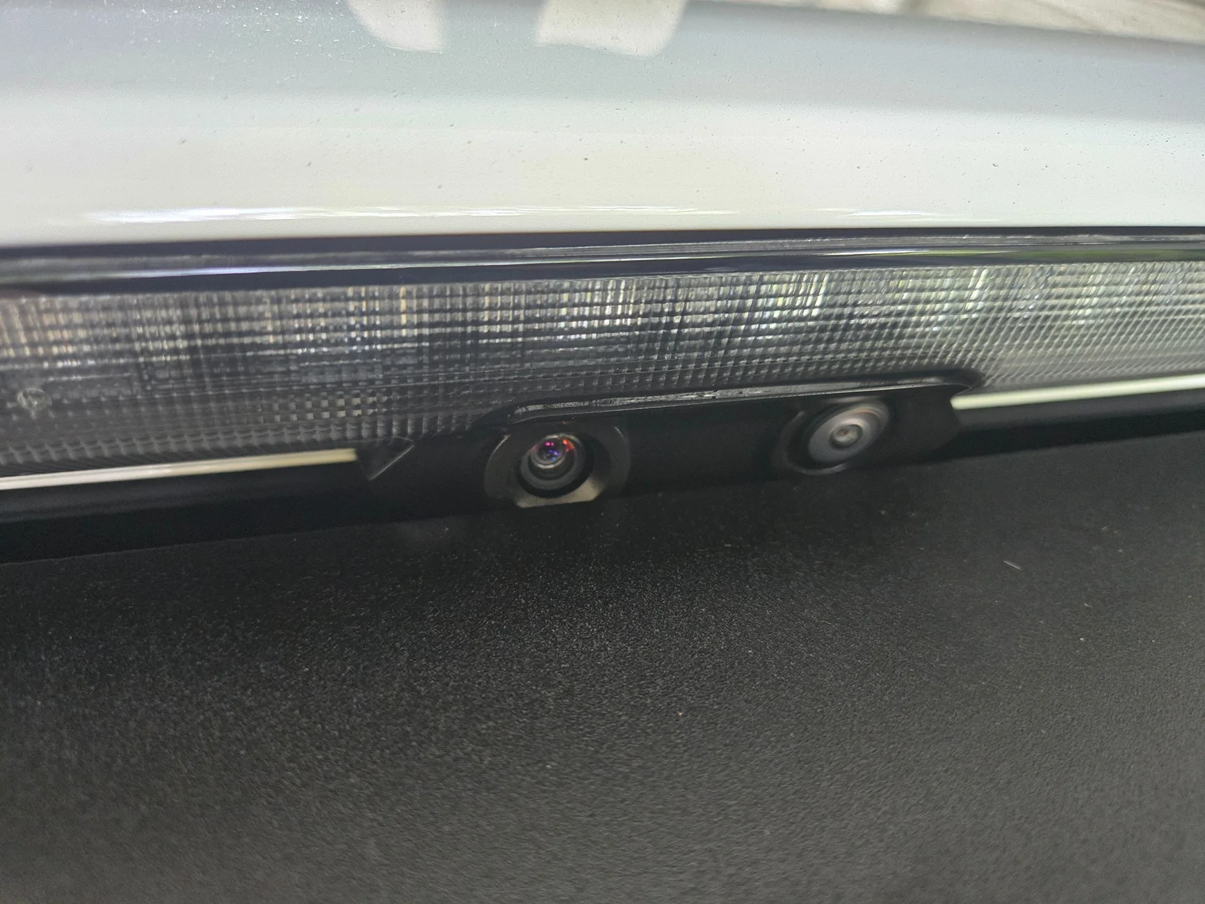

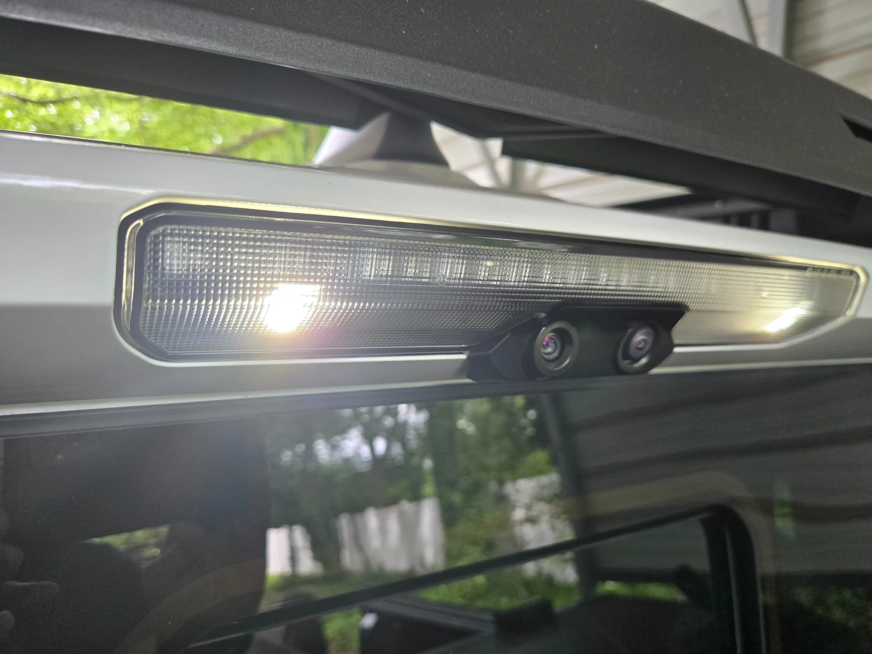

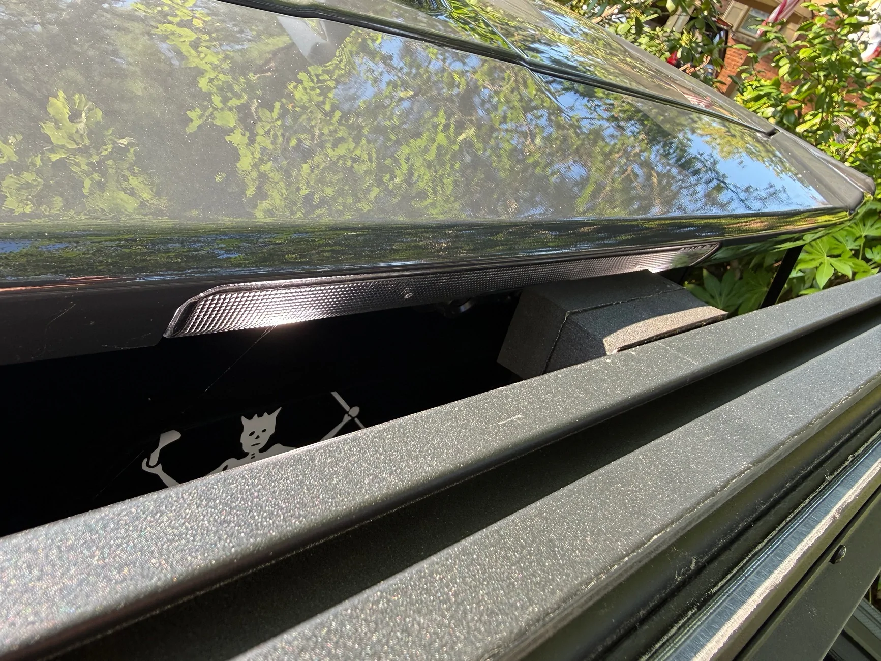

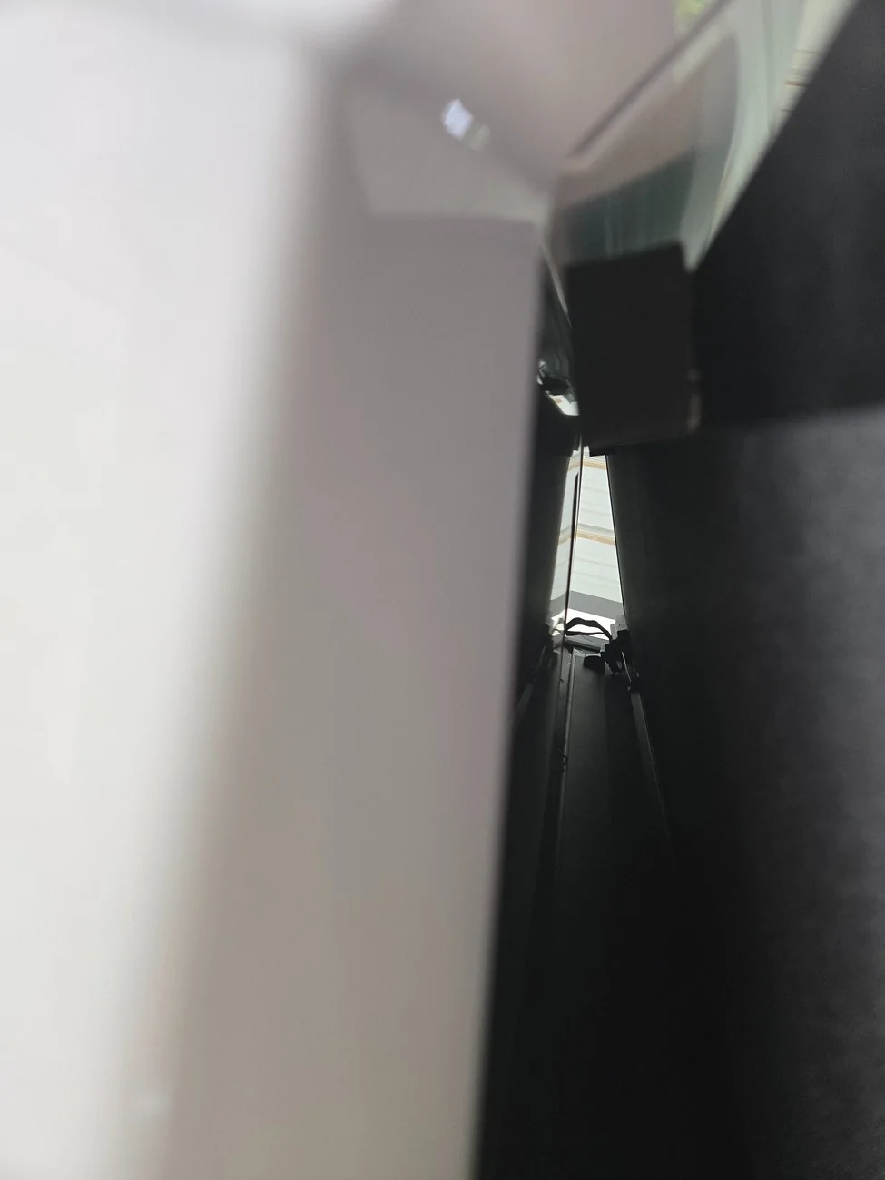

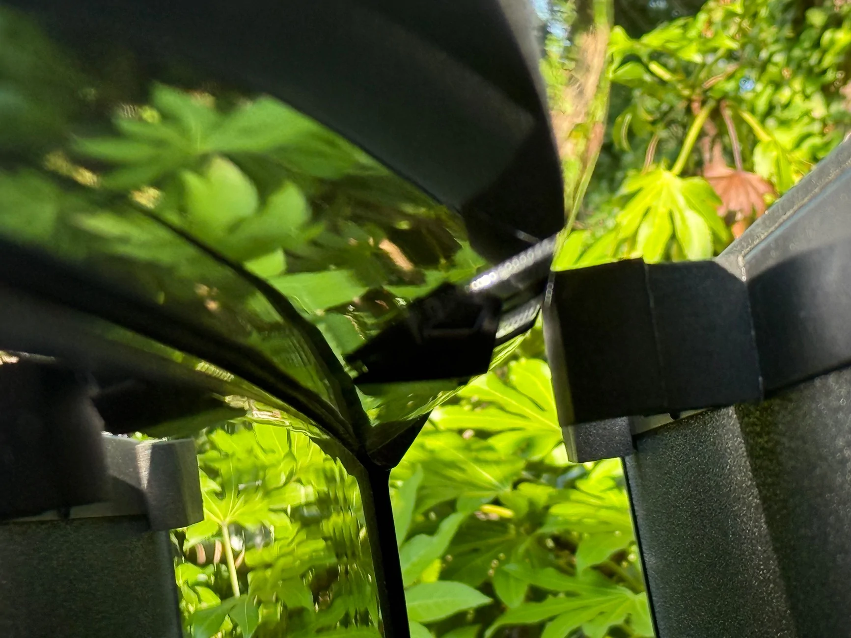

The install went smoothly, everything fits, however, I have a problem. Even if I move the cover so far back the tailgate cannot shut. When folding the cover in the complete upright position, the top of the cover is resting on the cameras in the brakel ight before the foam bumpers they included can touch the glass or body of the truck. This means the entire weight of the cover is being supported by the cameras. I have attempted to take pictures that show this and I will post them here.

I was wondering if anyone with a Trailhunter or another trim that gives you the extra cameras in the center brake light has a bakflip Gen 3 and it it clears the cameras.

The guys that installed mine on my 5’ bed double stacked the foam on the middle. Not sure in your situation if that would help.
If you have the time, could you send a pic of how stacked the foam is in order to touch your glass before it hits the brake light? Do you have the brake light with the two cameras in it?

Yes I have the dual cameras on my taillight
