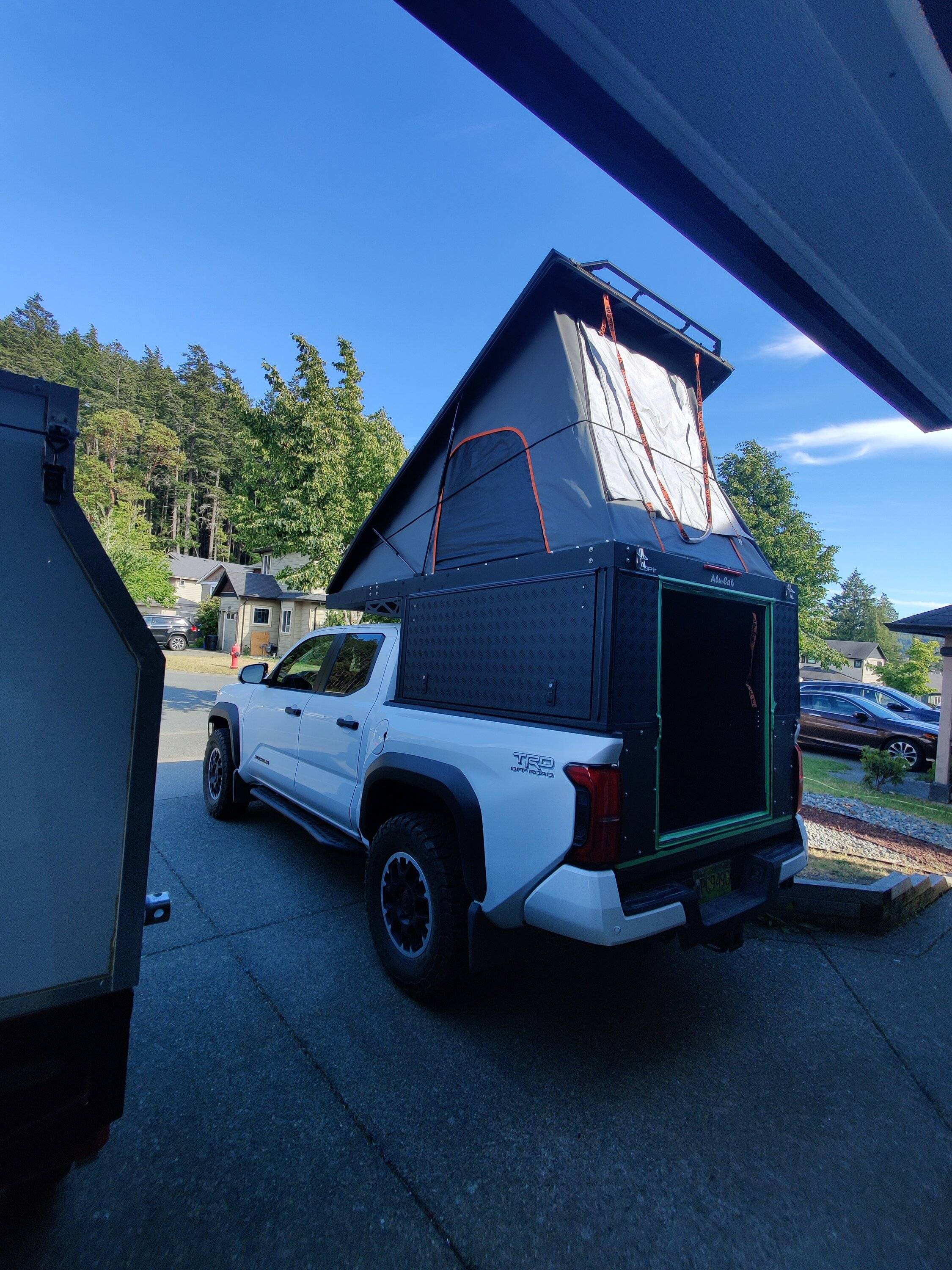

Hey guys,
I picked up an alucab for my 2024 Tacoma off-road premium.
I wired in the 3rd brake light to the left hand side tail light. It operates great when I brake, but when I signal left the rear brake light also flashes. From the looks of it I need to tap a wire before the turn signal signal goes out. Does anyone know a better location to tap into?
I looked at using the trailer wiring but ran into the same issue.
Thanks!
