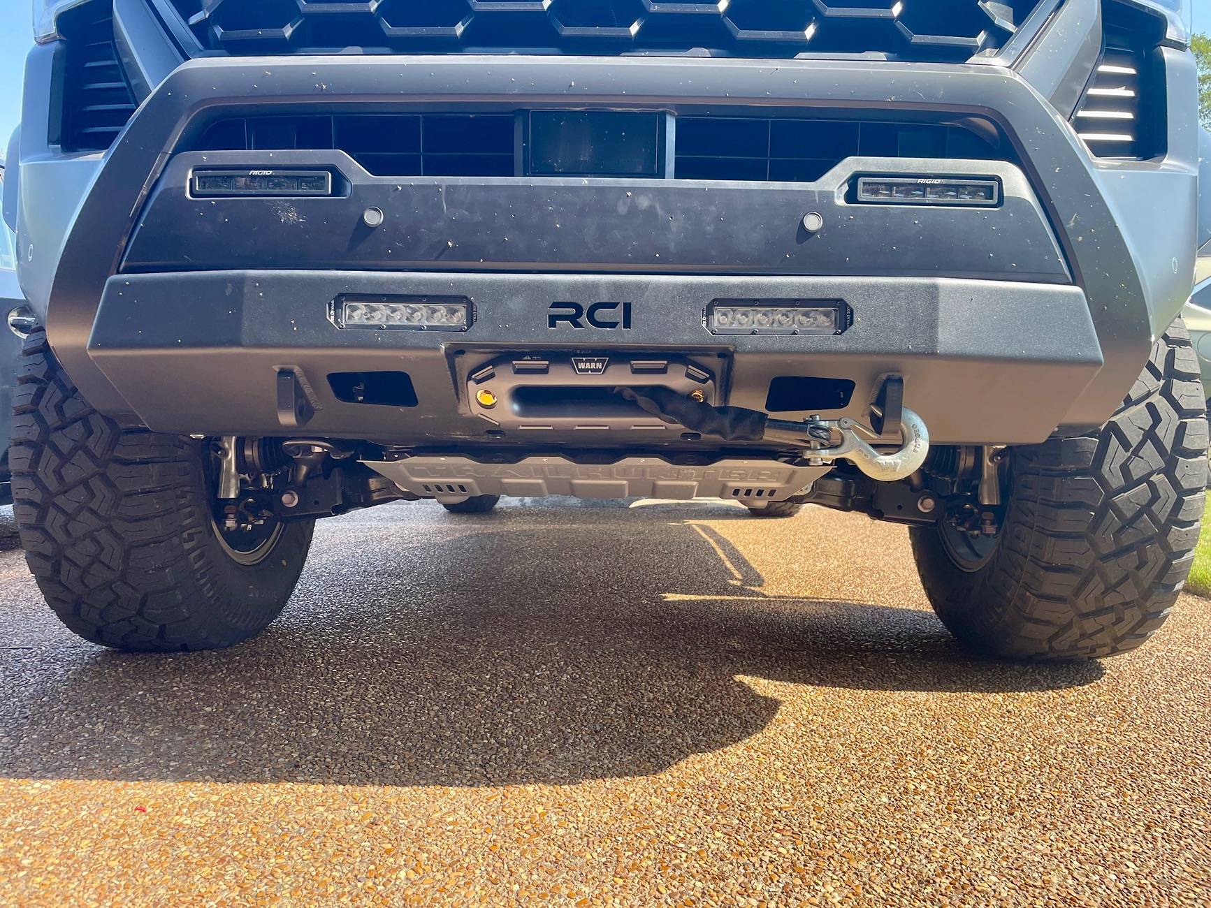

I can attest that the Pike Bumper from RCI will allow the fitment of a Zeon 10.. only had to relocate the hybrid “pedestrian speaker”. The width was not an issue.
That's great to hear. Awesome bumper. When I talked with RCI, they said it wouldn't fit. These companies are selling themselves short advertising otherwise. Their website explicitly says it wouldn't fit.

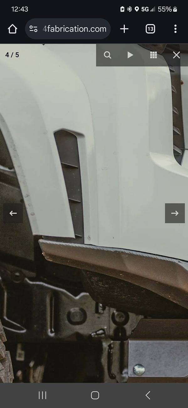

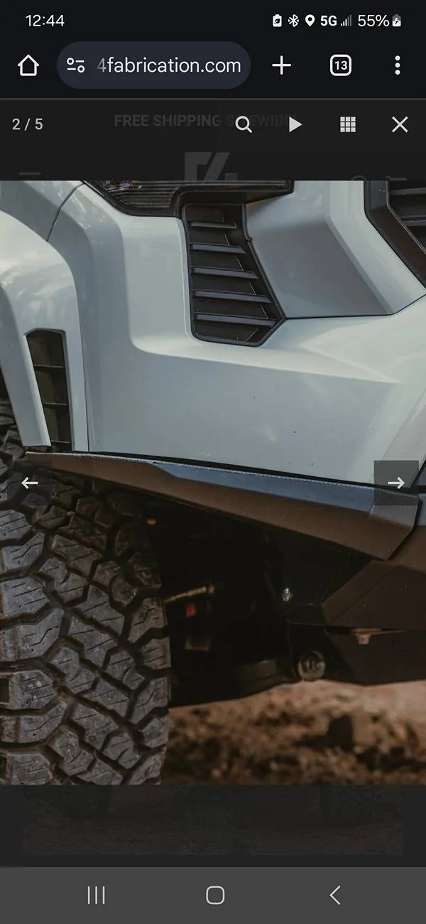

My issue with any of the bumpers that require cutting is clear in the pics from their website. It looks like a hack job to me. The gaps aren't straight or even and it varies. I'm not cutting up 6k in factory parts to be tied to one type of bolt on part. If I was building a straight up ranch vehicle from a new one I still wouldn't consider this. It just seems like a " jeep thing" to accept the engineering from any manufacturer that can't design a bolt on item to fit within the design format of the vehicle. I've bolted bumpers, brush guards, grills, winches, cranes etc to class 6 trucks or 3/4 ton work trucks and ne er gotten out the Sawzall to do so.
Agreed. Although I blame those cuts(as you mentioned) on the installer. They must perform under the the "never measure, cut once" philosophy. They should have measured, then rough cut long and fine sand to perfection.
I'm not going to blame the installer too much, mine would look worse lol. That's why I don't want to cut it.

Cut my own,, albeit it’s not the same bumper as the above pics. The Pike cuts are simple and clean
That looks good! Is that a hybrid truck?
