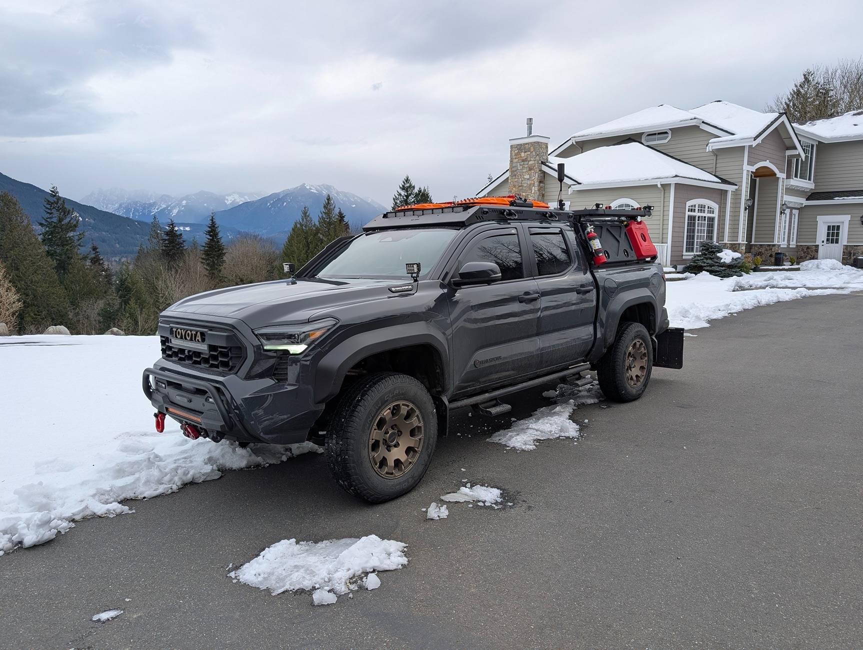

Unfortunately, this one says it is not compatible with factory skid plates. Which means it's a no on the Trailhunter.
Well, I installed it on my Trailhunter with the factory skid plates. It is great! I called ADD about this and am not sure why they take that position. But I assure you that my factory Trailhunter skid plate fit with the Addictive Desert Designs bumper with top hoop.

that’s my favorite of the bumpers - pls give me more details about your experience - I also want to copy your ditch lights and tell me about the bed rails and roof rack too please - your truck is as overlandy as I aspire to — also do you think KC style lights could be attached to the bull bar?? And what is the total added weight if you know

My truck is built for Search and Rescue. Warn winch in Addictive Desert Designs bumper. Leitner Designs ACS Forged rack with boxes, etc. In bed is a Decked drawer with CargoGlide on top. Lights on ACS rack are KC Hilites (3 pair of scene lights for dog and ground search team escort). Custom first responder light bar systems front (white and amber response) and rear (amber response only). Rigid backup lights. Uptop Kilo cab rack with scene pods (white/amber). Amber light bar in bumper. Ditch lights are Cali Raised and I love em. So I have a couple pages of mods (radios, GPS, etc. etc.) But you get the idea.

Weight added with equipment, gear... about 220 in front, about 700 in rear. So I also upgradd to Dobinson's springs to offset the weight. Running Snowclaws on OEM 18 in wheels now but will change to Falken AT4Ws on 17 in Method 703 wheels in spring.

Falkens are a great choice. I run those. Look at SCS wheels as well, they are hub centric and weigh only 22lb. Are you going with 285/70/17?

Sure am. SCS has some nice-looking wheels. Method Bead Grips, although heavier, were chosen for my build to keep the rubber on the rim... hopefully.
