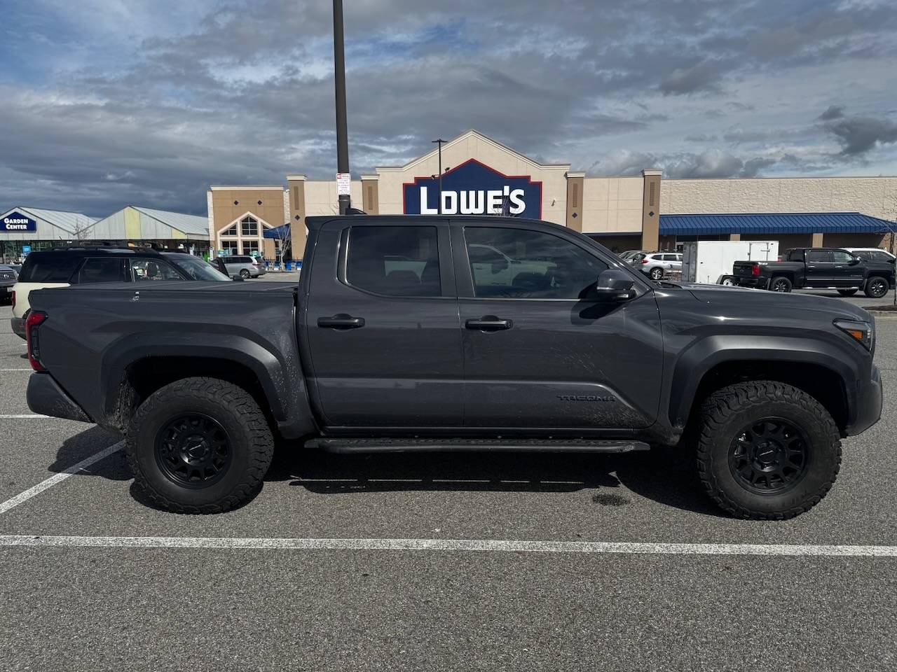

With nothing in the bed and not towing, the rake is nearly gone, as you can see from the picture of the truck in front of Lowes.

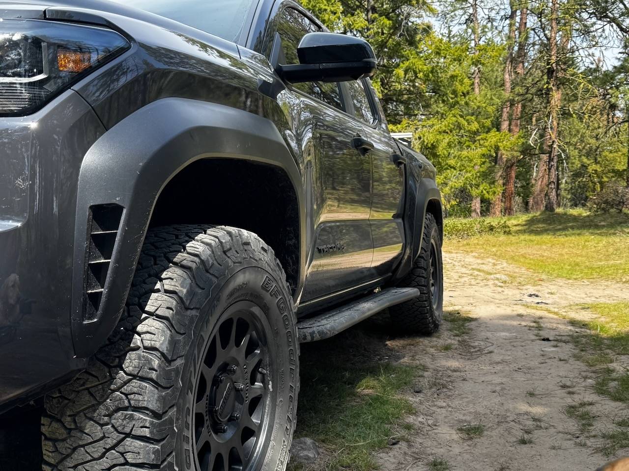

However, when I am camping with a loaded bed and towing my teardrop trailer, the rear is sagging a bit (close-up picture, although slightly exaggerated as the truck is not level). I can feel the rear hitting the bump stops often in this scenario.
So I am considering doing the All Dogs Rear Lift Coil Springs ($230). Then I got to reading about the Sumo Springs (500lb capacity at $415 and 1,000lb capacity at $445) and also the classic Timbren bump stops.
The question is: pros/cons of new springs vs. bump stops? It seems like it's one or the other...I shouldn't need both, correct?

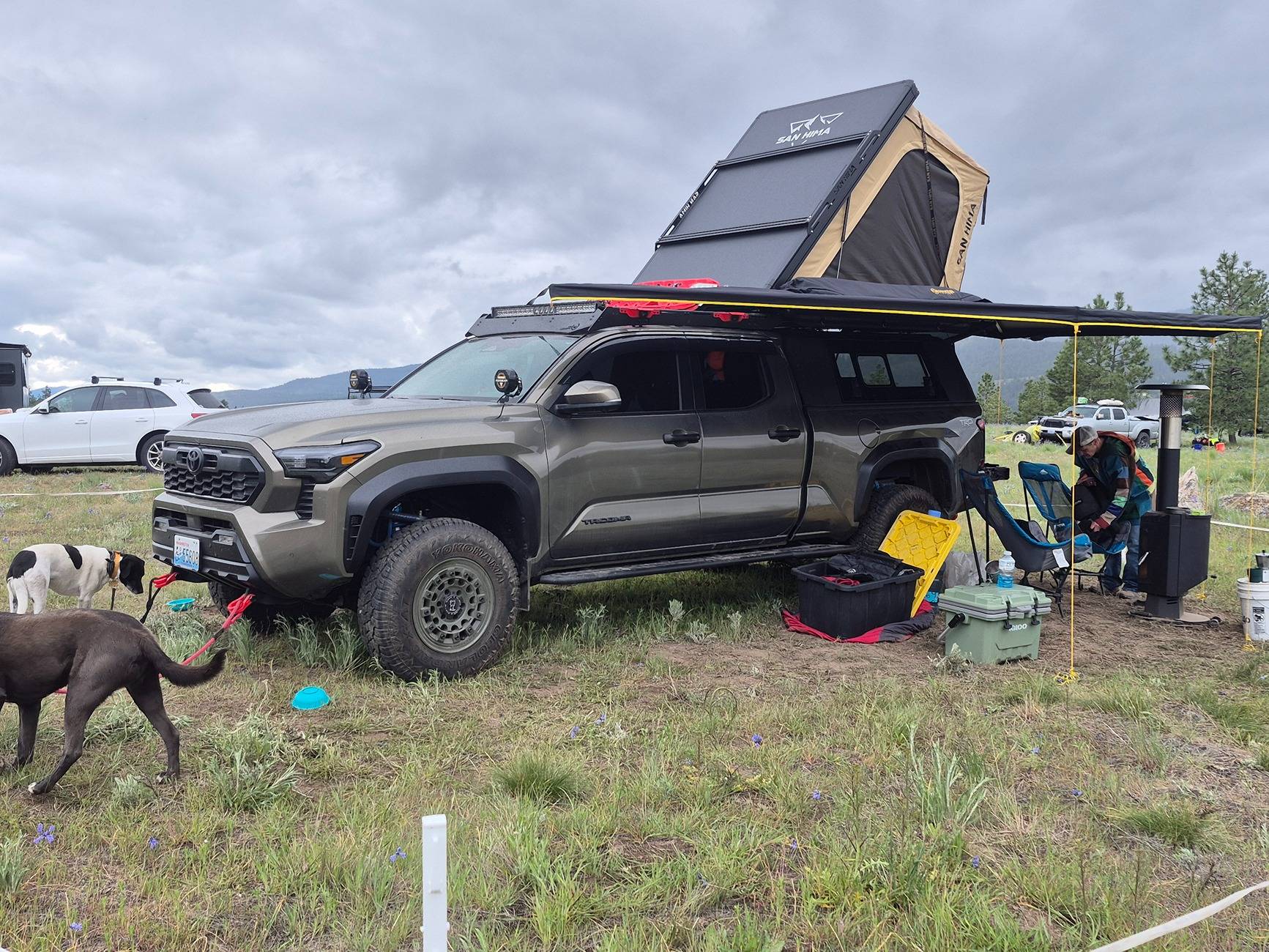

2 1/2 " king coil over suspension lift kit with new end links and dobson 819 rear springs 1000 lb over. The Dobson Springs are around $300 a pair at R4T and they have a varying weight.
Beyond happy with my setup..
