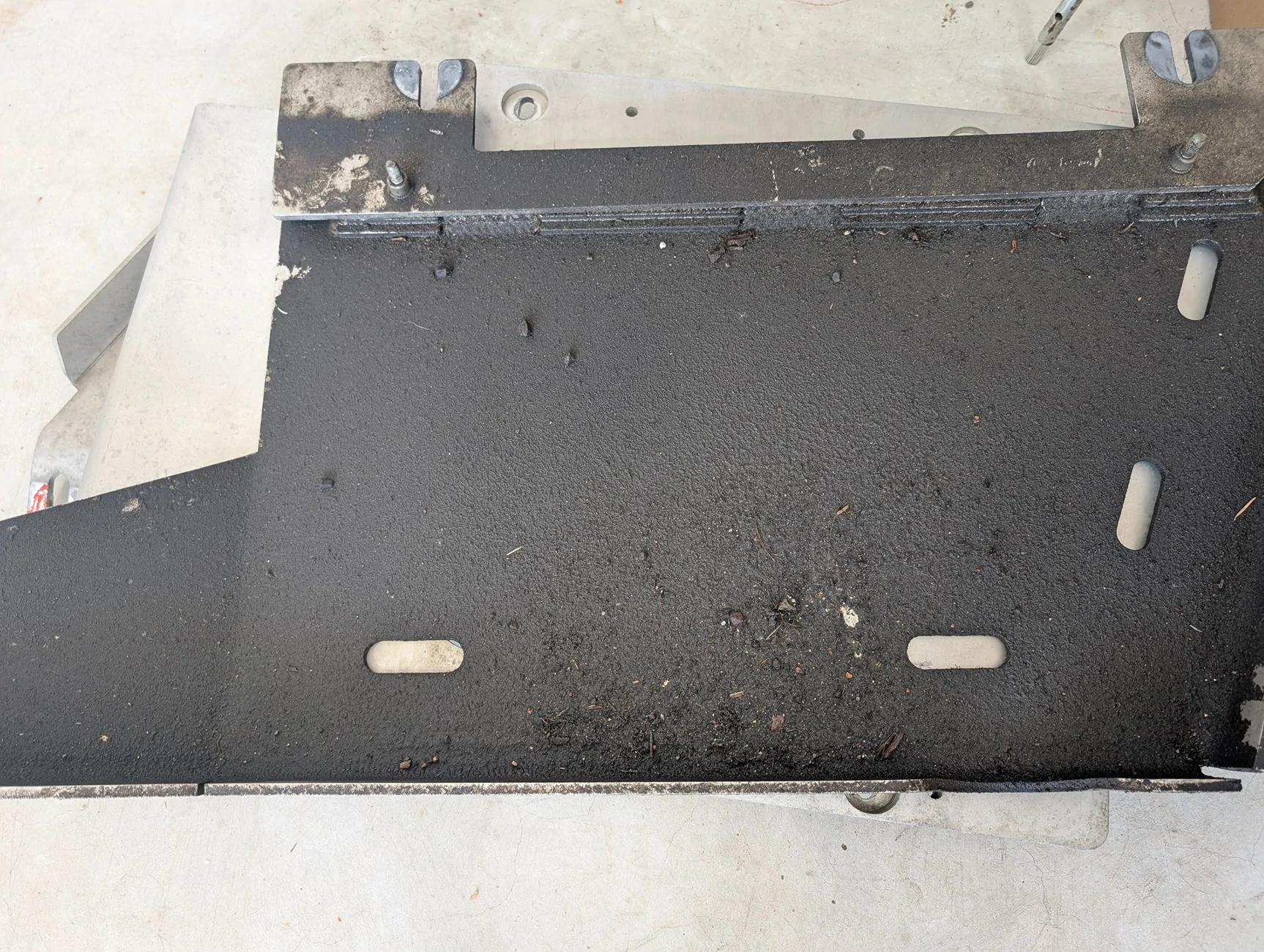

This post is about what I found whilst doing the work on the suspension. I've had a full set of skid plates on the truck for at least the past 25,000 miles. I removed them just to make sure I could get at the full underside of the truck.
I was surprised that one skid plate looked like this....

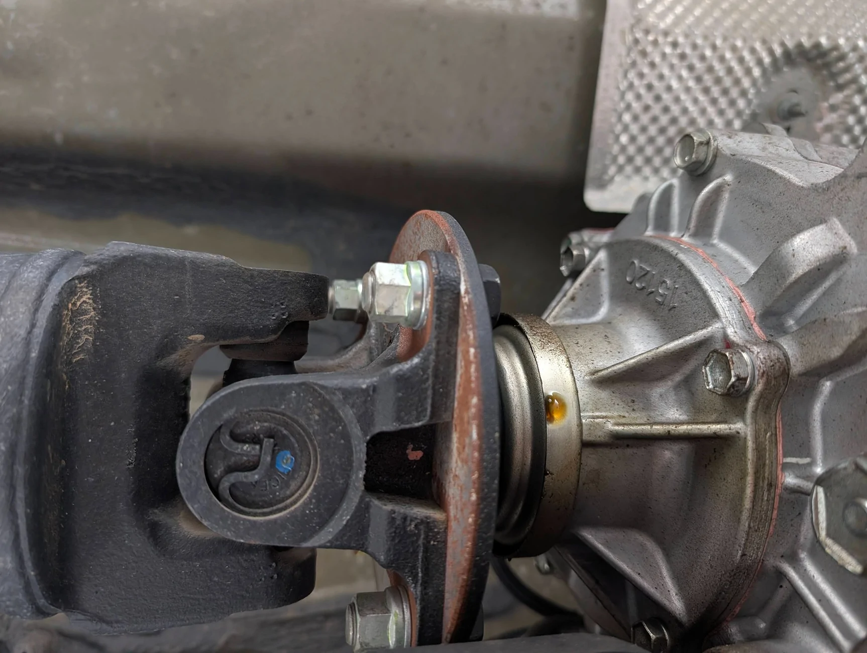

It didn't take much to figure out where the oil was coming from...

So, I visited the dealer today (Rodland Toyota in Everett, WA). I have almost 36k on the truck and this is the first time it's seen the inside of the dealer's service bay. A couple of notes...

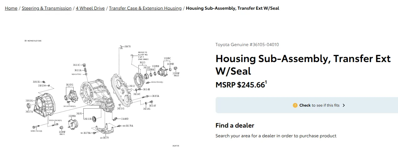

Oddly, they can't just replace the rear seal. Apparently Toyota doesn't even stock it. The solution is to replace the whole transfer case carrier assembly. Seems like total overkill to me but the service rep told me Toyota has embraced this "assembly" method of replacing parts. They don't bother with individual parts, they just replace the whole thing. Unbelievably, the part is only $245 but from the diagram I can't tell exactly what all it includes.
