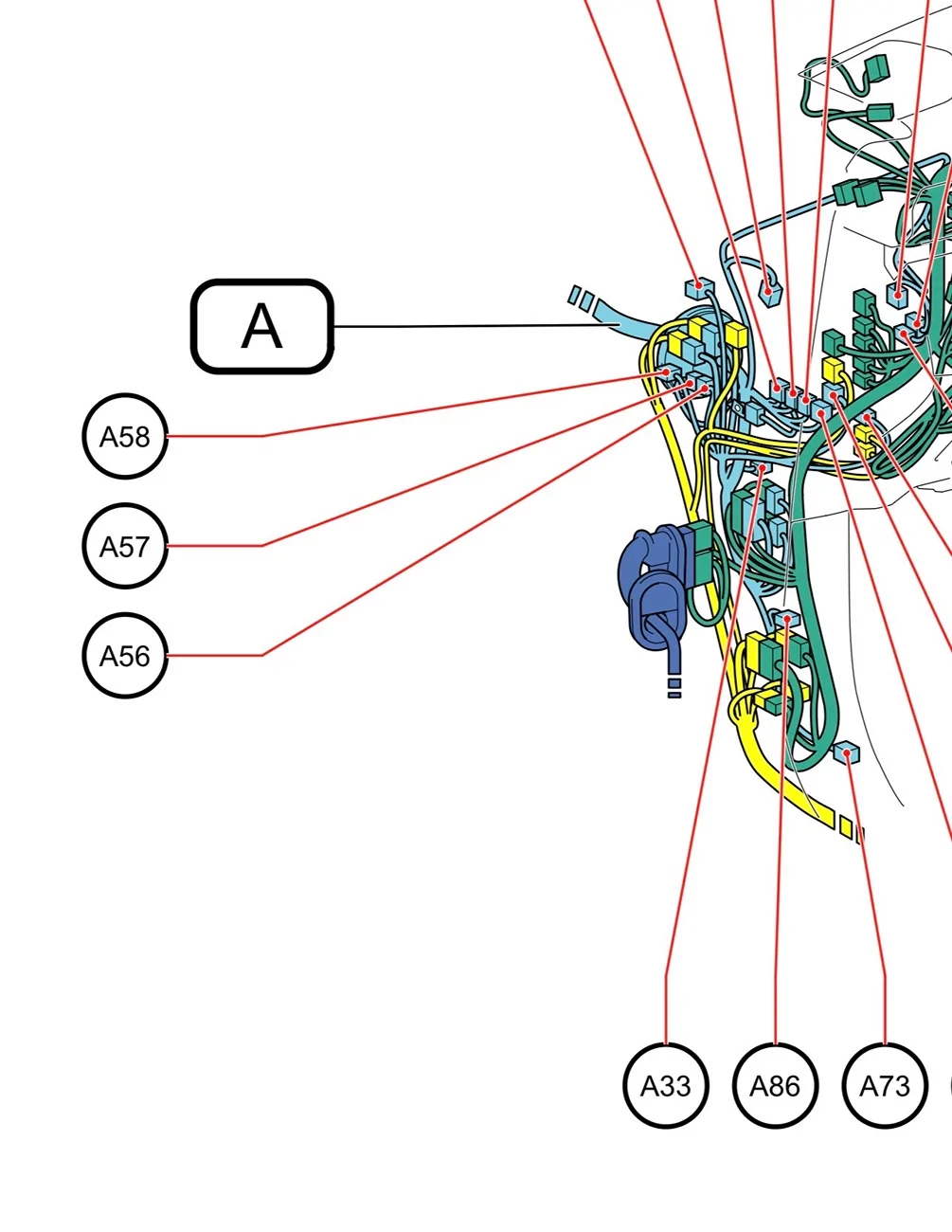

Yeah, I really don’t pay attention to the rev hang during normal driving so it’s hard to say if mine was acting up after the test or not. It definitely doesn’t just hang there for super long amounts of time like yours seems to be doing, so maybe the bypass will work for you.
These diagrams are not very easy to read. It seems like your first place to look is around the firewall A56/57 junction connector as it appears both the blue and red wires going to the safety switch run through there. I’d assume that’s where the connection got broken. But if so, I’d think other stuff runs through that connector as well and that you have other problems too. Maybe not though.
A33 is the safety switch connector and A56/57 are a junction where wiring runs in and back out.
