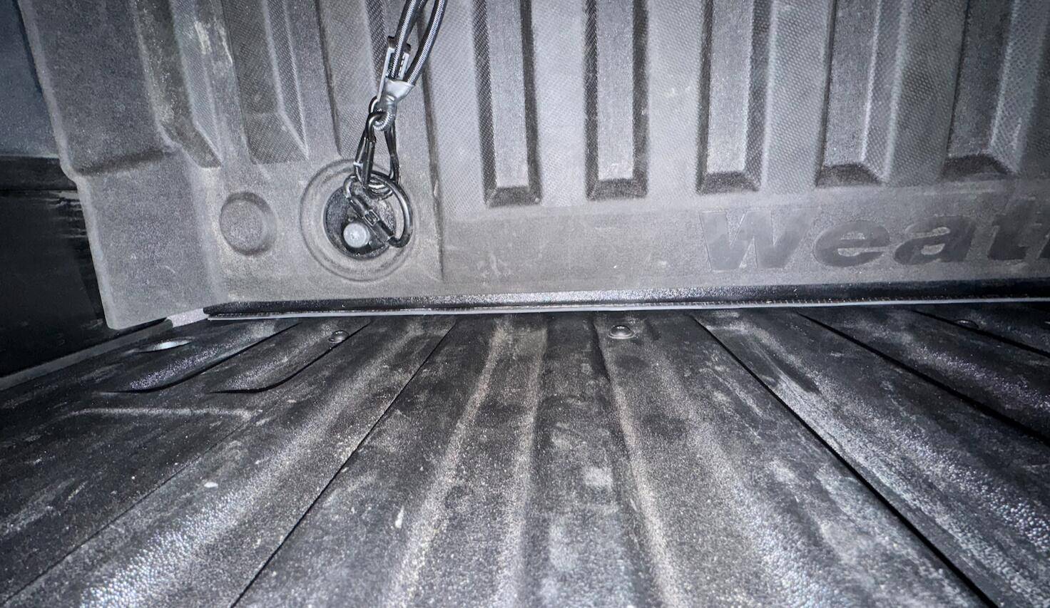

Yes, I was getting both water and tons of dust.

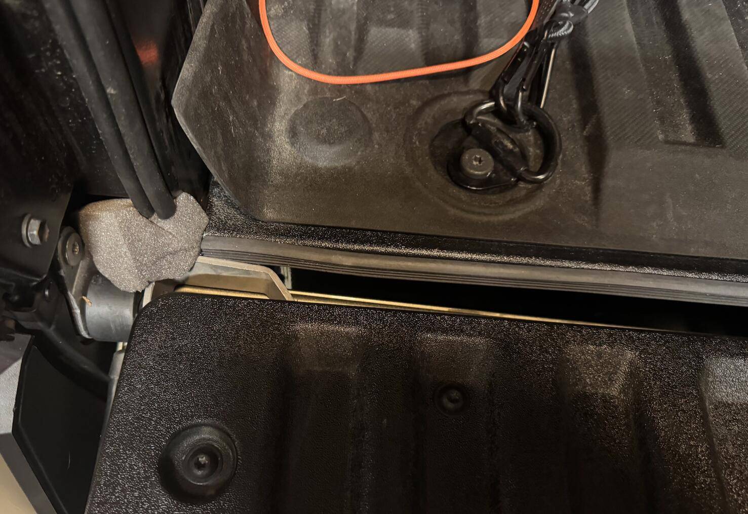

Part A - After some driving on some washboard dirt roads in Eastern Washington where there is still a fair amount of Mt Saint Helens volcanic ash, the back part of my bed was full of dust and it got all over my stuff. Also, the Retrax mounting blocks (part V) and ¼-28 bolts (part Y) stripped out. If found one of the mounting blocks loose in the bed, that is how I discovered this. I retapped the mounting block with a ¼-28 tap and replaced the ¼-28 bolt, nut, and washer with a stainless ones. That worked, I now can ensure that it is snug. I do have a warranty claim in with Realtruck for replacing those parts.

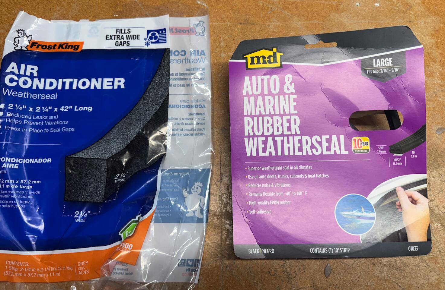

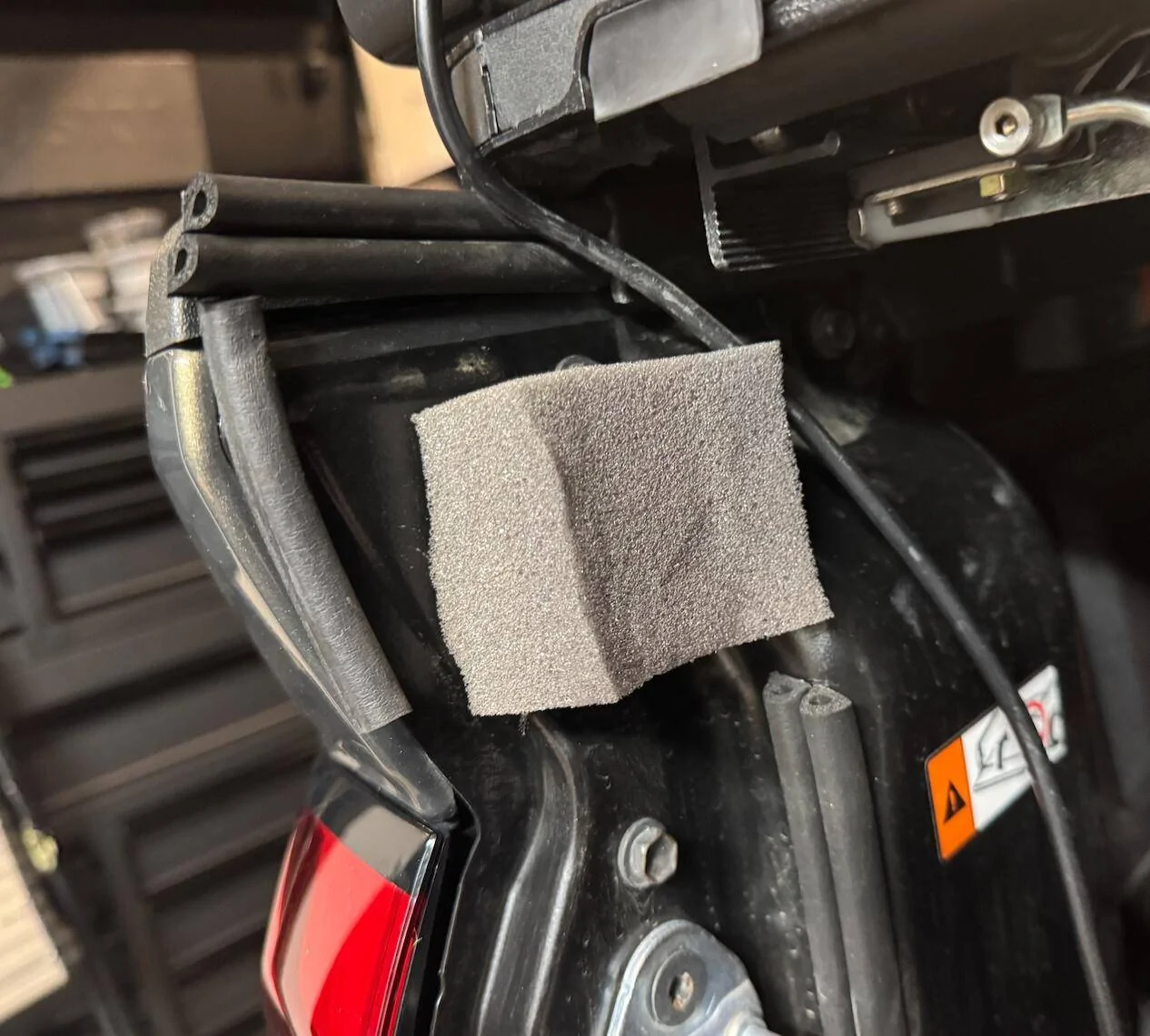

Part B – I put in some MD Auto and Marine Rubber Weaththerseal + Frost King Air Conditioner Weatherseal. I used two sided tape on the top with the Frost King. I just wedged it in the lower corner. I had some of the MD Small, I have replaced some of that with the large which I would recommend. I am pretty sure a lot of the water and dust was coming in around the lower corners of the tailgate.
After another trip to Eastern Washington last weekend, no dust! After washing the truck, minimal water. Not sure it will be possible to keep all water out. I am going to test it in the rain tomorrow.
