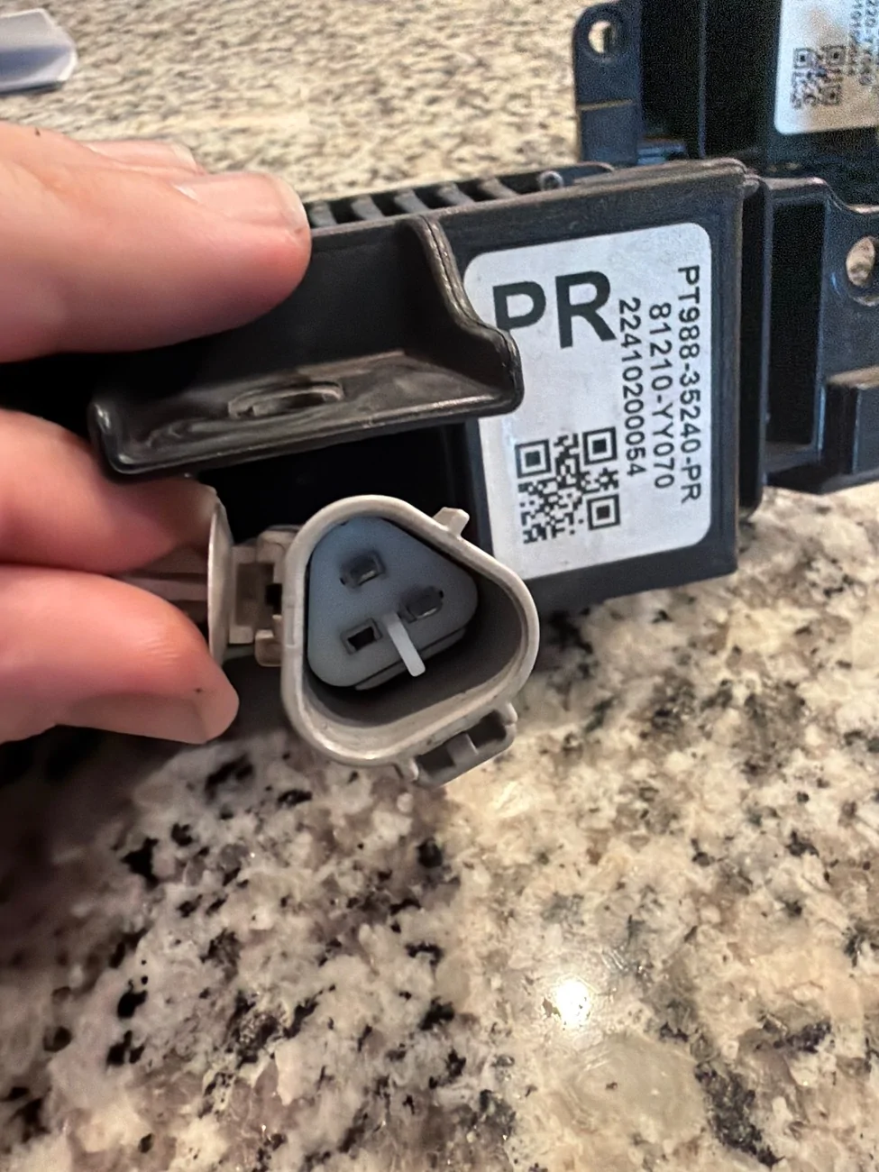

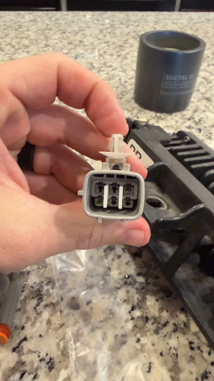

They are not Dt or h11 connectors on the factory rigid fogs, you could most likely de-pin the connectors that come on the rigid lights and add your own h11 connectors. I’m currently doing the opposite as I have replaced my rigid lights and I’m trying to get diode lights to plug and play.
