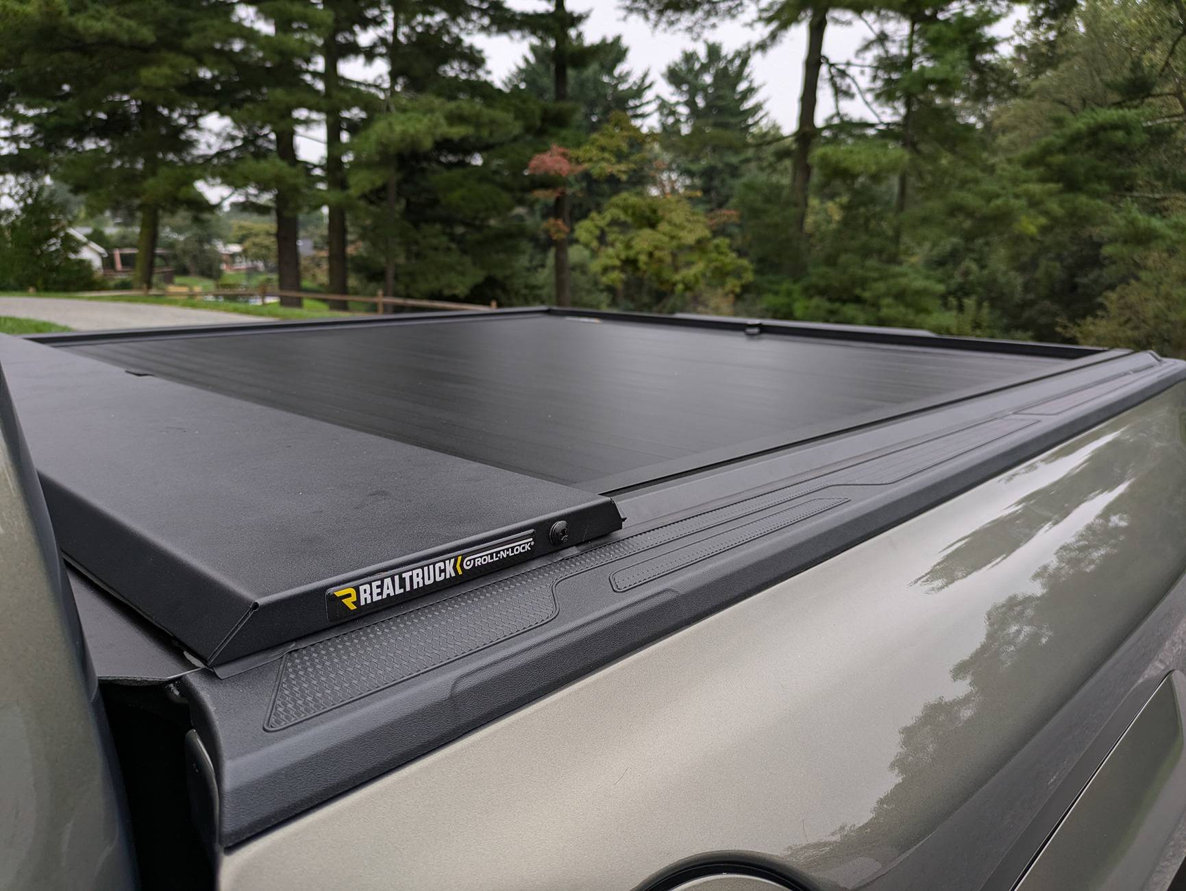

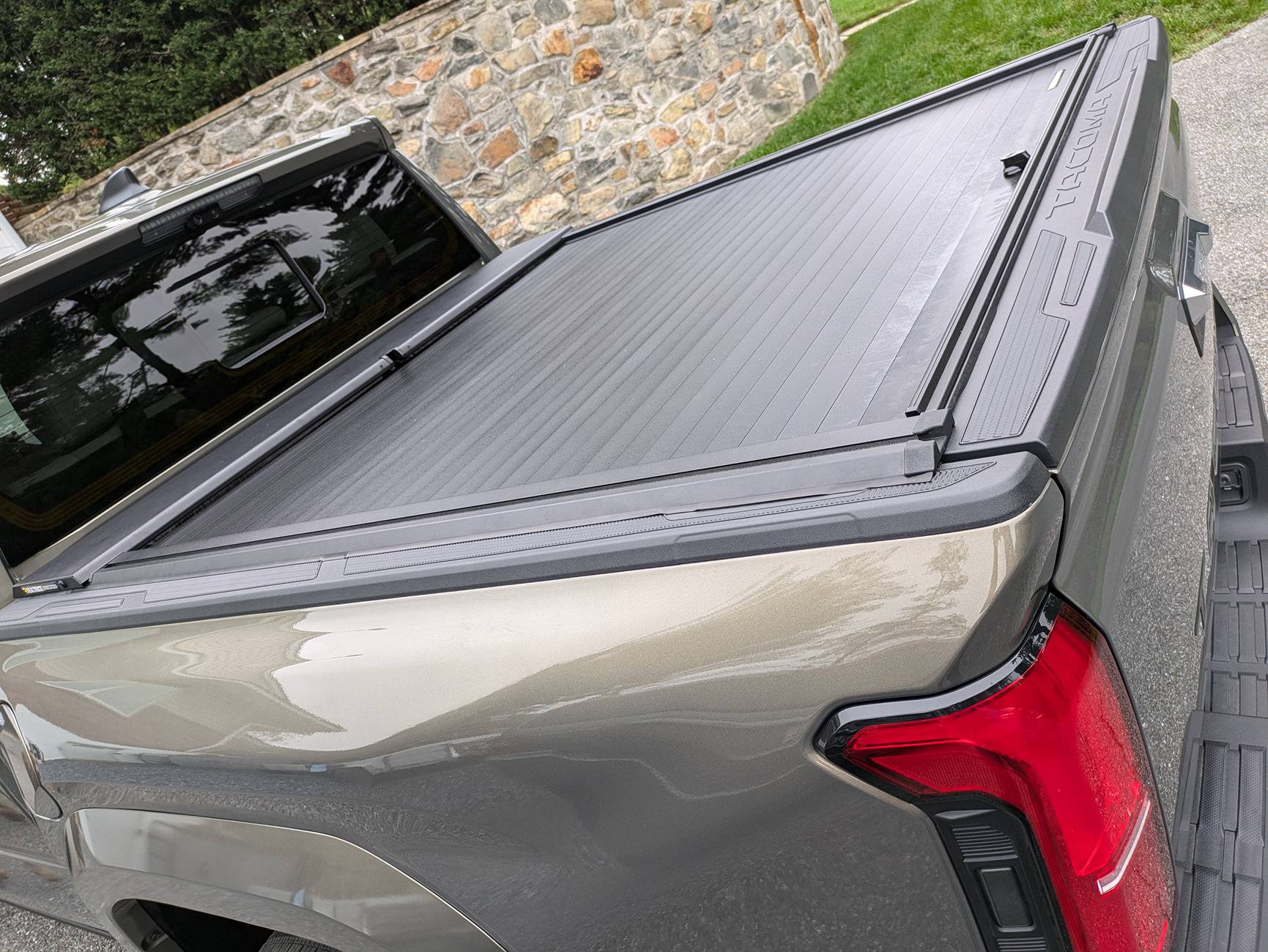

Installed today. Short bed.

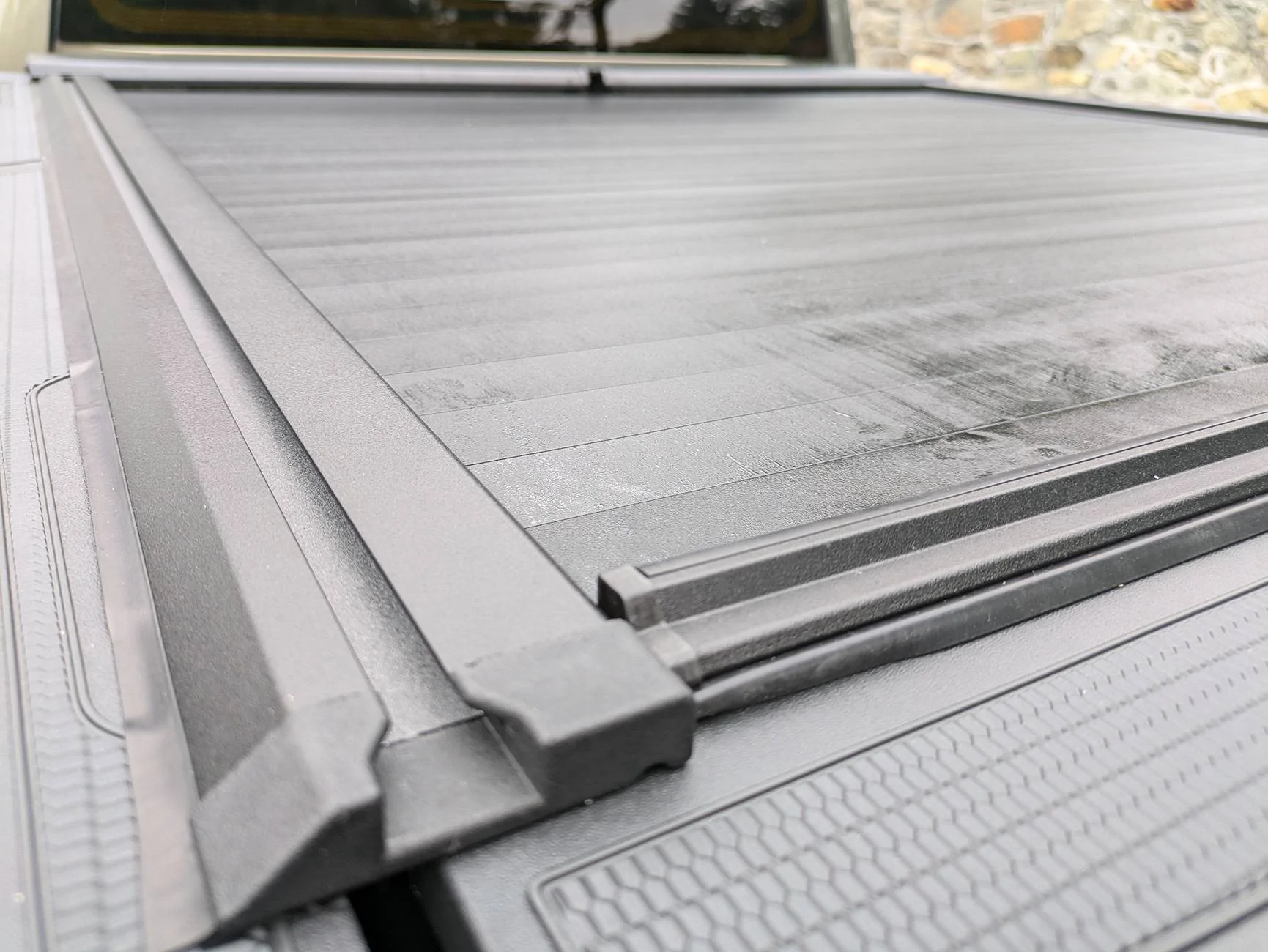

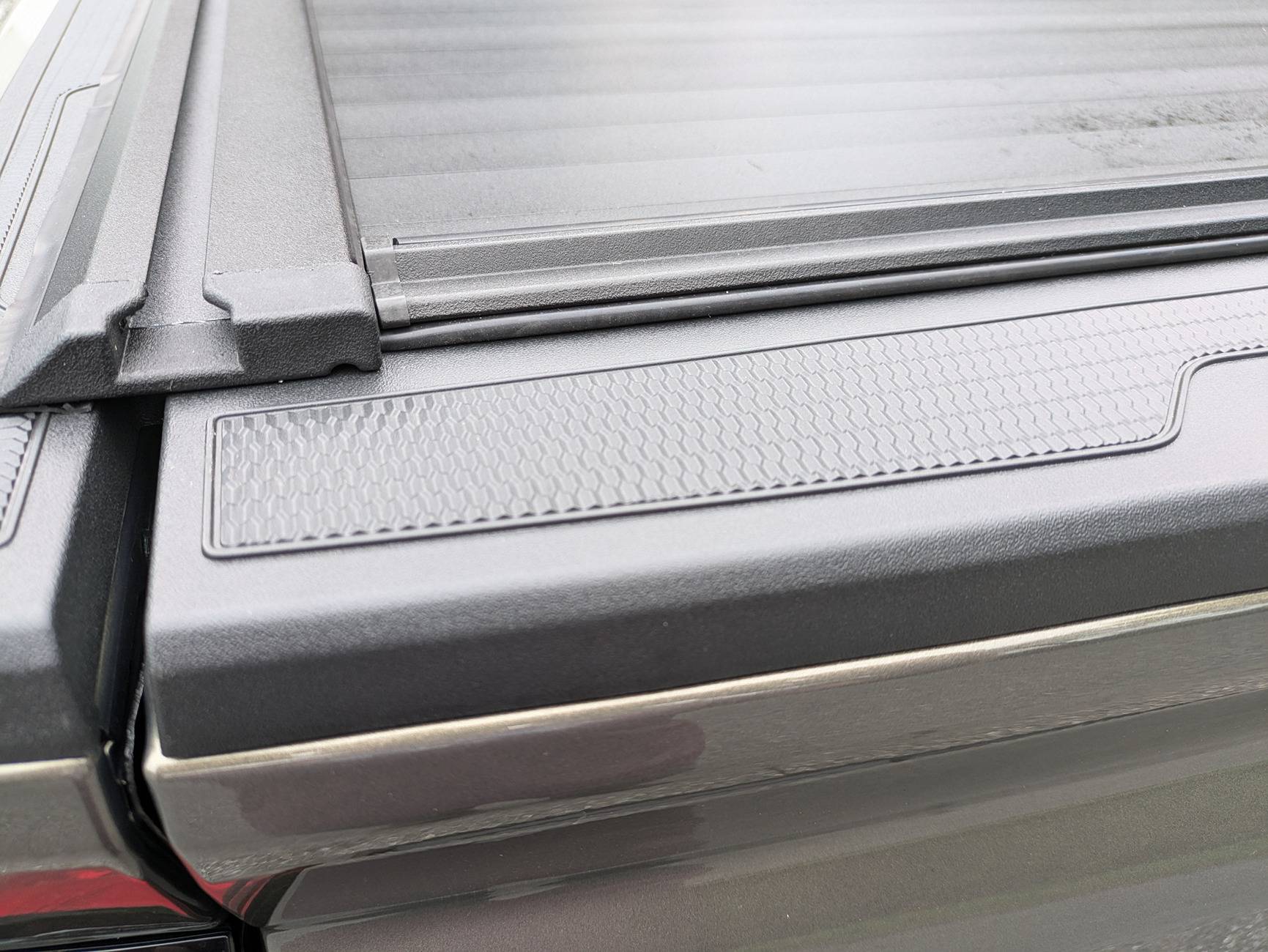

Super low profile and smallest cab box on the market. Leading lip and lock fully retract minimizing lost space. Install took some extra time because I figured out that I could work it around the OEM rail attachments to maintain extra attachment points.
Ran out of time to do the cargo divider that pairs with it. Will have to be another day.

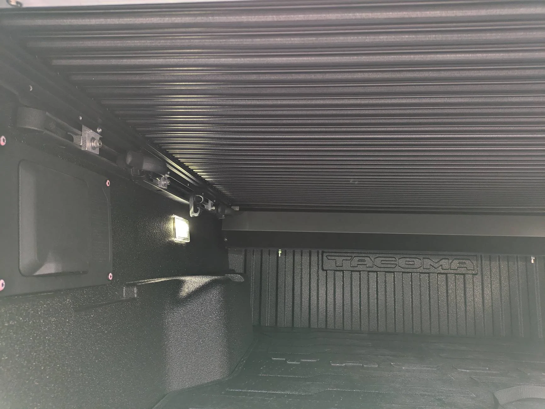

Setup is intelligent in that when the cover fully opens, it flips the lock enough that the mid position stops automatically engage as you pull it shut.
Zero issues with the power tailgate.
note for others that pick this cover series, gap in printed instructions fails to remind you to remove protection wrap from cab side bar before applying butyl tape.

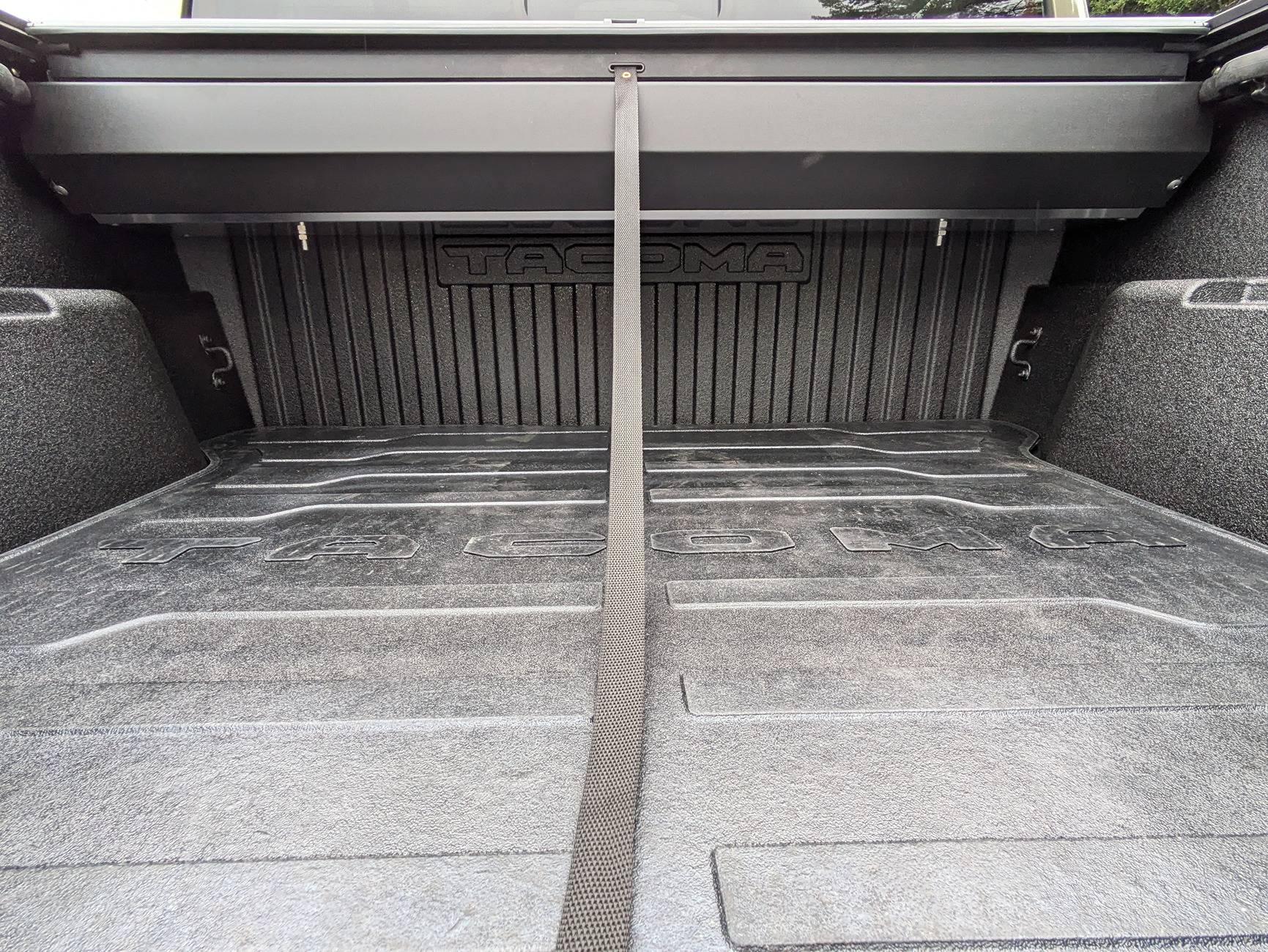

update: when I went to install the cargo divider it became clear that I would loose full function of the OEM rails if installing. I opted to not install it and so it sits unused in its box. ah well.
second note: yes, the bed contains the OEM bed mat. No clue why Toyota claims "not compatible" with spray-in liner... absolutely zero issues or conflicts - drops right in. So when I want slightly sliding/sticking, spray-in only. When I want no movement at all, bed mat goes in.
