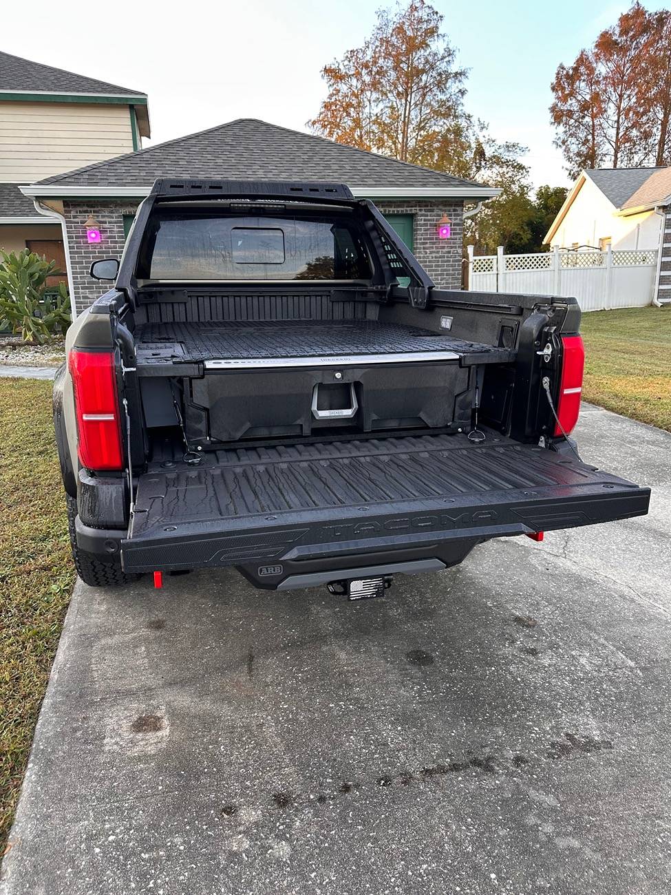

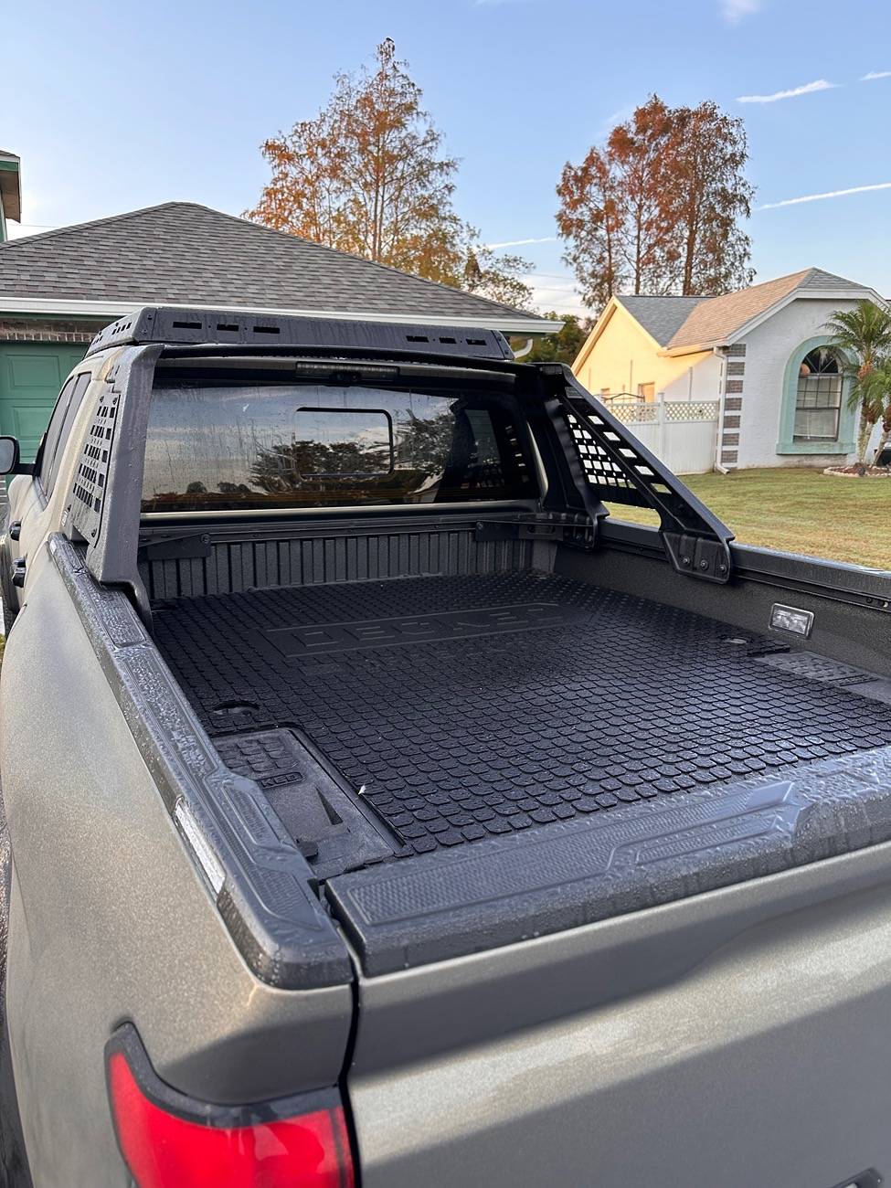

Granted, it’s not a Tonneau cover, but I went with the Decked drawer system. It does help with wind resistance and has a lot of secure storage space. I like the sport/chase rack & the Decked system seemed like the best option.
2024 Tacoma Best HD retractable tonneau that a rack can be mounted on to? IMG_4210
2024 Tacoma Best HD retractable tonneau that a rack can be mounted on to? IMG_4211

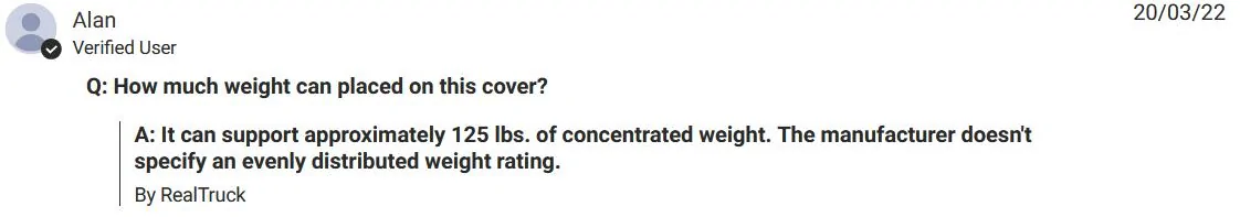

They list 125lbs for the cover area itself for setting things on top of it
