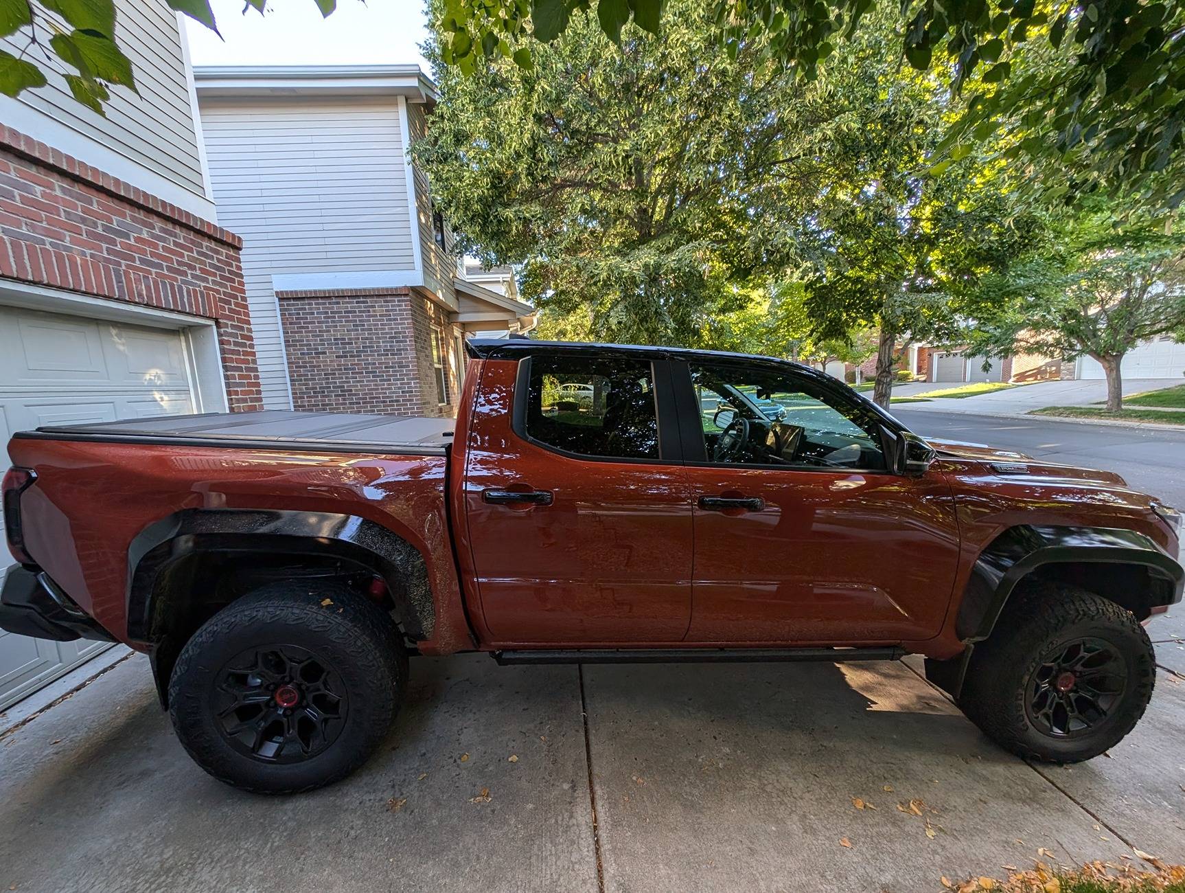

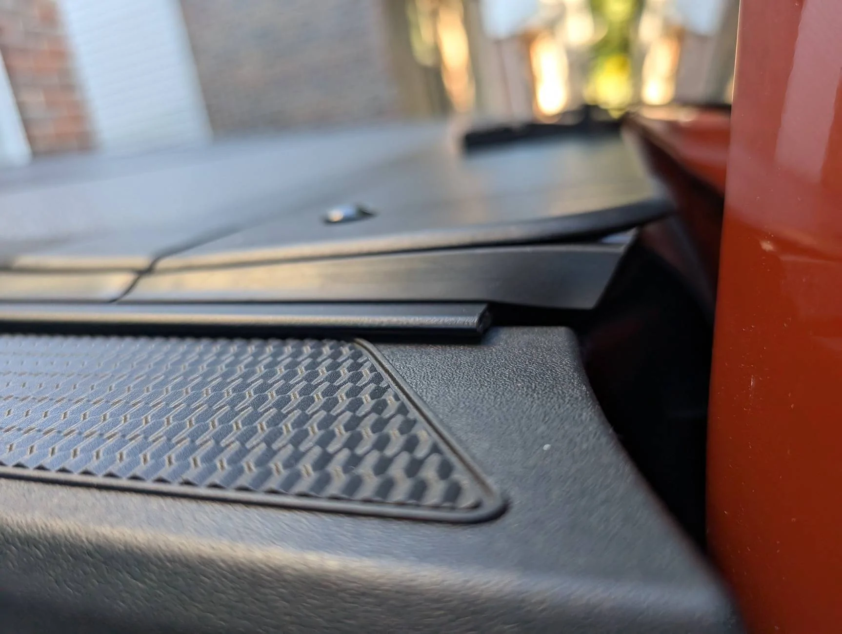

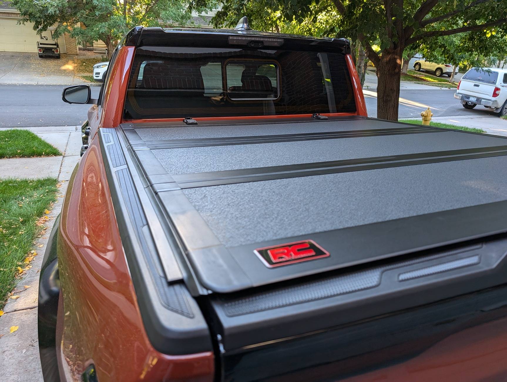

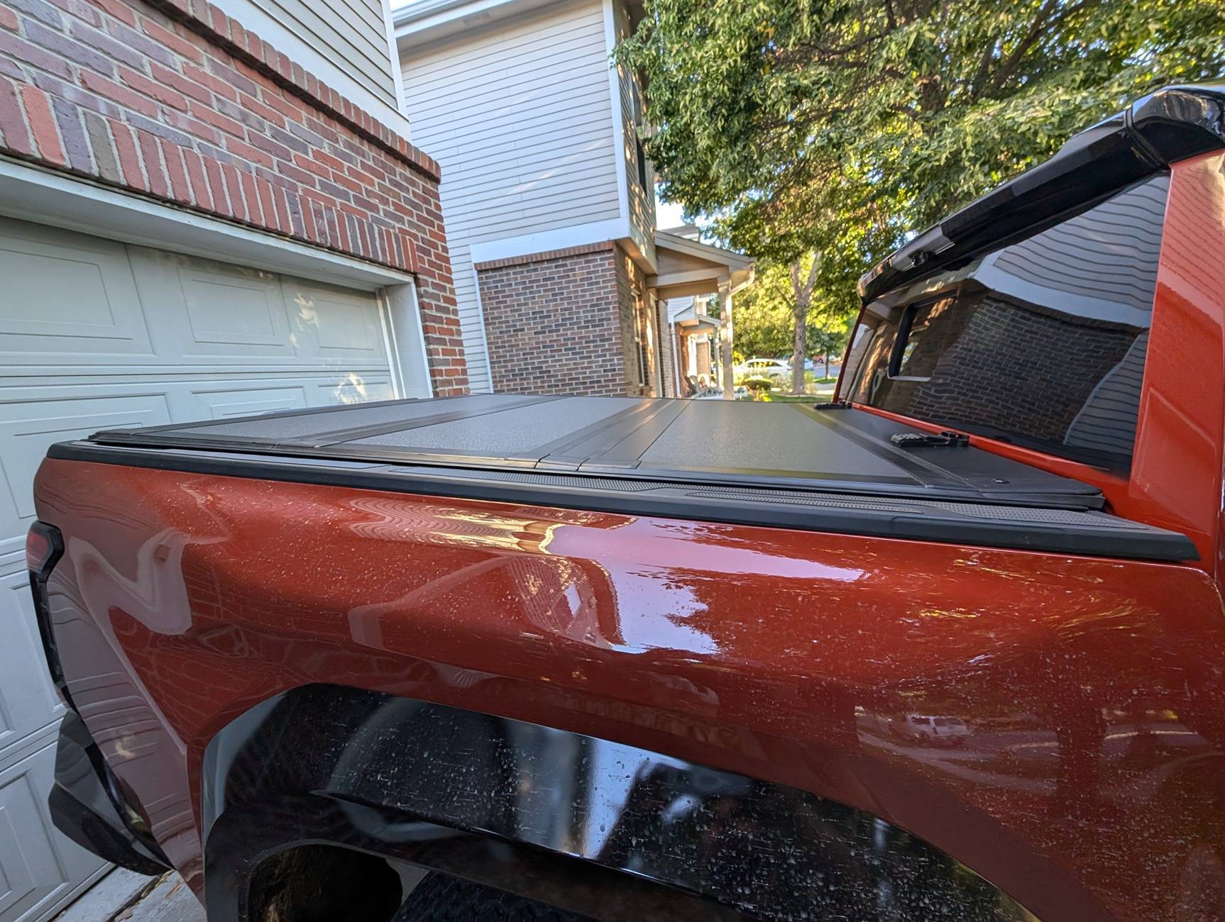

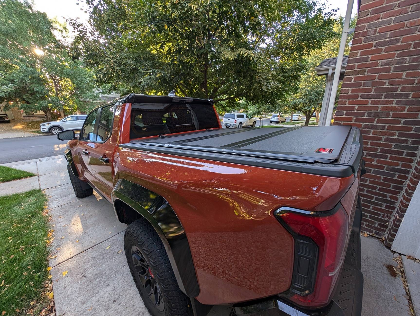

Hey guys, I went ahead and installed the Rough Country Tonneau cover on my TRD Pro. It looked very similar to the OEM but priced a bit better so I decided to bite the bullet and go for it. I gotta say it looks and functions really well so far and the install itself was pretty straight forward with a bit of fidgeting to get things lined up right. I made a quick install video since the instructions it came with were almost useless. Anyway, here are some pics of how it looks and the install video in case it's useful for anyone.

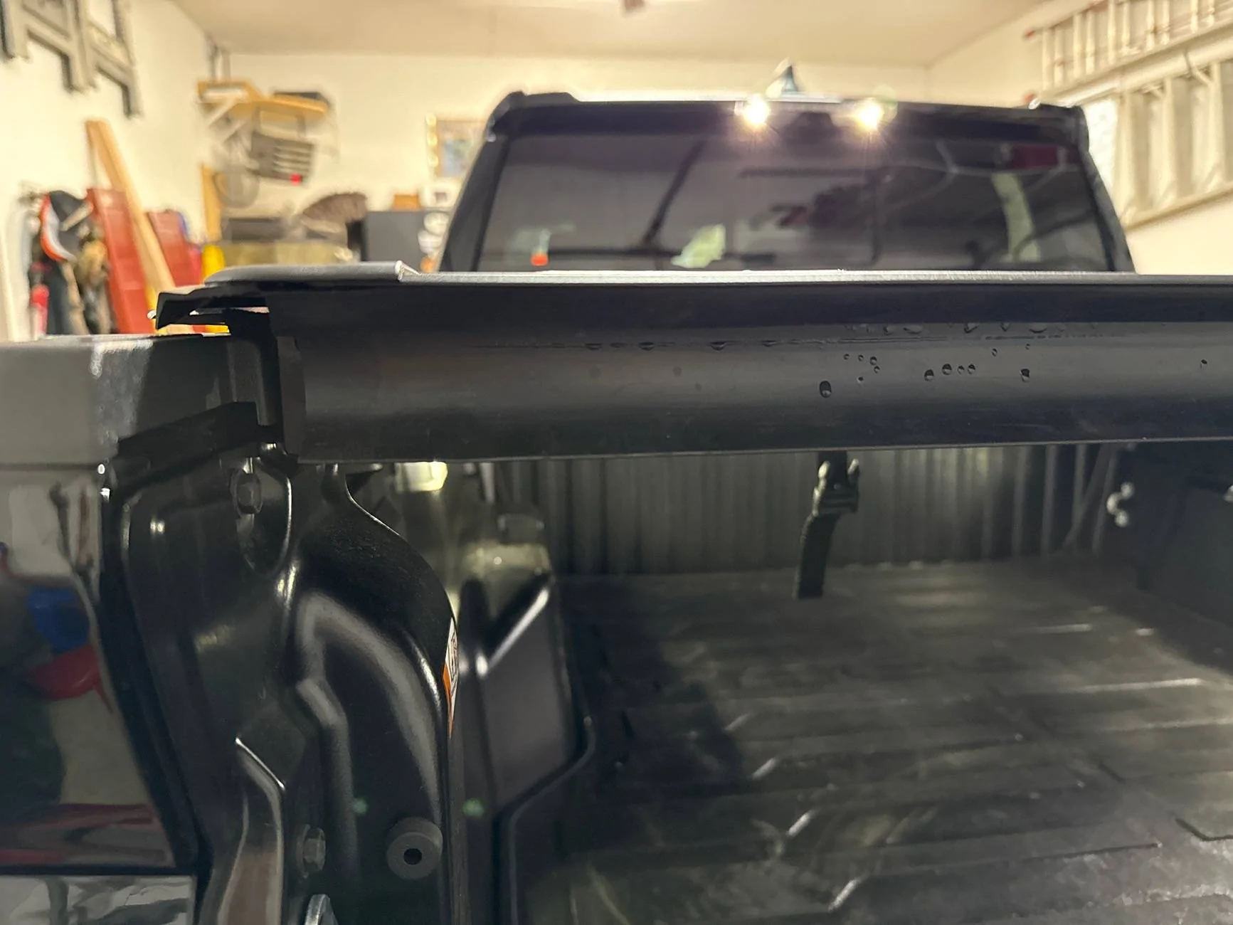

I had the same issue. That rubber flap needs to be hanging straight down inside of the tailgate, not smashed between the tailgate and the cover.
Oh! I’ll have to do that! I thought it was the gasket to keep the water out.
You’ve had no issues with the power tailgate after folding the flap down?
