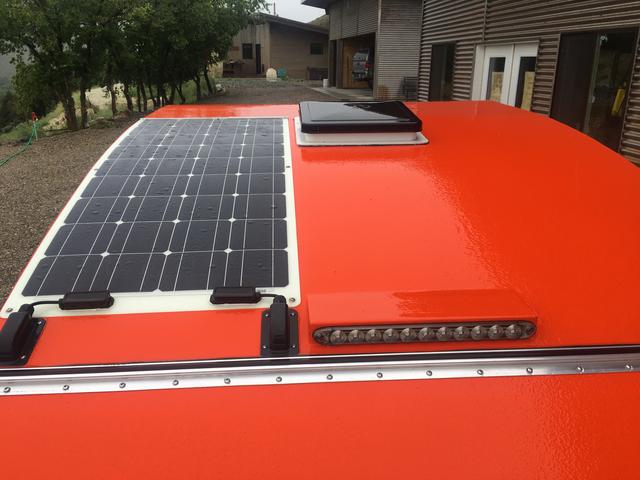

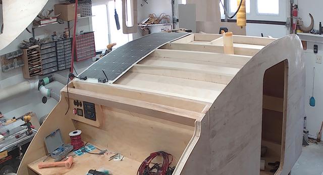

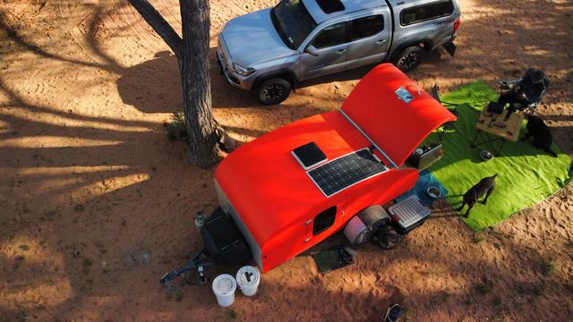

I can't help with your concept, but keep in mind that most flexibles are junk. Make sure you go with a high-quality ETFE panel, such as one made by Renogy.
2024 Tacoma Solar question QvlwI2v
2024 Tacoma Solar question OfOYwjv
2024 Tacoma Solar question 8hqSPJK
It will be a lot easier to make it a permanent installation since otherwise, you'll need to move the controller, too.
