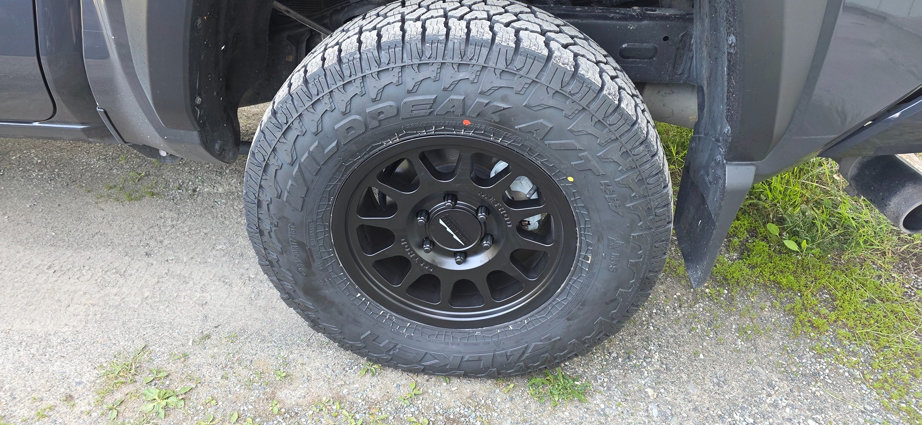

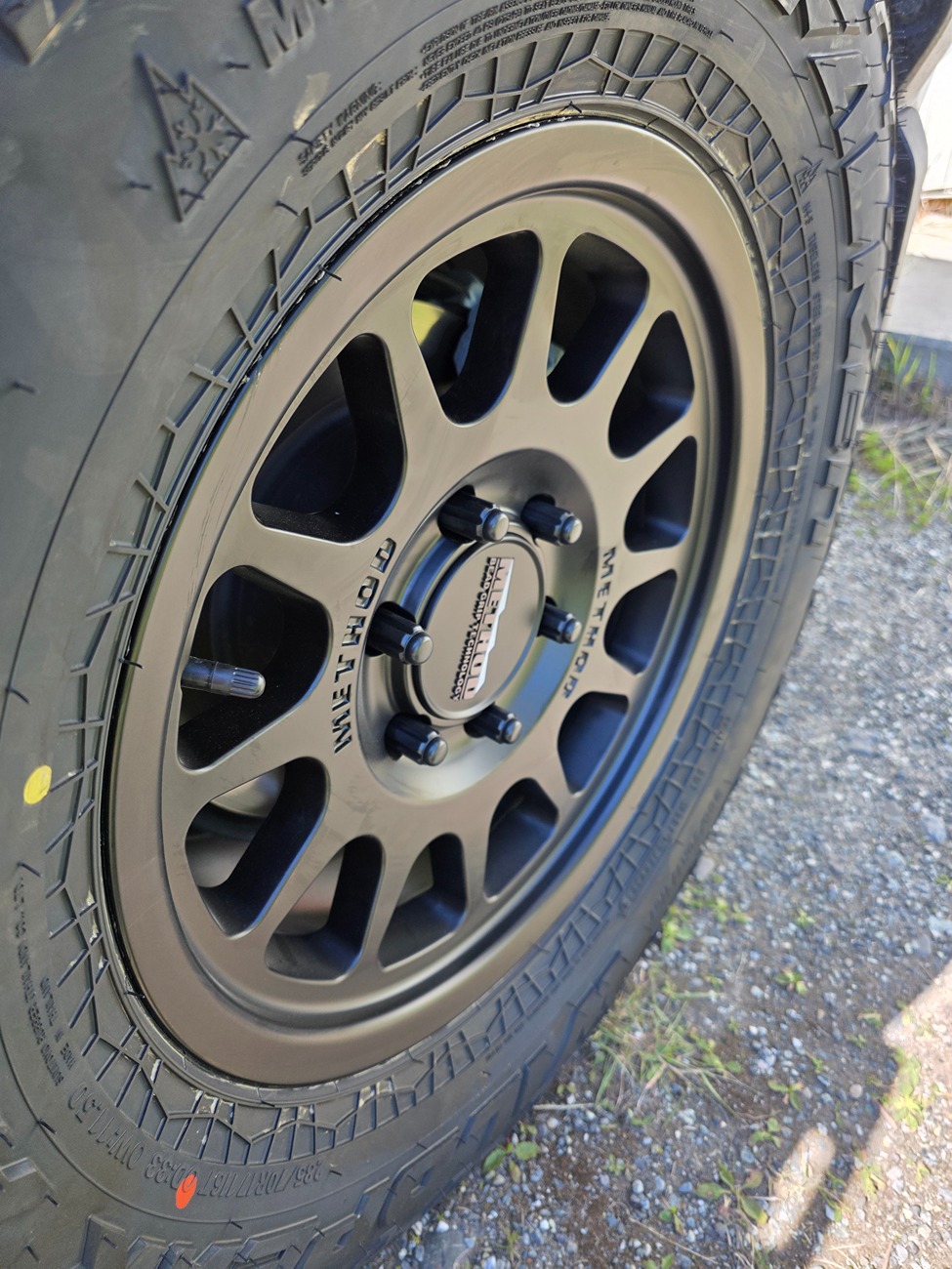

Ok I know this is a stupid question... But when I put new wheels and tires I didn't replace the spare... I'm just wondering what people have done... Carry extra oem lugs, buying a 5th aftermarket method wheel or will the spline lugs fit?

Carry a set of OEM lug nuts in case you need the spare. The aftermarket will not seat properly and you'll be in big trouble. Pull an aftermarket nut off a wheel and compare the seating angle with an OEM one. You'll see the difference. They won't secure the OEM wheel. The diameter of the aftermarket lug nut is probably smaller too.

Thanks thats what I figured just wanted to be 100% sure appreciate the help
