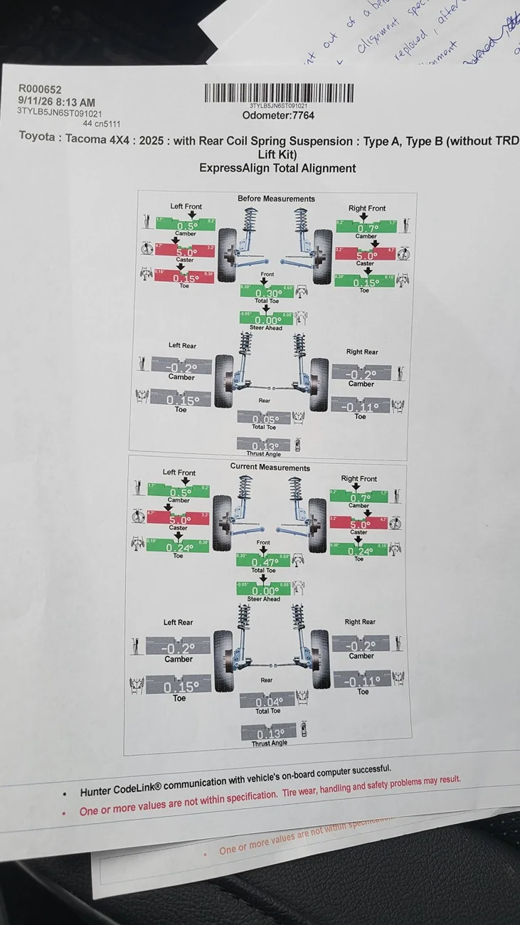

The new shop has the newer Hunter equipment. They selected the proper 2025 Tacoma 4x4, rear coil spring, Type A/Type B without TRD lift kit profile.
This is where it gets interesting.
They attempted to align the truck three times. According to their written work order, each time the truck showed in-line and the steering wheel was straight at the end of the alignment. However, after each road test the steering wheel was off-center again. After three attempts they stopped and documented that they were unable to determine the cause.
Their final front measurements were:
Camber: +0.5° L / +0.7° R
Caster: +5.0° L / +5.0° R
Toe: +0.24° L / +0.24° R
Total toe: +0.47°
Steer ahead: 0.00°
The 5.0° caster on both sides is showing red on the Hunter machine. I realize equal caster side-to-side is good, but I'm also trying to determine whether 5.0° is actually acceptable under Toyota's factory specifications for this truck.
There's also a fairly substantial difference between the two shops' caster measurements. The previous shop measured +3.8° L / +3.6° R, while the newer Hunter machine measured +5.0° / +5.0°. Nobody intentionally adjusted the caster between those alignments.

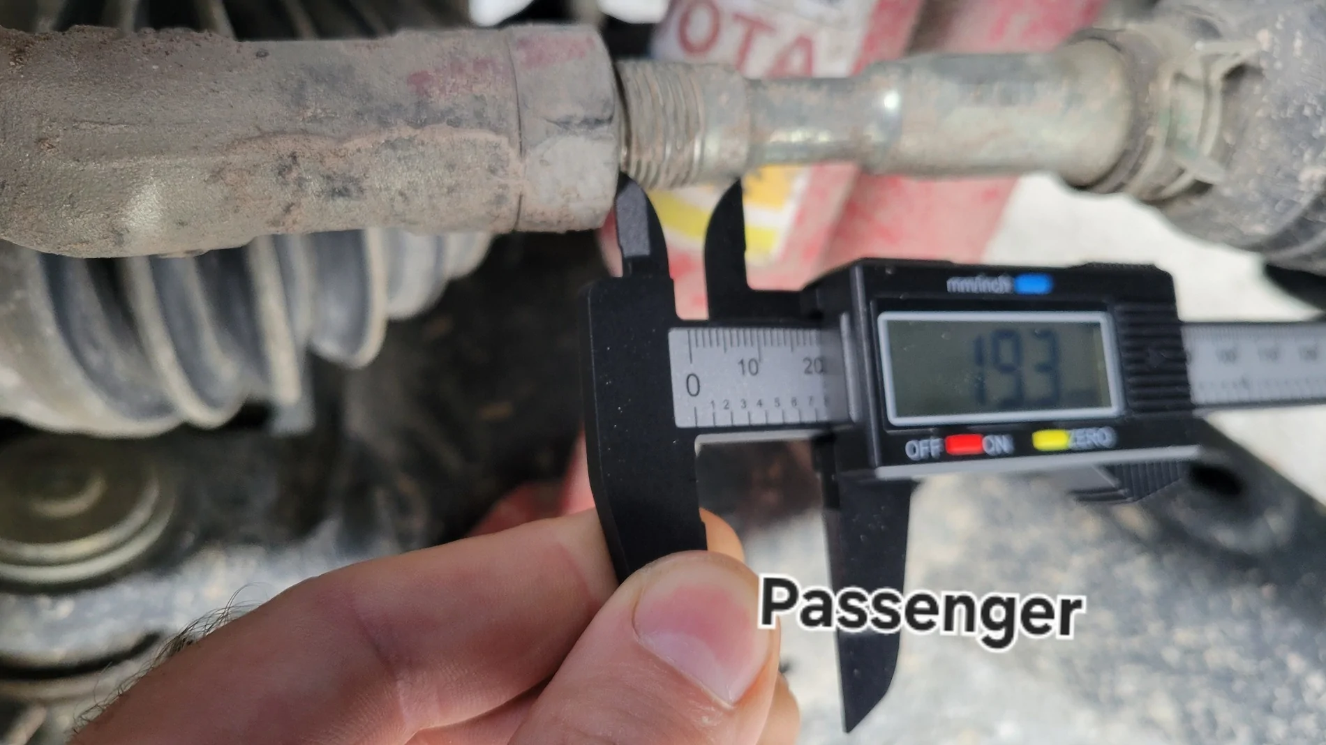

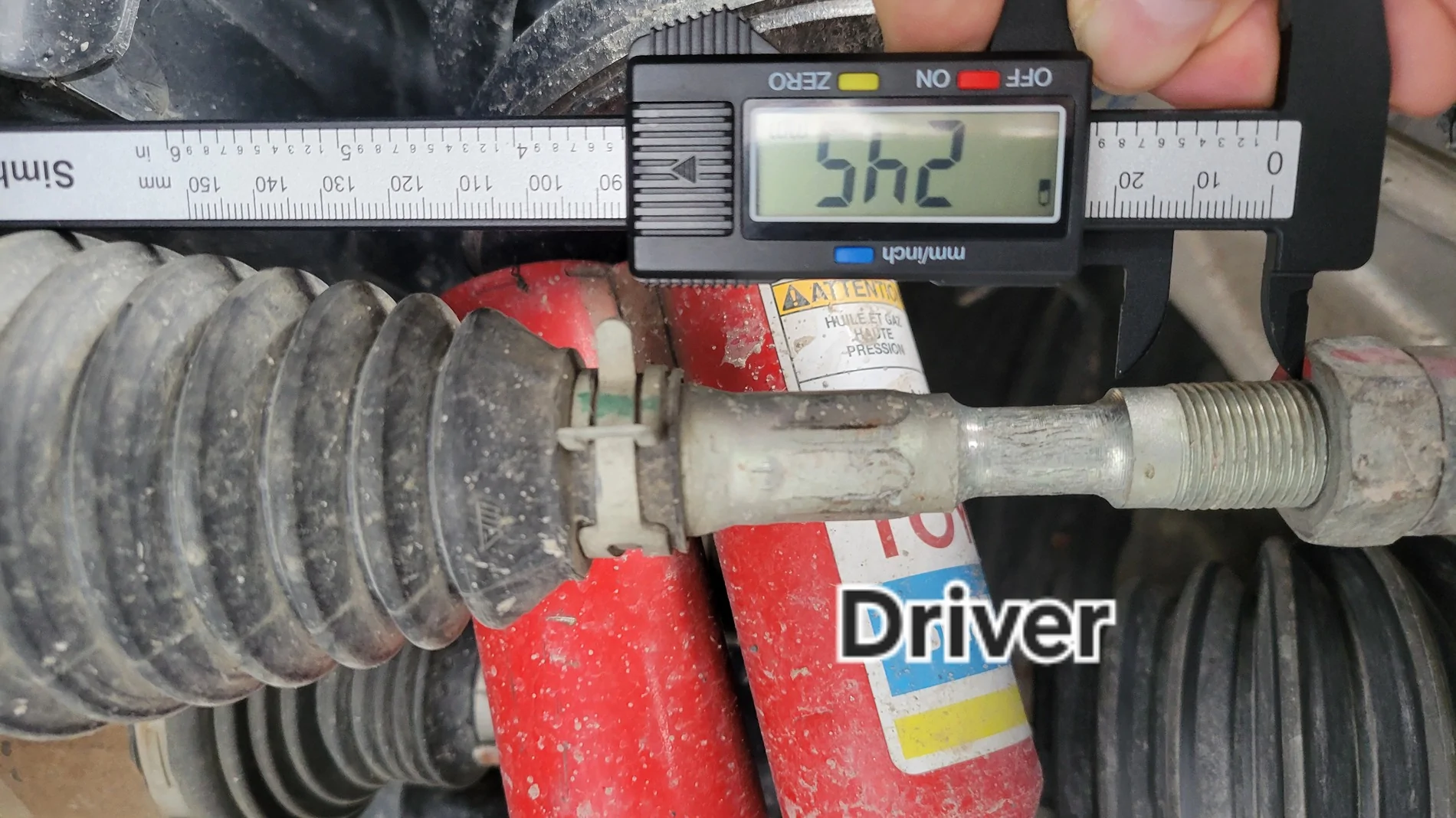

I've also measured the exposed adjustment area at the outer tie rods.
Driver: approximately 24.5 mm (1 inch)
Passenger: approximately 19.3 mm (3/4 inch)
So there's roughly a 5.2 mm (1/4) difference. I understand the two sides don't necessarily have to measure exactly the same, so I'm not claiming this means something is wrong. I'm wondering whether that amount of difference is normal on these racks.
