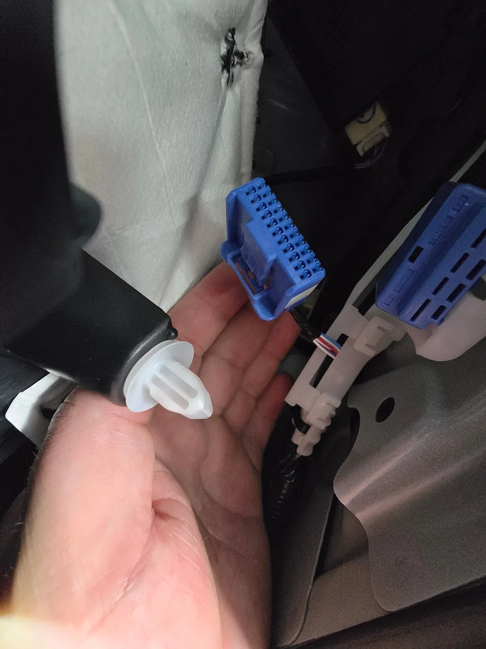

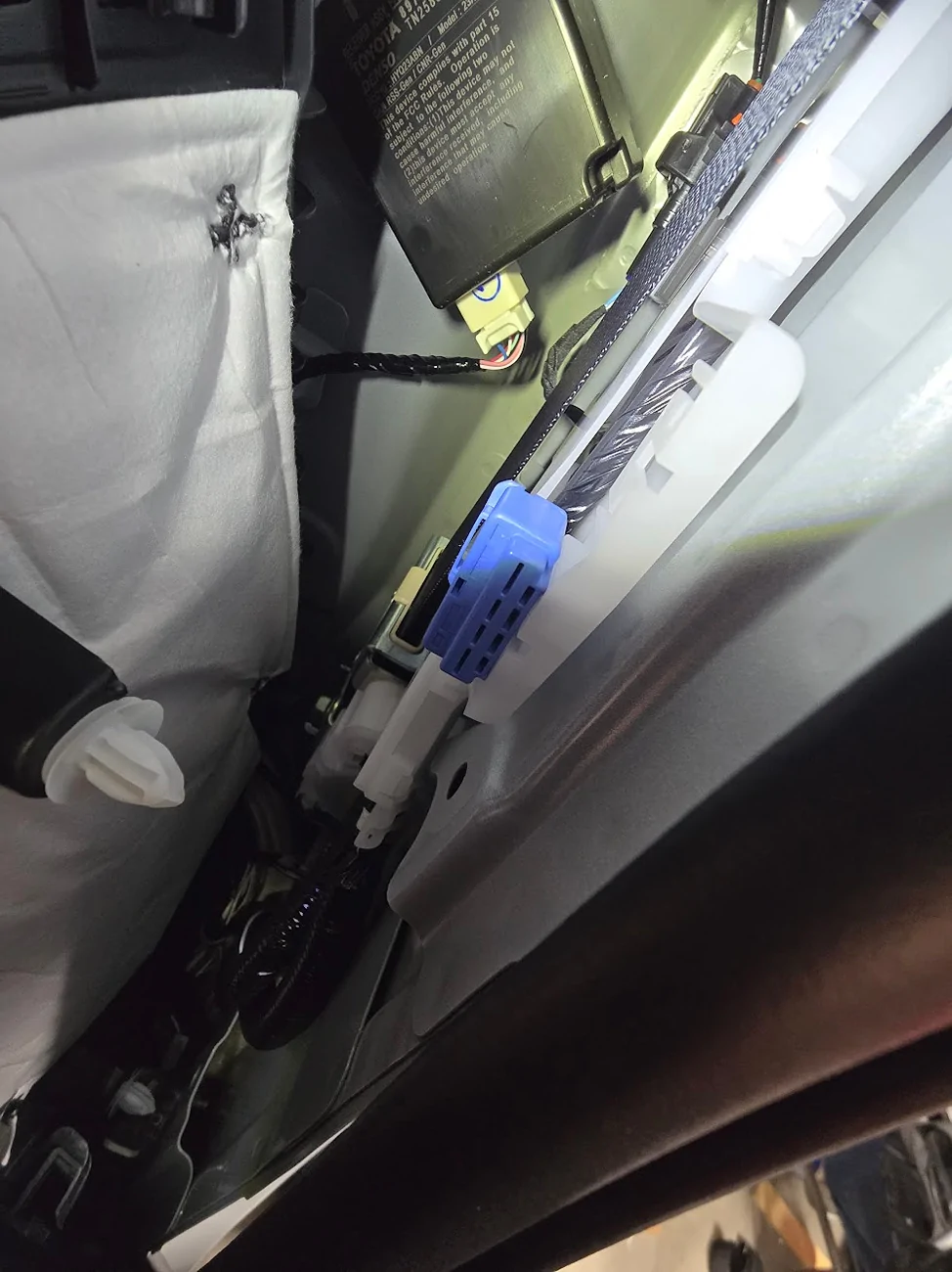

I tore open the back to look for ECU wiring and I cant find it... unless the wiring is not terminated and just wrapped in electrical tape..... ... It has to be somewhere because I dont think toyota used separate wiring harnesses, it wouldn't make sense. hence the button wiring is present
It should be here, but all I found was this extra blue connector which doesnt have enough pins to be the stabilizer ECU

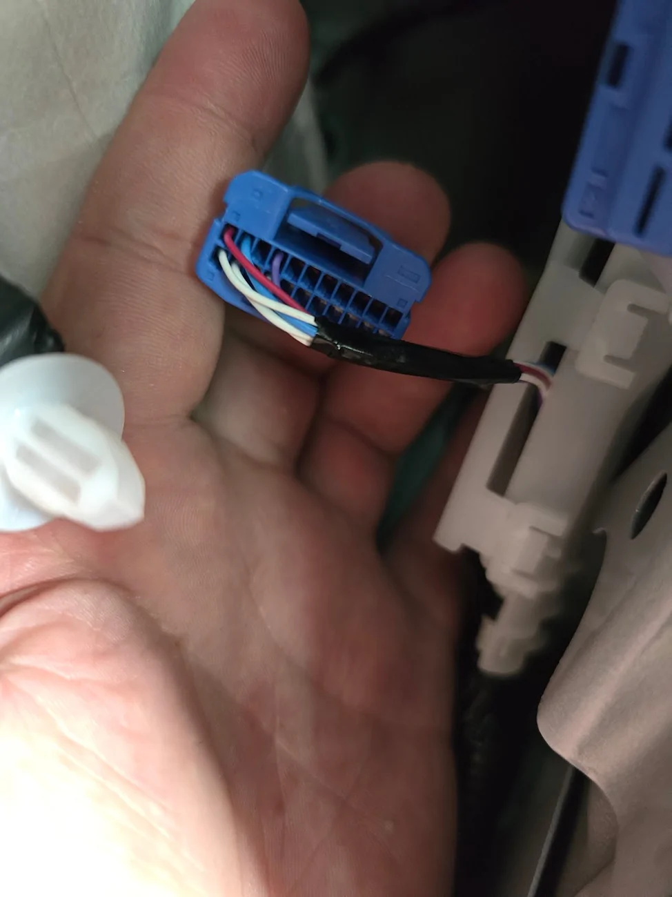

Connector should look like this

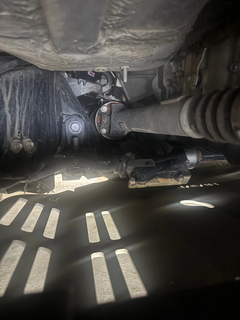

FYI here’s my mechanism, shows some of the wiring.
So we are truly SOL unless it's really hidden..

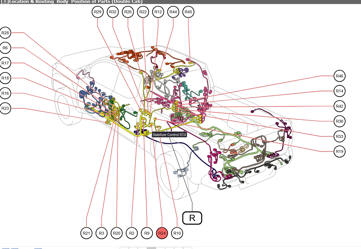

@turnermier i did some research and the "Instrument Panel Wiring Harness" is separate from the "Wire, Floor". the SDM switch is on the "Instrument Panel Wiring Harness" which should be same for non-SDM and SDM Tacomas.
The "Wire, Floor" is the harness that has the connector for the SDM ECU and there are several part numbers for it. and then there is a "Wire, Frame".
look for 82161-AK250, 82164-AK130. there are like 20 part numbers for "Wire, Floor" and "Wire, Frame". it's not too difficult to swap this harness but at what cost! this project will need a donor Tacoma with SDM. And then there might be an aftermarket solution which will be much easier to install in maybe 1 year.

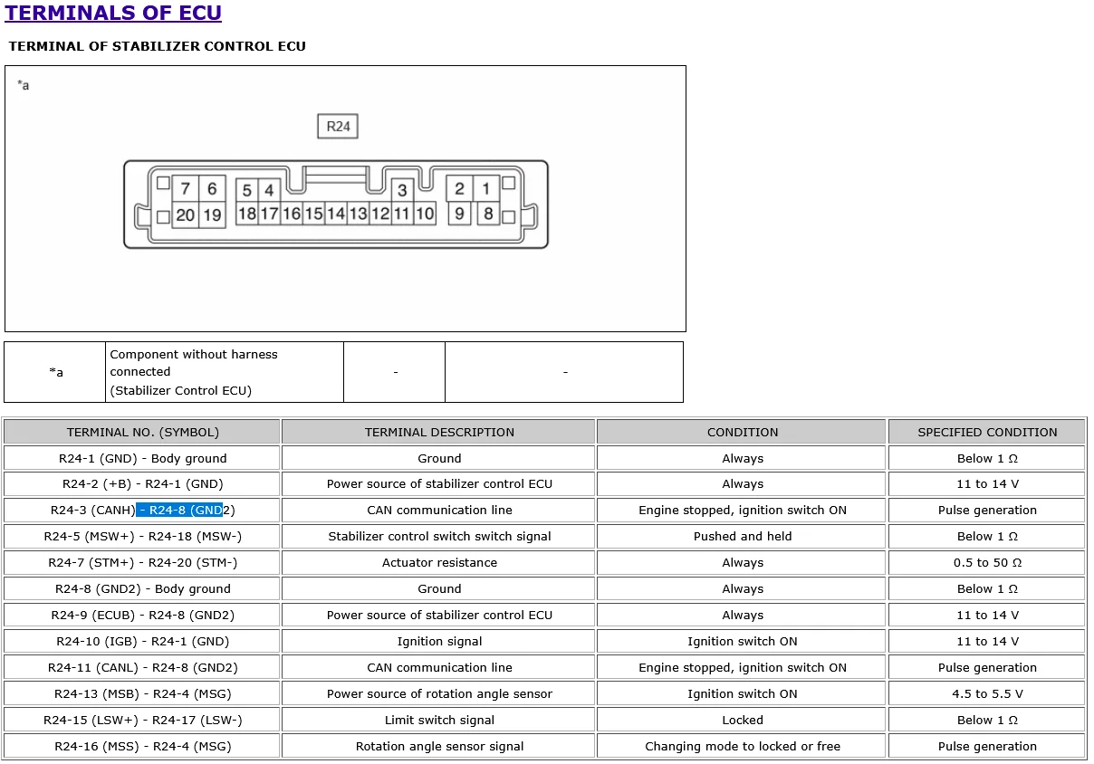

Even if you were to install the correct wiring harness and add the ECU, and the actual mechanism you still have a roadblock with marrying the SBD ECU to the main ECU.
We still don't know if this is possible within GTS+ (previously called Toyota Techstream)
After that's all said and done the factory system still would only let you use it in 4Lo which makes aftermarket options much more appealing.
I think if I was going to do it, I would just get the factory sway bar disconnect motor and sway bar from a junkyard and hotwire it to a relay and switch. Of course this removes all aspects of safety but it means you could use it at any time.

what makes you believe that SBD ECU and the main ECU talk to each other? I know one popular aftermarket manufacturer is already working on a 4G solution.
