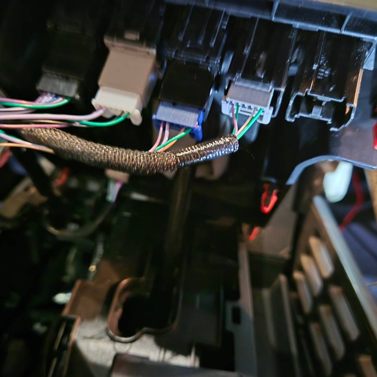

FWIW, I think it may be pre-wired, but I don't know. There is wiring and a connector where this goes in the console with a blank on top. Talking about the connector on the right end and there is a blank on top

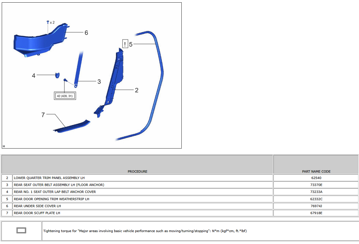

Were you able to snag this one? Might not be the one we want but they say it's sold.

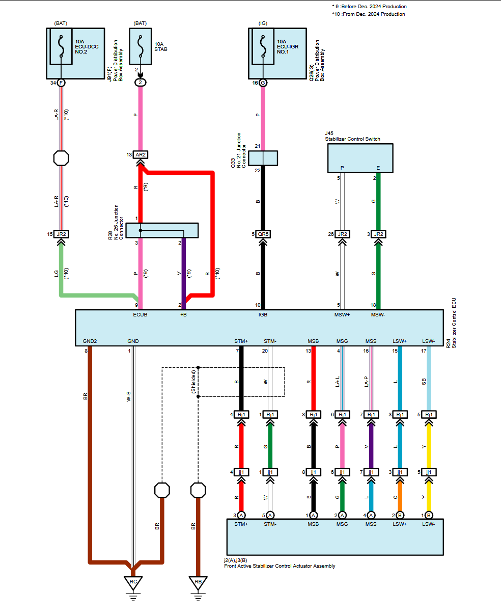

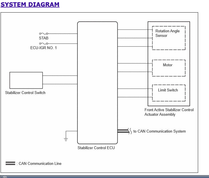

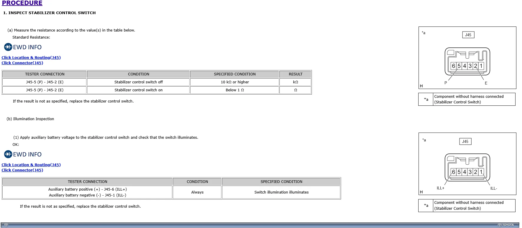

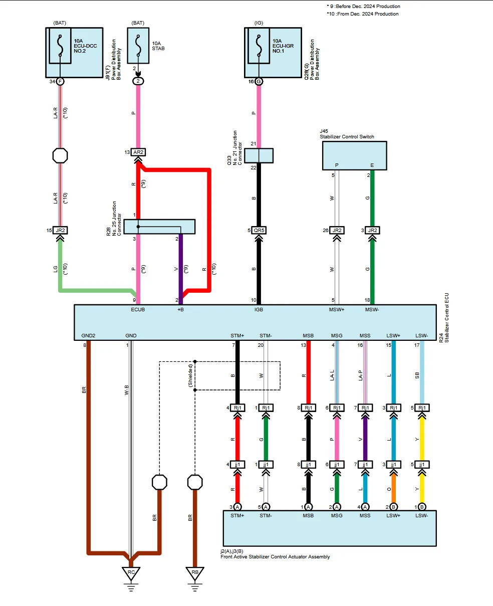

Just wanted to add more information.
Looks like you will also need stabilizer disconnect ECU

Which means practically impossible to retrofit & wait for an aftermarket solution
You could just install the factory sway bar disconnect and take off the motor... Actuate it by hand when you need it.
I believe it is a sealed unit. And it is still priced 100% incorrectly as a spare.
