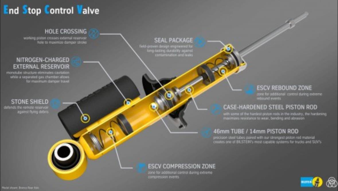

Can some one tell me what the current spec on the TRD OR Bilstein shocks are or what is their equal comparison .

Wow perfect, do you know the length? Now what would be a good upgrade replacement ?
