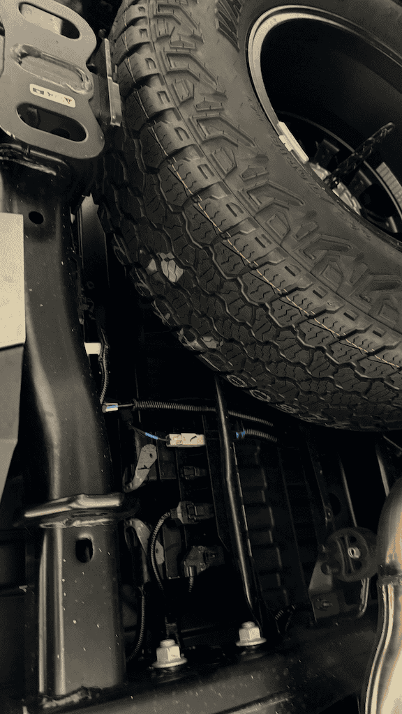

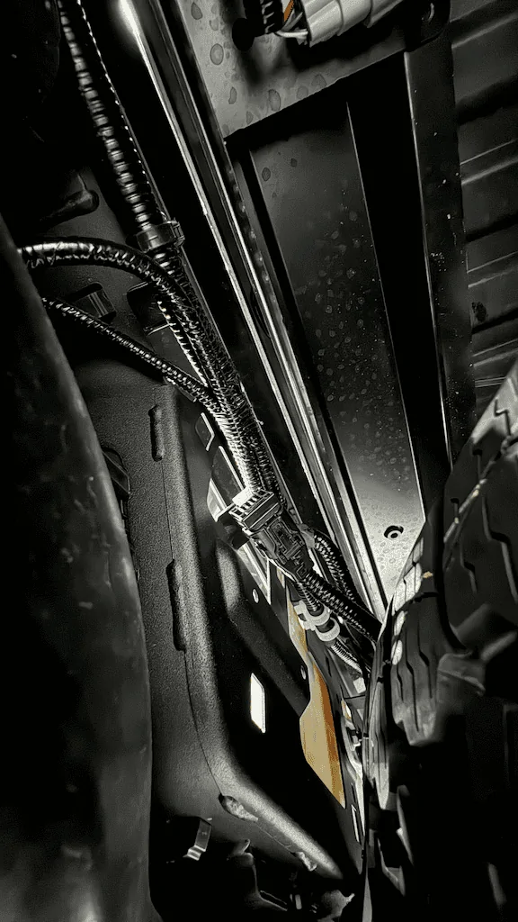

Hello,
I've been investigating the same thing about the brake light, cameras, and chmsl relocation.
Here is a photo of TRD Pro what may be the tailgate connections under the bed on driver side by exhaust. Note the beige connector with blue band on wire. This looks like the connector type Toyota uses for cameras. Note the capped unused connector which I think is maybe one of the Aux ports for a pigtail?
The next pic is from behind the license plate on the steel bumper. Not sure what this connector is intended to be used for. Maybe that's the aux port?

Hello,
