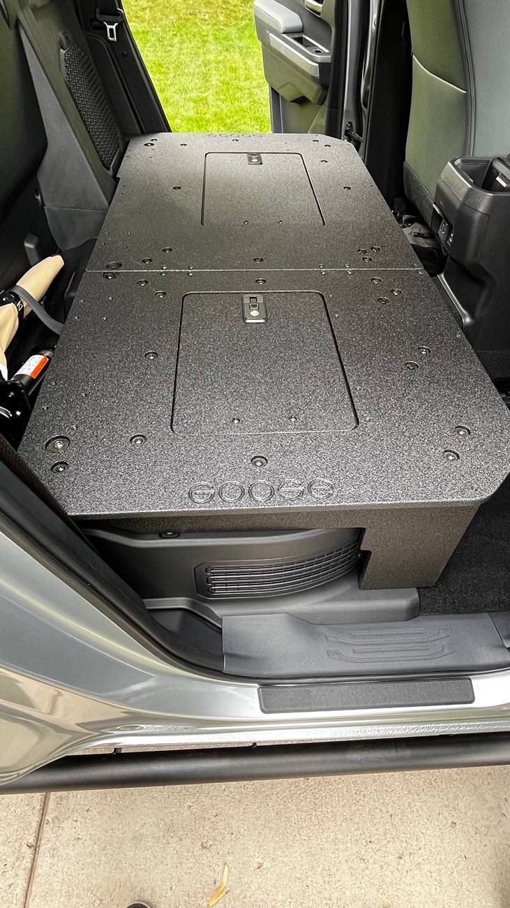

The seats fold up by removing the pop-pins along the front of the seat base trim. Engine battery and hybrid battery are under there
2024 Tacoma Tacoma Trailhunter Rear Seat Storage? IMG_6505

I would like to fabricate some sort of platform to add to the top of this, so that when the seats are folded up, I can pop a dog bed down there for the pup.
If it was thin enough, would the seats be able to be lowered onto it?
No, I don’t think so unless it was like an 1/8” thin or under. The pop pin trim fasteners & seat brackets are a tight fit.
I rear deleted both 60 & 40 with goose gear. It maintains the OEM seat clearance into the hybrid cavity and increases depth. And height in the process. If my dog was small enough I’d just buy a cordura dog insert or do a 40 delete.
2024 Tacoma Tacoma Trailhunter Rear Seat Storage? IMG_6507
