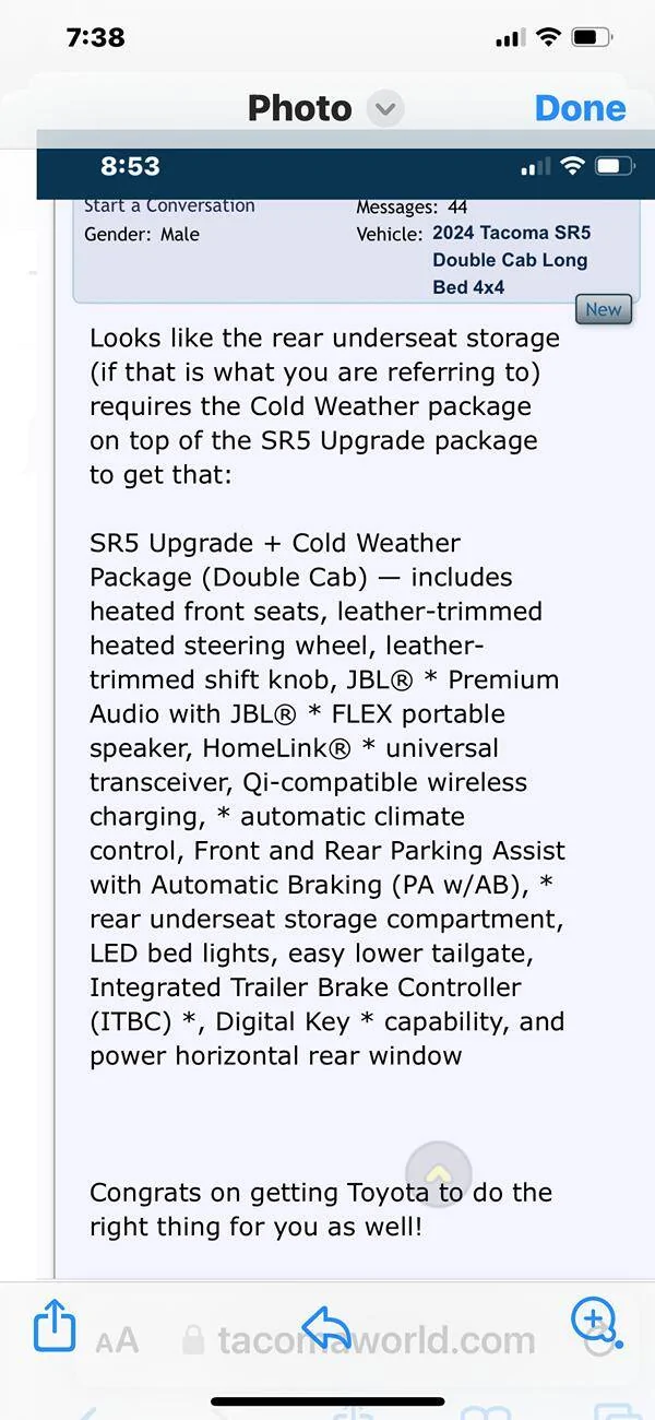

I believe only the sr5's with the upgrade package have the open slow dampened tailgate....
We’ve figured that out . Now we want to know if it’s possible to put the support on the ones without ?
I didn’t see it listed as part of it, but I do indeed have the upgrade pkg.
The different SR5 trims is so funky on these .

Specs to the upgrade package, it’s listed…

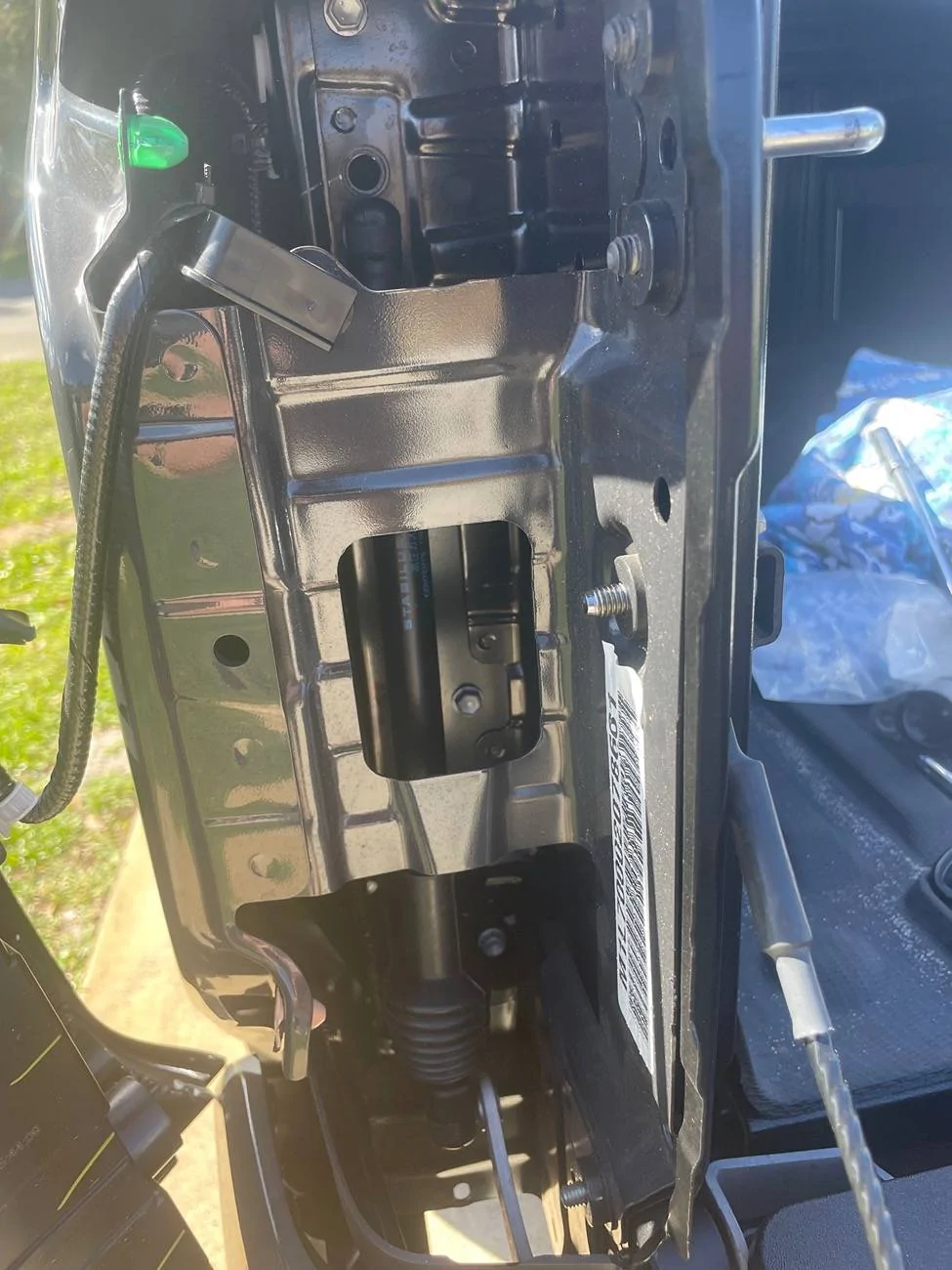

I’m willing to spend the $100 in parts but by looking at my rear light and tailgate. I see where it mounts behind the with a ball joint but don’t see how the support feeds behind the light and attaches to the tailgate .
Can one of you guys with the support take some pics of how it’s mounted to the tailgate and the rear light . I almost think it may be a different style tailgate required or light .

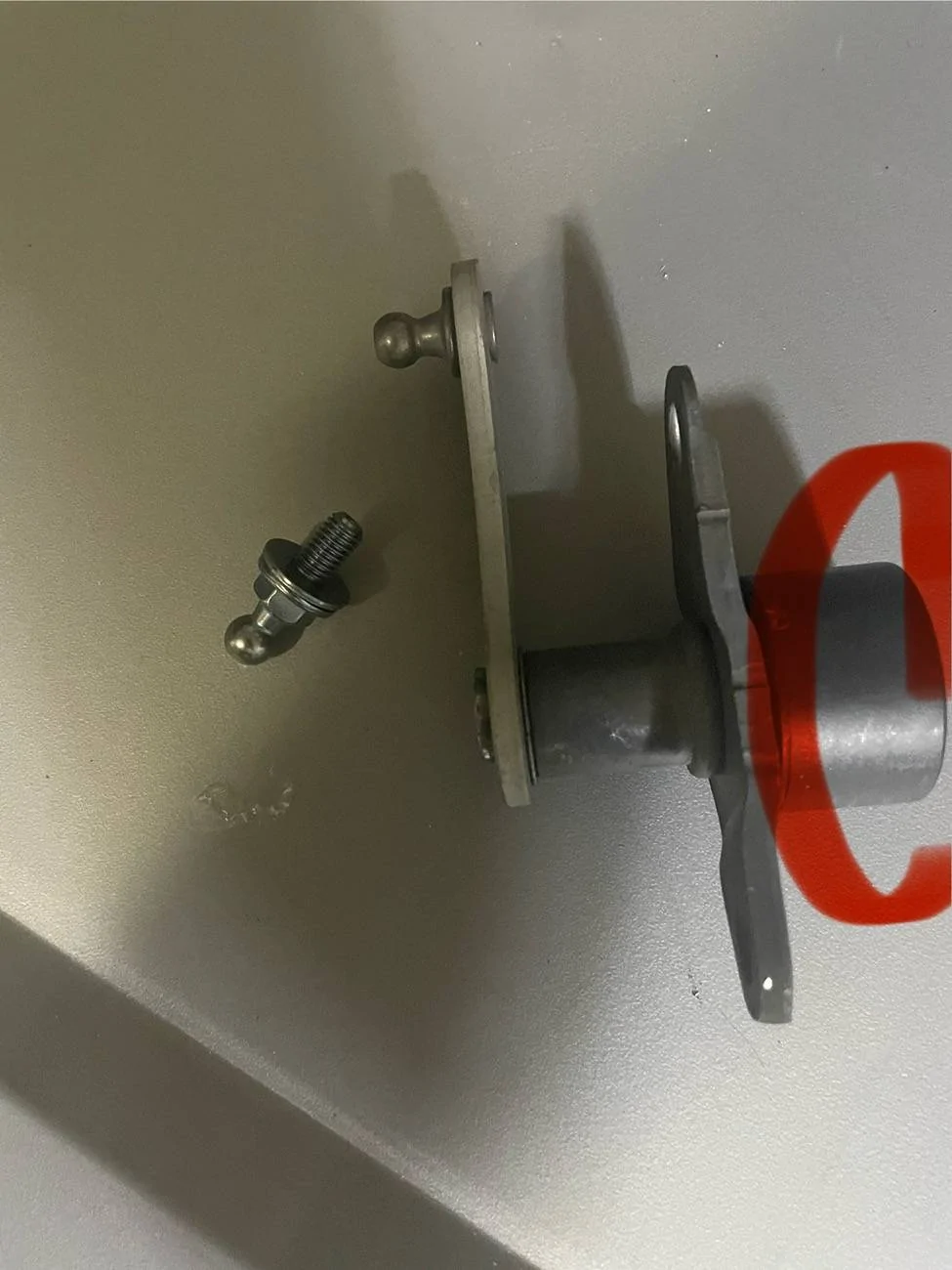

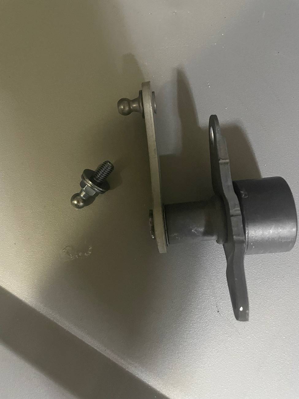

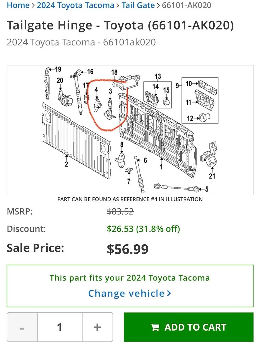

So also pulled my light off to take a peak . I see where the top ball stud goes and support feeds down to tailgate . There is a slot in the hinge that some part has to go into to connect the support/strut to. That’s the unknown part but I think I found it . Hinge Sub-Assy, Tail Gate End Post, Left Hand 66102-AK020
I’m going to order 4,6 and 7 and see what I get . Worst case I return the parts.

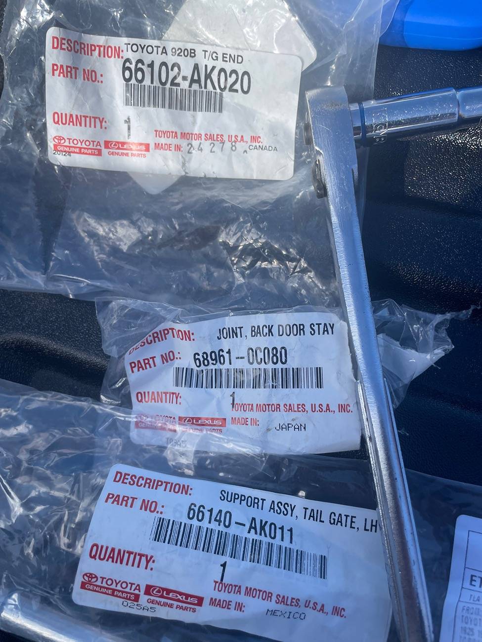

Pretty sure I found the part Hinge Sub-Assy, Tail Gate End Post, Left Hand 66102-AK020. Need these 3 parts . What do you think ?

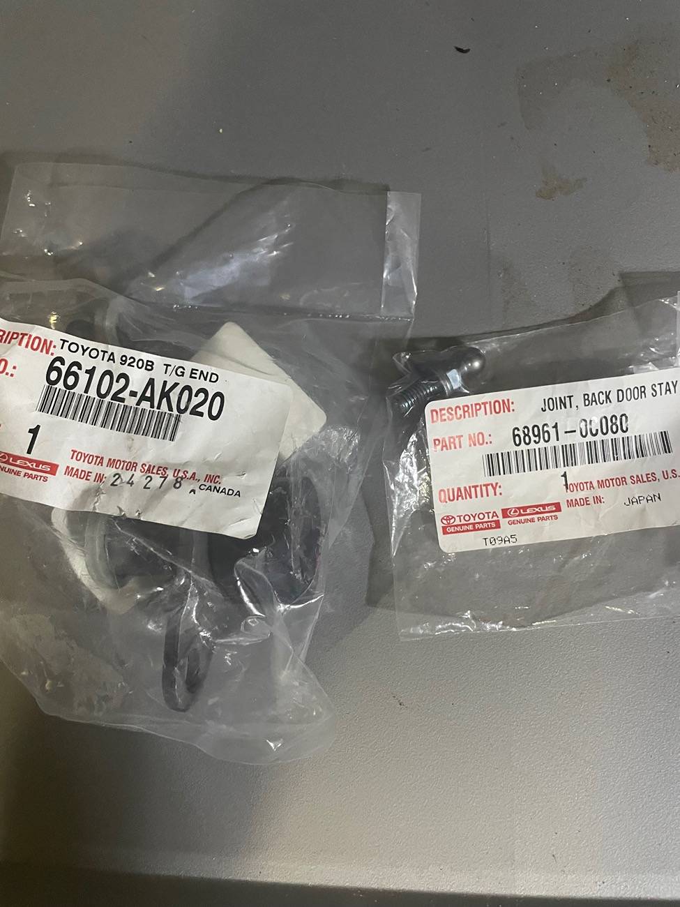

Got 2 out of the 3 parts for the tail gate assist . The support assembly 66140-AK011 is on back order but NUCAR TOYOTA OF NORTH ATTLEBORO located a few in CA and I should have it next week . Reach out to them if you are looking for the back ordered part.

Knocked it out in 20 minutes w/ help of wife . I couldn’t and didn’t really try to remove the plug that’s connected to the truck . Just laid the gate at an angle on the bed and had the wife hold the other end . Pop the hinge on first then you can put the gate back on . Adjust the circled part to the correct angle so it lines up with the gate pin then slide the right side back on . The rest was plug and play ,
