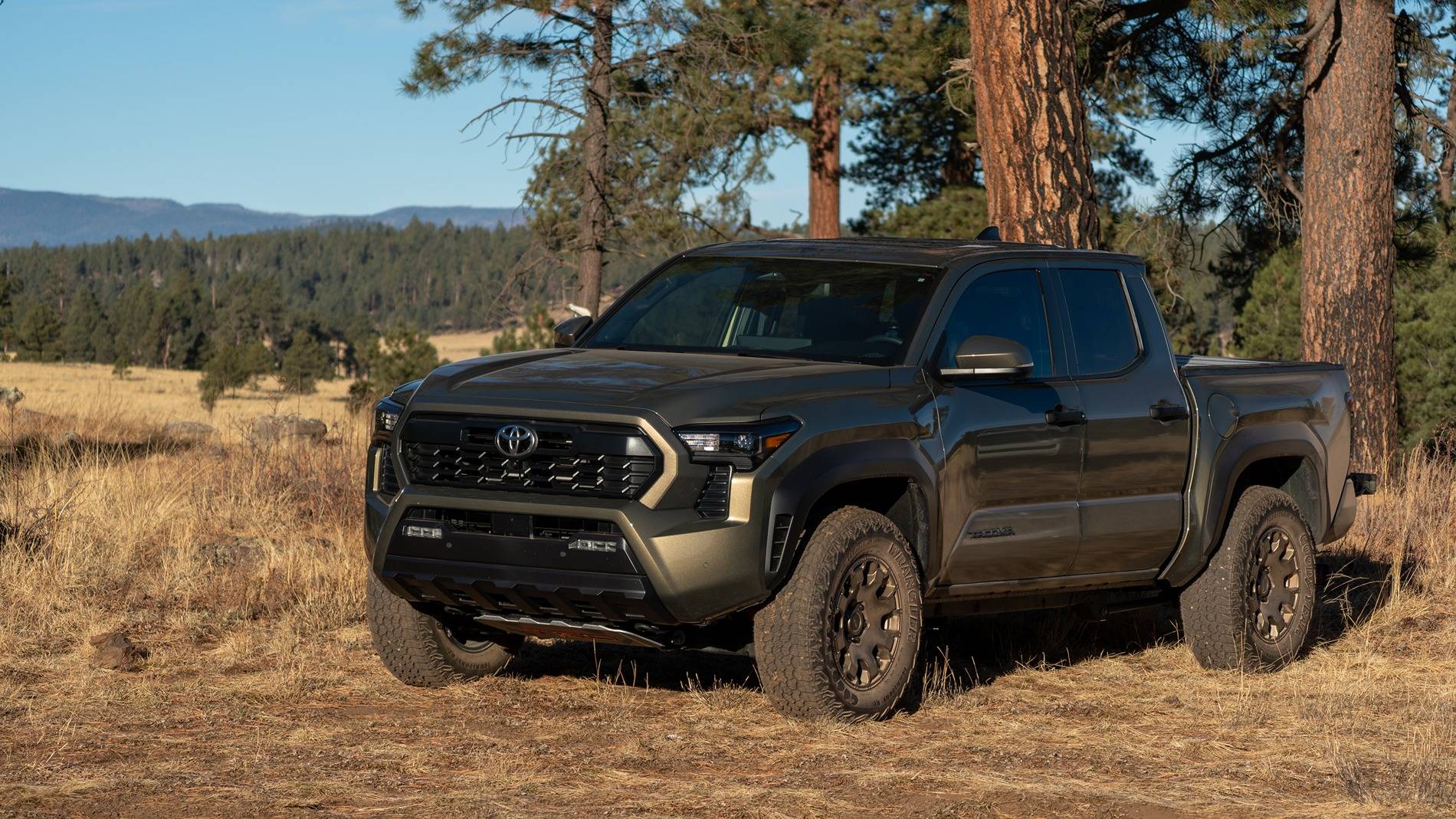

They look great on your truck and considering doing the same with either these or Pro wheels. Do you find you're getting much overspray or rock chips with the tires sitting 1 3/8" further out. My concern was with gravel overspray when I'm on local logging and fire roads. In the photos the +20 offset appears to have 3/4" or so of tread past the factory flares?

Yes, there's considerably more. I just ordered the wider mud flaps and also some rock sliders with top plates from westcott designs so I'm hoping that will be enough to solve the the problem. If that doesn't solve it then I guess I'll need to get the wider flares.

Agreed. The added poke inevitably causes more stuff to fly onto the sides of your truck. I added some rock sliders with kick outs towards the rear that have helped a lot, and also the ARK micro guards that also help to add a little protection. If you run sliders or running boards, these will definitely help to protect those rear fenders, but there are a ton of mud guard options out there as well to consider.
