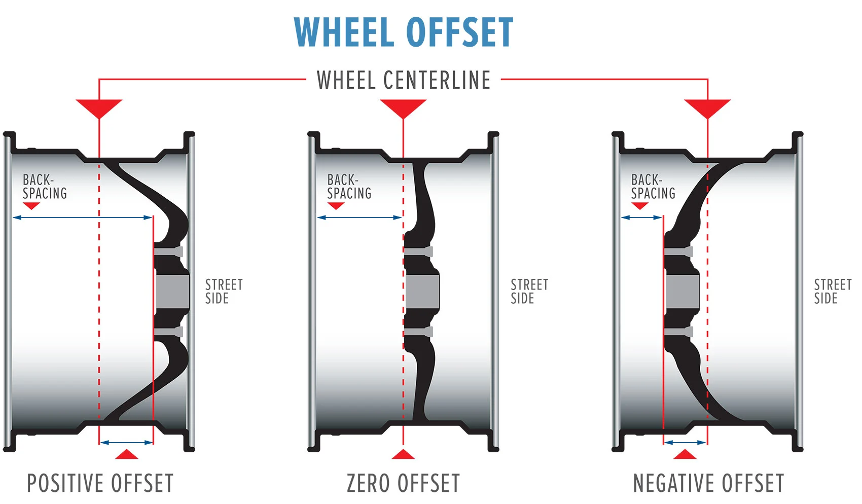

I don't know man, I think you may have too little offset. Stock TRD OR wheels are +55. The more your tire sticks out, the bigger arc it has to go through when turning. Take a look at the below videos for real world fitting of 35s. It's close, but they technically don't rub on a +55 wheel. That said, maybe the hybrid adds something and I'm completely wrong about your application.

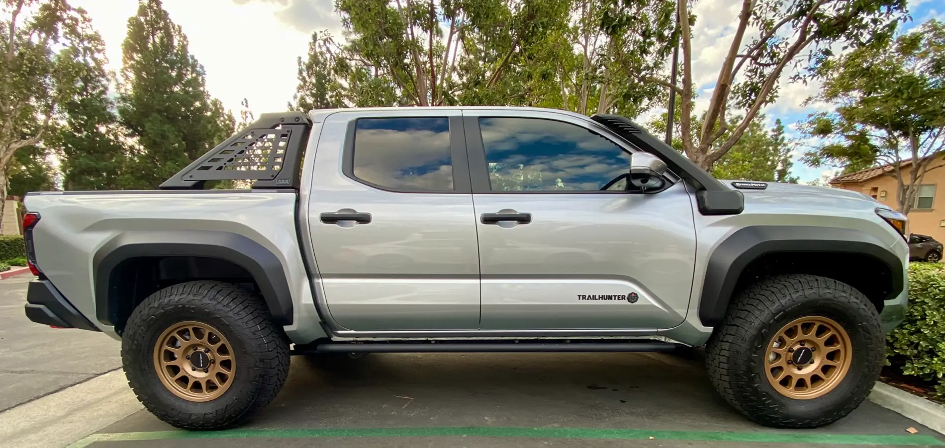

Everything is good now. I rerouted the sway bar disconnect wire above the frame and removed that bracket. I have no rubbing full lock forward and reverse even when hitting bumps and the brakes.
I will hit the trails this weekend and see how it does off-road flexed out 🤞

Nope, still have about a half inch of clearance even at lock. No rubbing on the road, but not sure if it's enough to clear when off-road. I will test that this weekend.

Sorry for the late reply; I didn't go out yesterday due to the rain here in SoCal. When out today and did some easy - moderate trails. In a few areas, I was fully flexed out and made it a point to steer lock to lock, with no rubbing.
When angled just right, the clearance between the tire and the crash pad is extremely tight, about a finger's width, but it never rubs.

New update:
I hit a few more technical obstacles. Steep hill with deep moguls.
The front-drive side rubbed against the crash pad. I will be removing it.
The rear is rubbing as well, which I didn't expect. There are small bumps in the plastic wheel liner that extend about an inch at the bottom, and the tires rub lightly on them when fully flexed and under load while climbing. I don't think I will do anything about it, they will wear down eventually.
