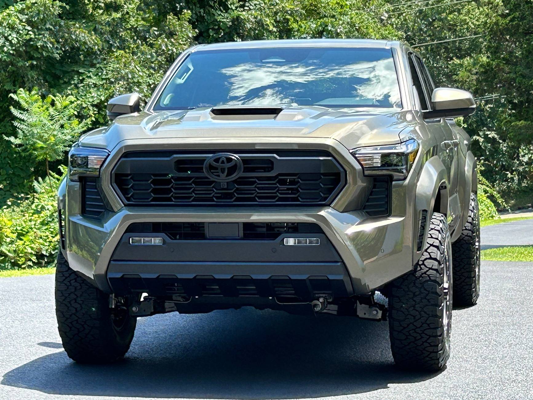

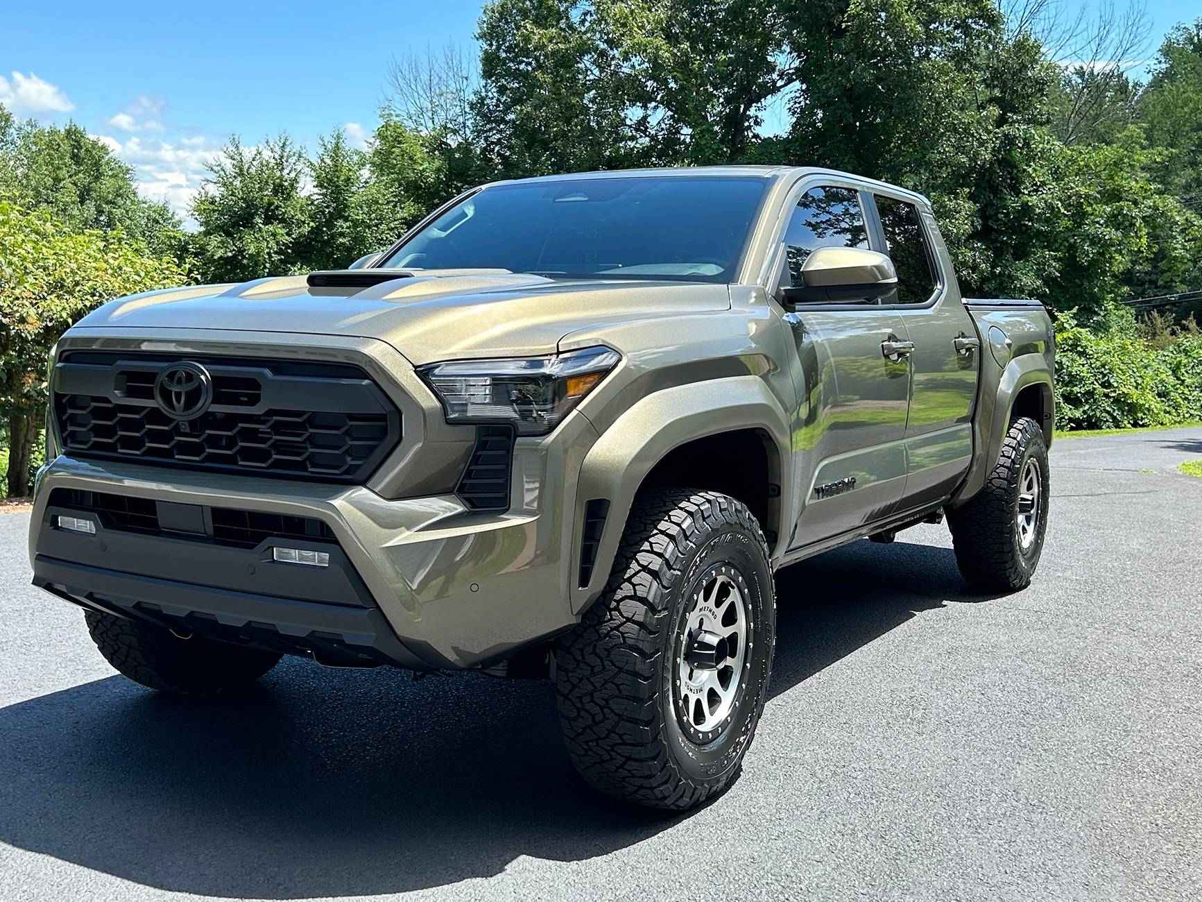

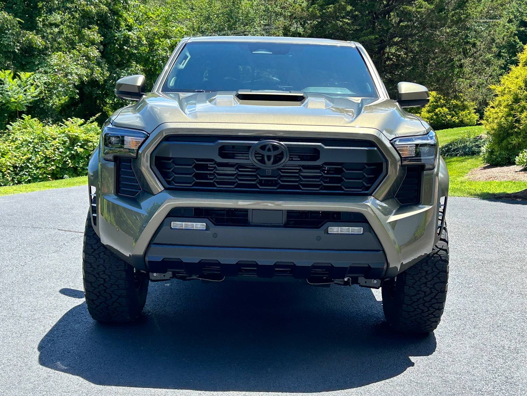

Just installed these 295/70R17 (33.3”) on 17” Method 314 (+25 offset) on my TRD OR with stock suspension and there’s no rubbing! I haven’t fully flexed everything out, but it all looks like it’ll fit when stuffed. Also didn’t have any rubbing when turning into my driveway at full lock. I’ll be updating once I get it on some ramps in this post and on my IG below.

That's good to see no rubbing during articulation. Isn't that size about the same as 275/70 with 18" rims. Probably a bit wider though.
