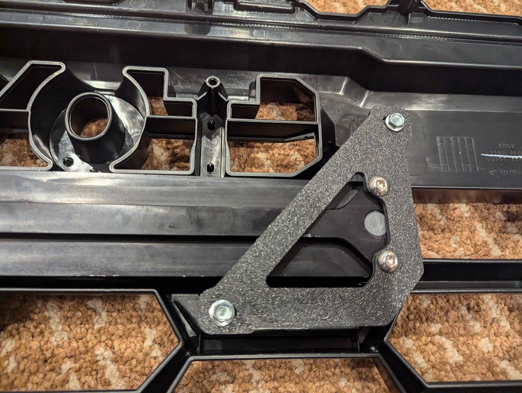

Ended up scooping a TRD Pro Grill for a bargain and was working on getting a bracket designed to mount my lightbar.
I think the Rave guys also were working on a bracket for the Heretic to the grill but I was impatient, lol. Few tries with the good ole calipers and she's dialed in.
Seems like a great fit. Off to sendcutsend to get these lasered in some mild steel. Hope to have it mounted on the truck in a week or two. For anyone interested, not sure what other options are really out there, but the Heretic literally is a perfect fit since the brackets mount from the rear rather than sides.

Was tempted to go this route as well, but scooped the Heretic bar up for only $240, and the grill for sub $300, shipped.
For simple brackets, sendcutsend is a godsend. Got em black zinc'd as well for only $10 a pop total. $40 min though so I picked up an extra set, probably will sell those extra brackets here for what I paid if anyone is interested.

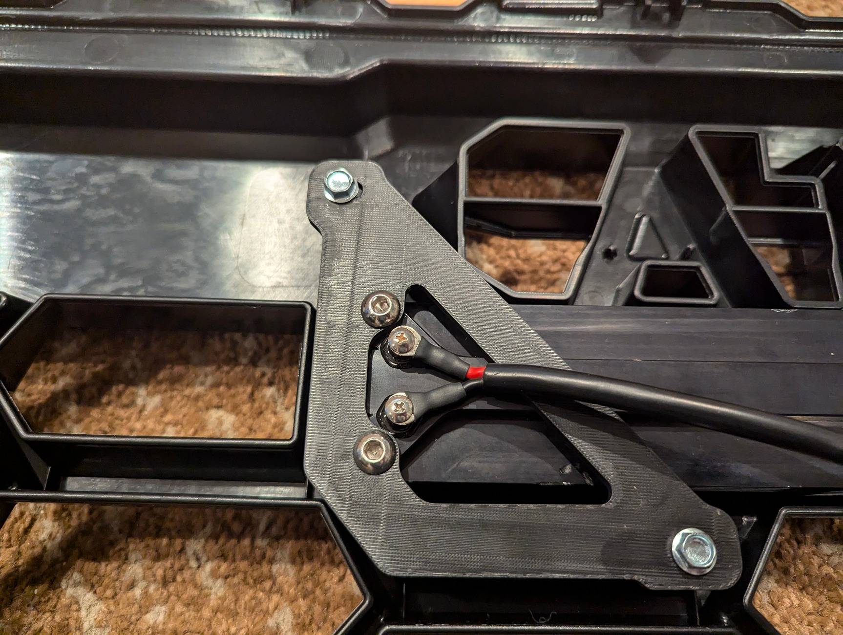

Here's the bracket for anyone that wants to swap their OE lightbar or installing a fresh heritage grill with the Heretic bar.
As I said, I have an extra set of steel ones being made that I'd be happy to part with (no pun intended) if anyone wants them. Probably will have them in a week or so.
But feel free to print/cut these. Maybe they'd hold up if you use some PA-CF hybrid filament as it's quite strong, but for the cost, I figured I'd just get them lasered out of 12ga steel. I made my test set out of ABS, since I've got a ton of it laying around.

Cam bracket design is almost complete. Just need to get the cutouts for the alignment pins made and we should be set.
Unfortunately, the Limited cam bracket is a lot different than the TRD OR/Sport bracket. So it took a lot more tries to get the angle and screw pattern dialed in.
Hope to have a final release of the bracket in a day or two.

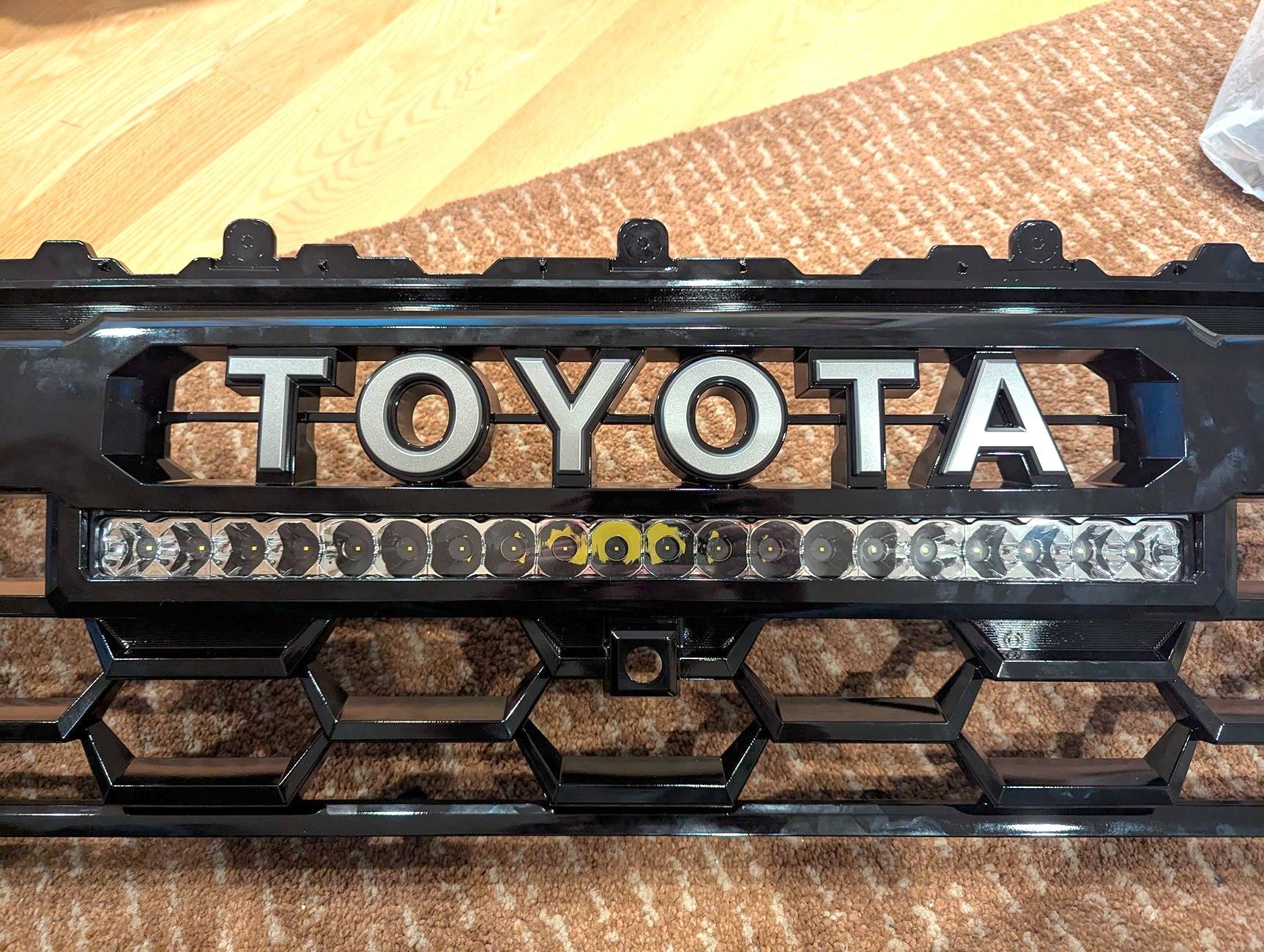

Managed to get the final revision of the camera bracket done and printed in ABS. Came out great and seems to be a perfect fit.
I got everything reinstalled and also swapped my lower bumper trim from chrome to black plastic. The piece of black trim I purchased also came with new black sensors to match the trim (as the ones that come with the chrome trim are silver) -- and apparently, they need to be calibrated to work. Hopefully there's a way to do this without a trip to the dealership......
But nonetheless, here she is, de-chromed with the black trim, TRD Pro Heritage grill, and the Heretic 20" lightbar. This was a fun project to DIY down to making all of the brackets and whatnot. I still need to the get the lightbar wired, just taped up the DT connector for now and will get around to it sometime this week.
Really happy with the result. As promised, releasing the camera bracket STEP file for free (CC-BY 4.0) here for anyone that has a 3D printer that wants to print it themselves. Print it face down and use supports for the overhangs.
