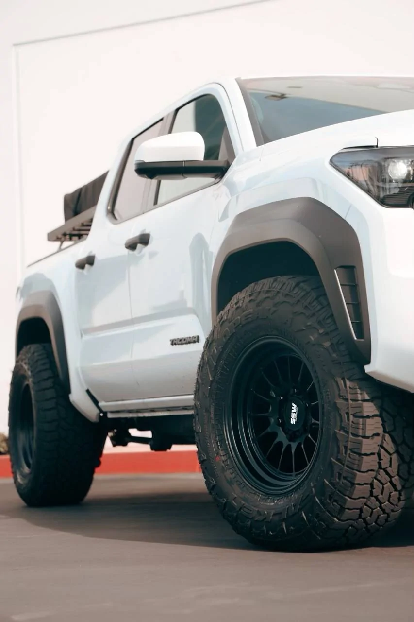

Nice truck! Do you have any pictures of your truck with the SSW wheels before the long travel kit? I really like the look of those wheels.

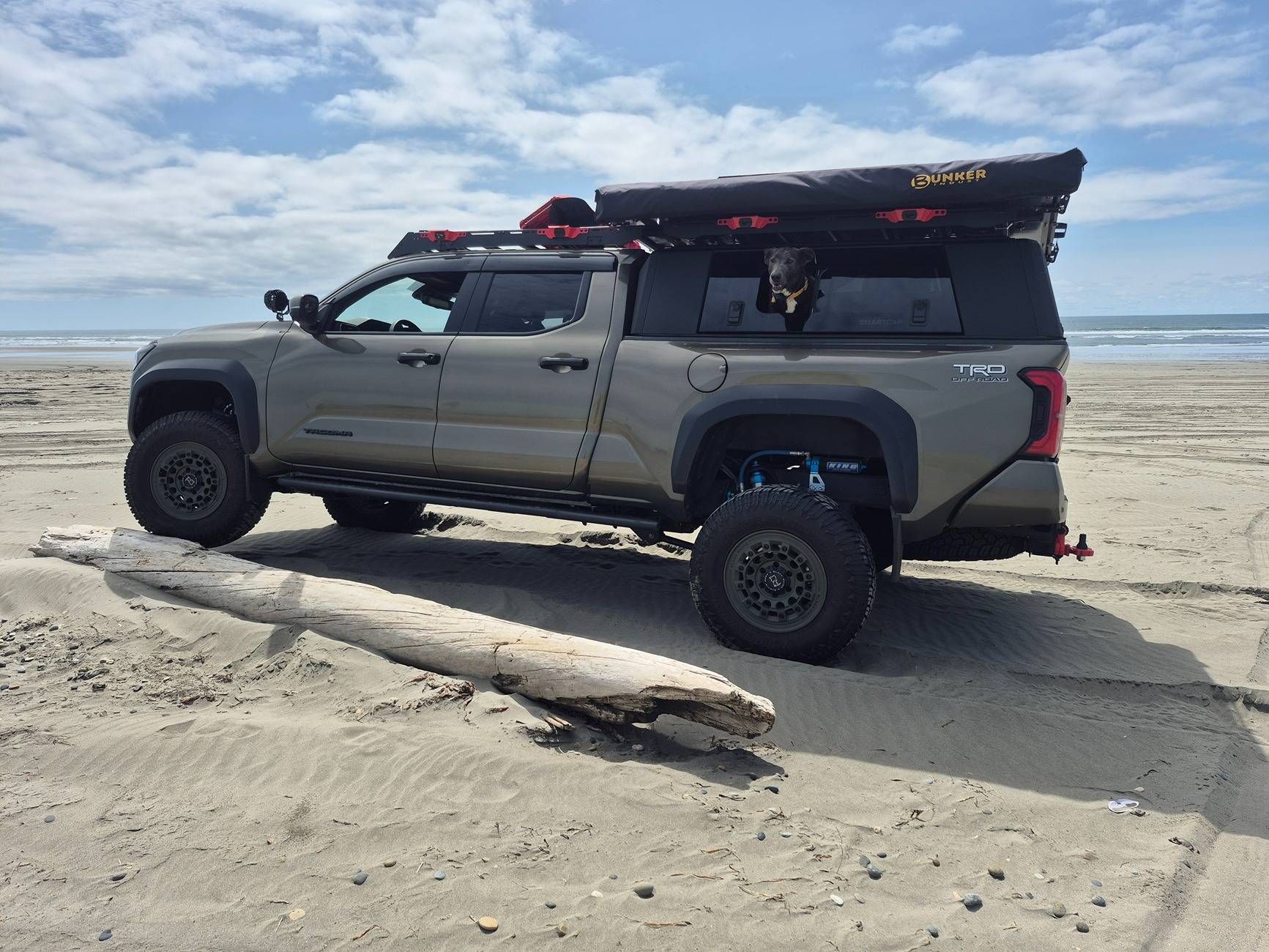

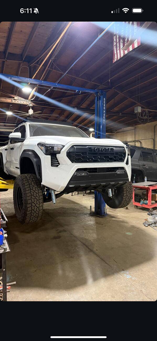

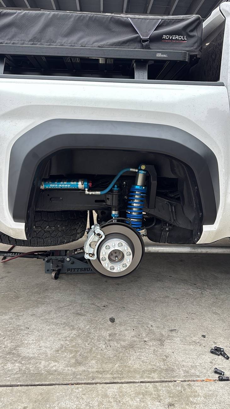

Thanks. Looks like you don’t have much room for uptravel without smashing the fenders. New fenders on the list of things to do?
That last picture is a bit deceiving because the rear is jacked up all the way from when the Toyo's were being mounted. I am waiting on the front axle shafts before going on a proper break in trip, then again once the GFC is on and the set static weight is on the rear. After that the shop will fine tune a bit more, and if needed, probably do some fender trimming (trying to keep that OEM + look and not resort to fiber glass).

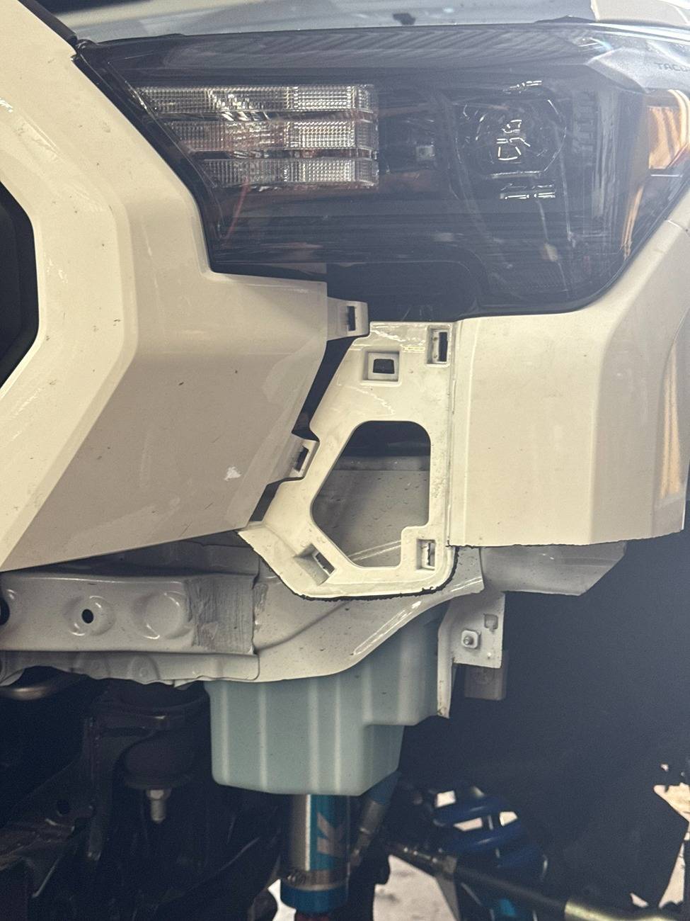

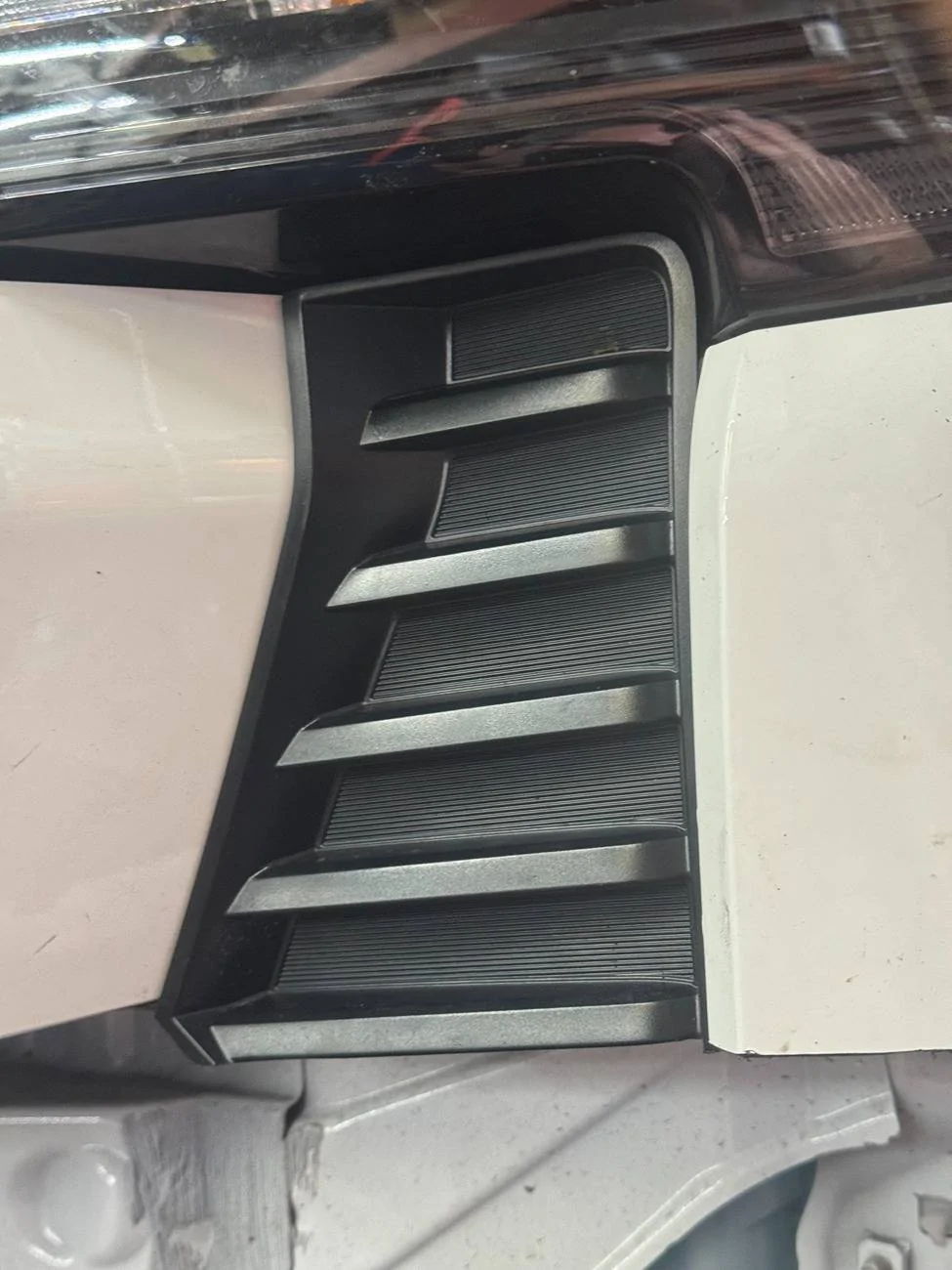

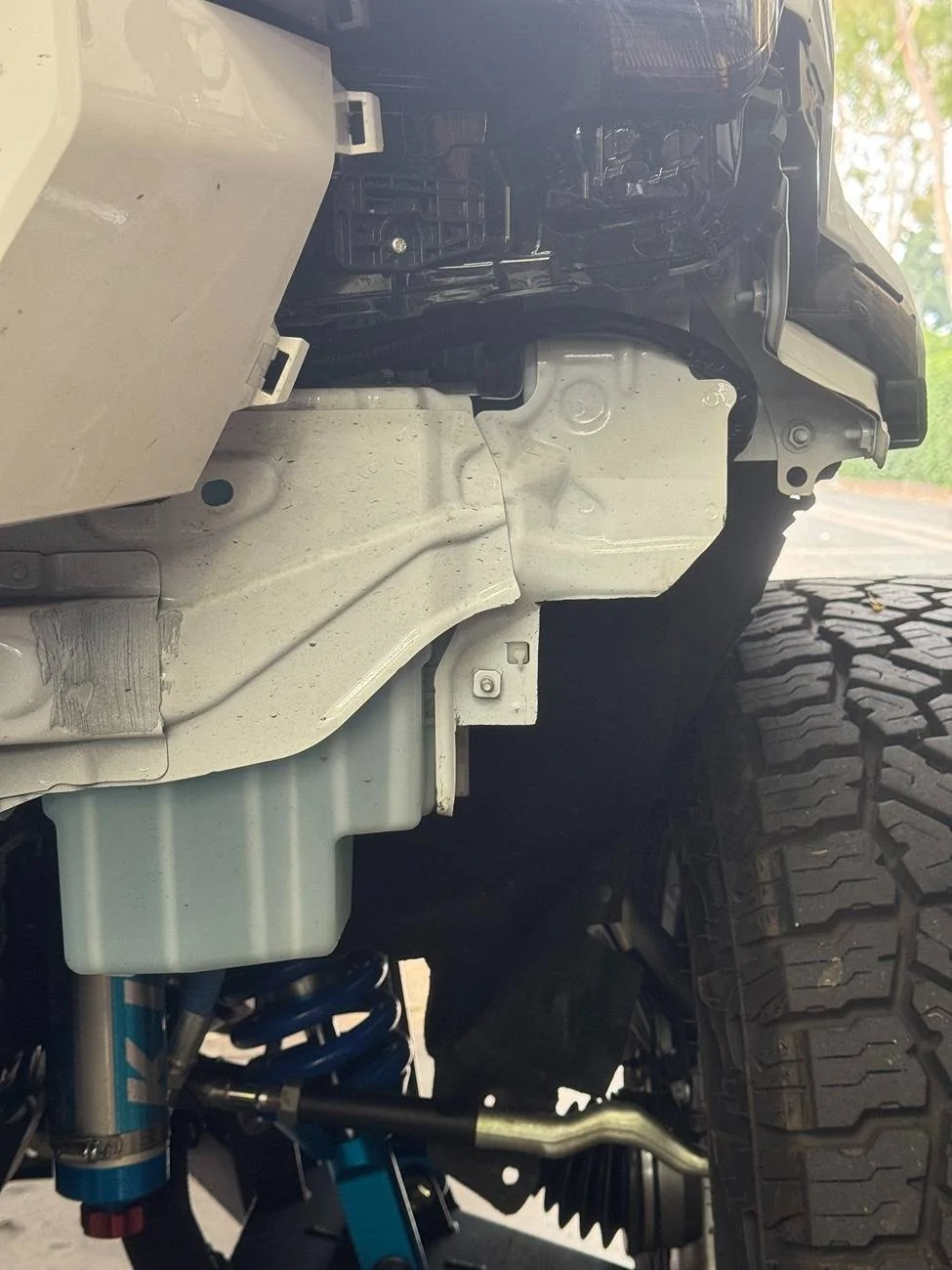

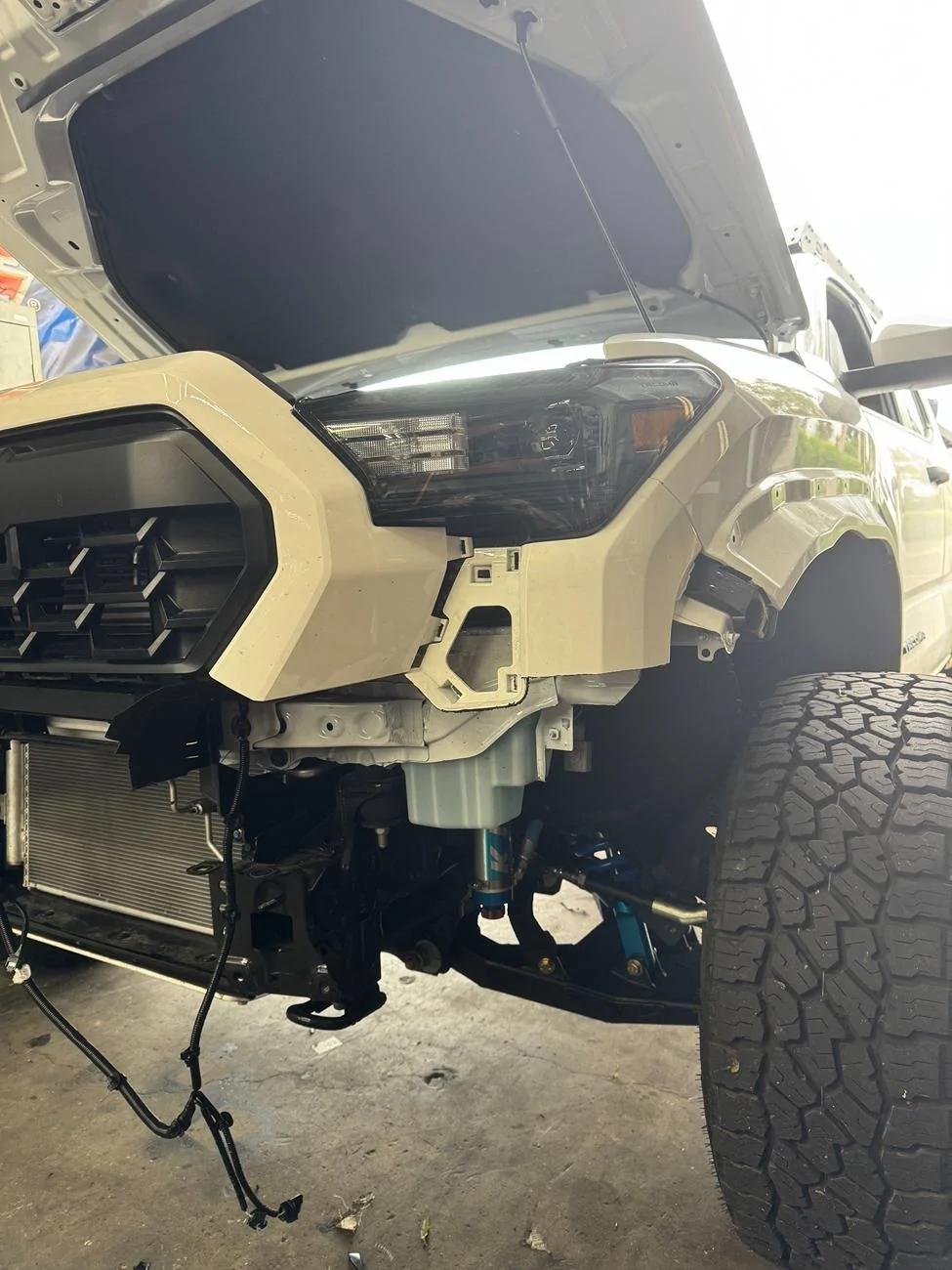

Nice choice on your lift kit. I also choose King coil over with total chaos, upper control, arms and new king droplinks.
My question is how much of a pain in the ass to chop up the front end for the bumper install, and do you still have full use of your sensors and sonar.
If you could please post some pictures of the install.
Did you regear the truck to run 35? If not deserves overheat, when you're in 4 high for any length of time..

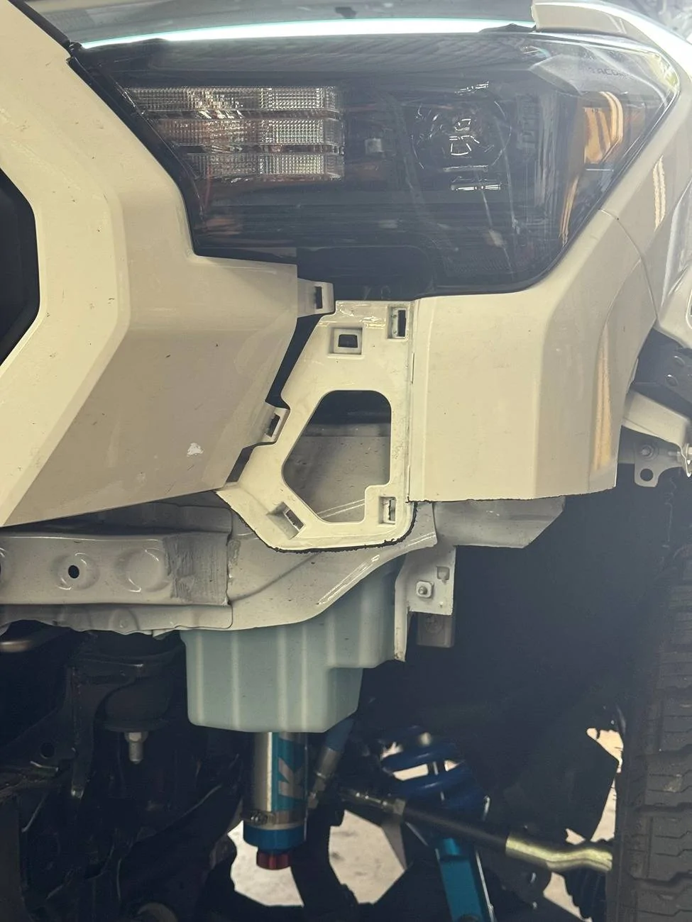

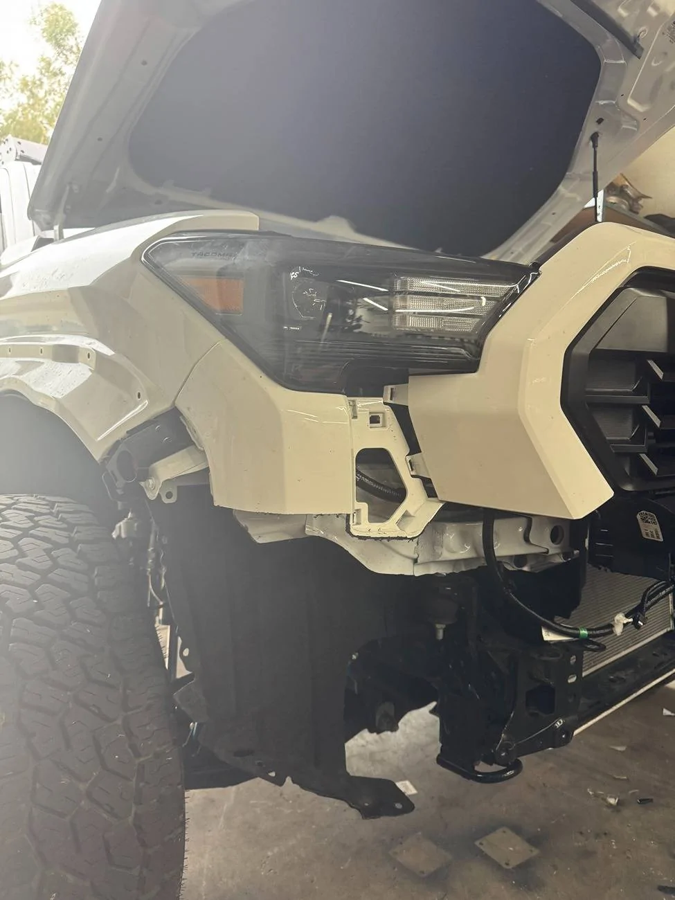

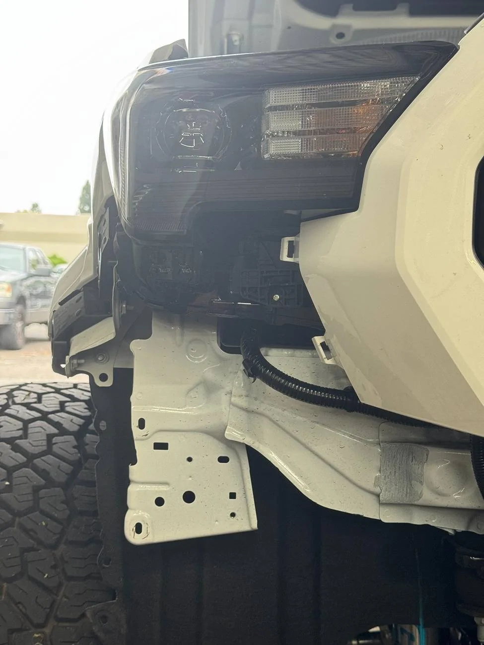

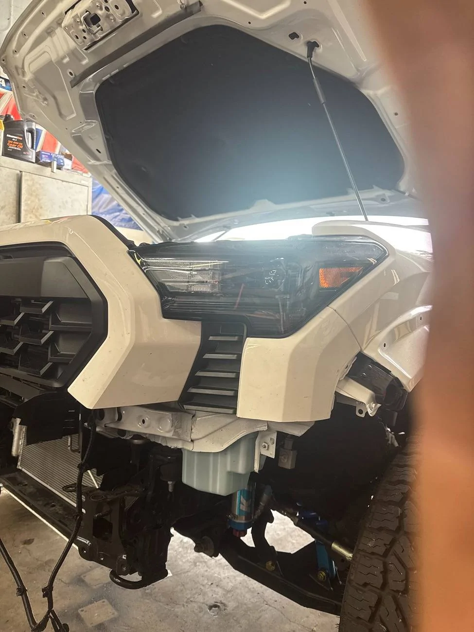

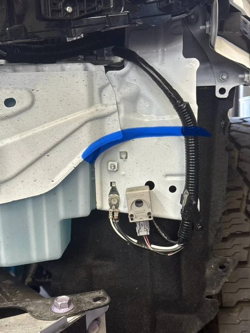

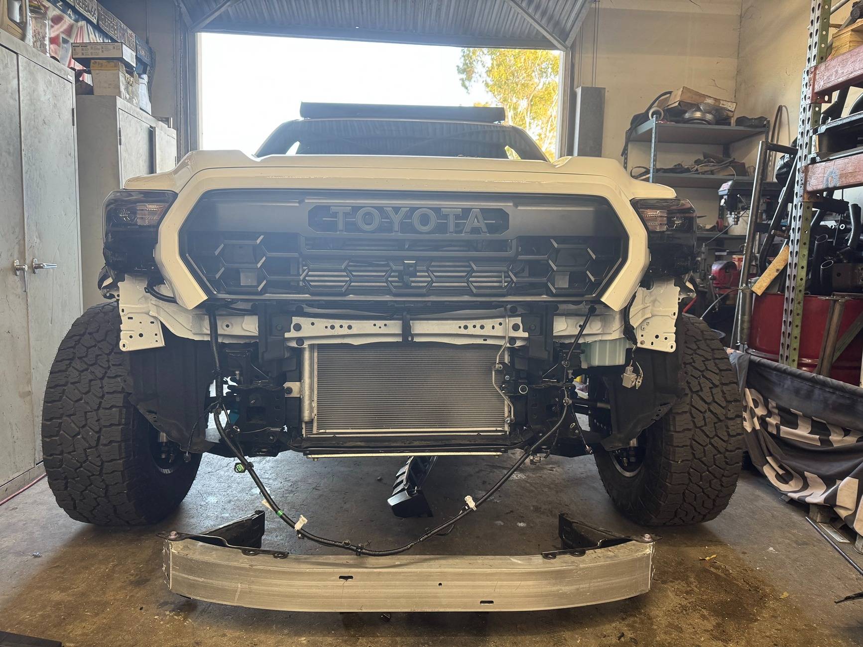

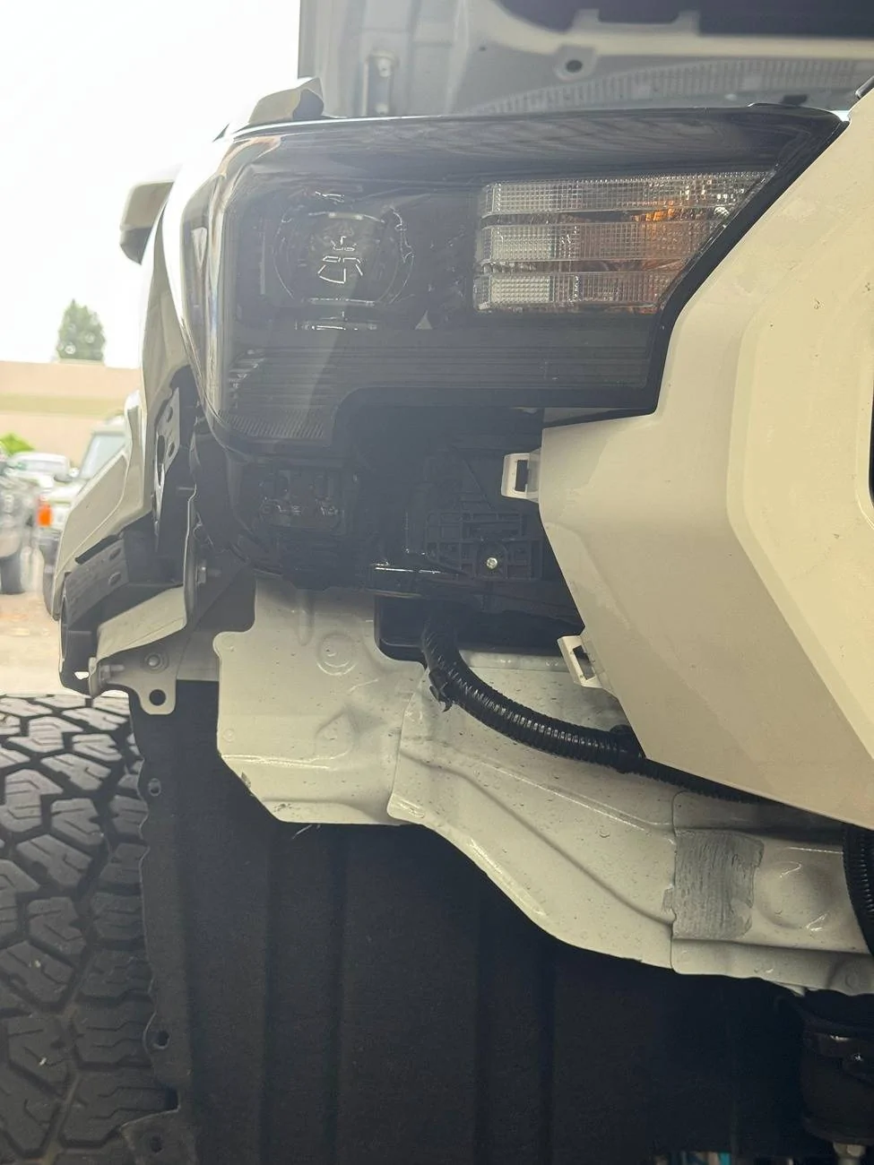

Awesome build! The front bumper took two days to install, and that's with the help of a friend. We really had to take our time, used leveling lasers, etc, to make sure it was perfect. HOWEVER, the C4 instructions are horrible. Bad pictures, missing detail on things to trim, missing hardware, and very vague instructions when it came to electrical, ambient thermostat, and parking sensors. The parking sensors are functional, but I do keep them off (I hate the warnings when I'm off road). Also, based on past experience running C4 bumpers, the adhesive doesn't quite stick as well to the C4 bumper as they did the OEM bumper. I have a few pictures to share, which I will, not sure if they'll be helpful to you. I have not geared, yet, I'm not sure if the market for that is available yet. As far as 4WD, since I'm still waiting on the front extended shafts to be installed, I haven't gotten on it yet off road. Should be towards the end of the month. I'll add bumper pictures in the next post.
