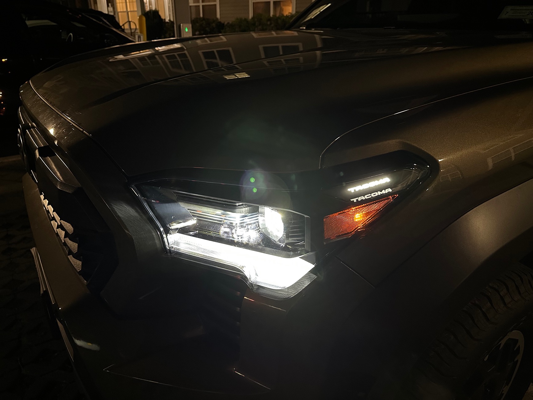

I just installed a set of oem limited headlights on my TRD Offroad Premium and everything was plug and play. All the functions work and the turn signal does a sequential fade out like it does on the limited.
I specifically wanted the Limited because it says Tacoma on the side instead of TRD Pro or Trailhunter. Makes more sense considering my truck.
The headlights only has 2 functional plugs with a dummy plug where the halogen turn signal is on the older lights. I just plugged the spare wire into the dummy plug to protect it.
Highly recommend if you can find a pair for cheap, Ive only had bad experiences with aftermarket headlights

I just realized my camara protector was cracked and made the lights show double. Ill take new pictures and upload them another day.

I got the lights off facebook marketplace. They came off a limited truck. I paid 850 for the pair; i think theyre 1200 each from toyota

How difficult was the install?
It took about 2.5 hours. I had to take off the the fenders and whole front bumper. I dont think it was very difficult, it just takes some patience. I did need another person to take off the front bumper though.
Alpharex had a guide on how to remove the front bumper and headlights in their installation instructions of their headlights. I followed that
Yeah thats a good deal. I have a buddy who is wanting to do the same.
That's a steal for those lights. I'm surprised it's plug and play. These days every feature seems unique to a particular trim package and will not work if you install it into another trim.
Thats what I keep telling my wife 😂.
Definitely worth the price. Though the passanger head light had one broken tab. It still feels pretty solid on the car. Its held on by 3/4 of the bolts pretty well.
