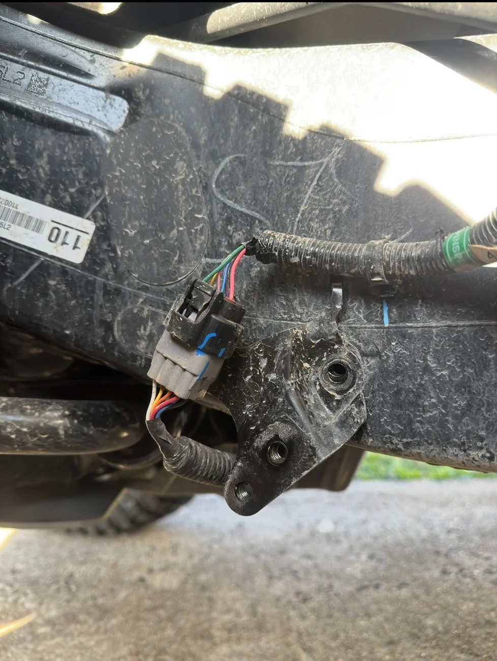

I'll preface this by saying if you're doing 35's & below you probably won't need to do this, but I'm not sure. I don't think it'll hurt to do either way. After a little bit of trimming I was able to fit some 37x12.5R17 +25s on my 2025 TRD Pro 4GT. The only place I was rubbing at full lock during on-road driving was on the driver-side wheel well. After a quick inspection, I realized I was rubbing on that bracket.
2024 Tacoma How to: Relocate Sway Bar Disconnect Harness to Fit Larger Tires on a 4th Gen Tacoma (DIY writeup) IMG_1415
I looked around, and the only person I saw who had relocated it was Talon Sei on YouTube. He didn’t really give a how-to—he only showed the after. I decided to give you guys a quick walkthrough of what I did to relocate it. I’m sure there may be better ways to do this, but this is how I did it.

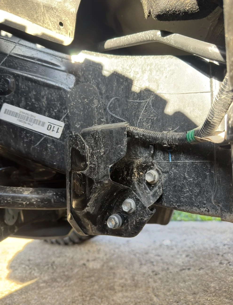

First, you’re going to want to remove the three 12mm bolts that hold the bracket up. Two of them hold the front plate up, and the third holds the plate to the frame.

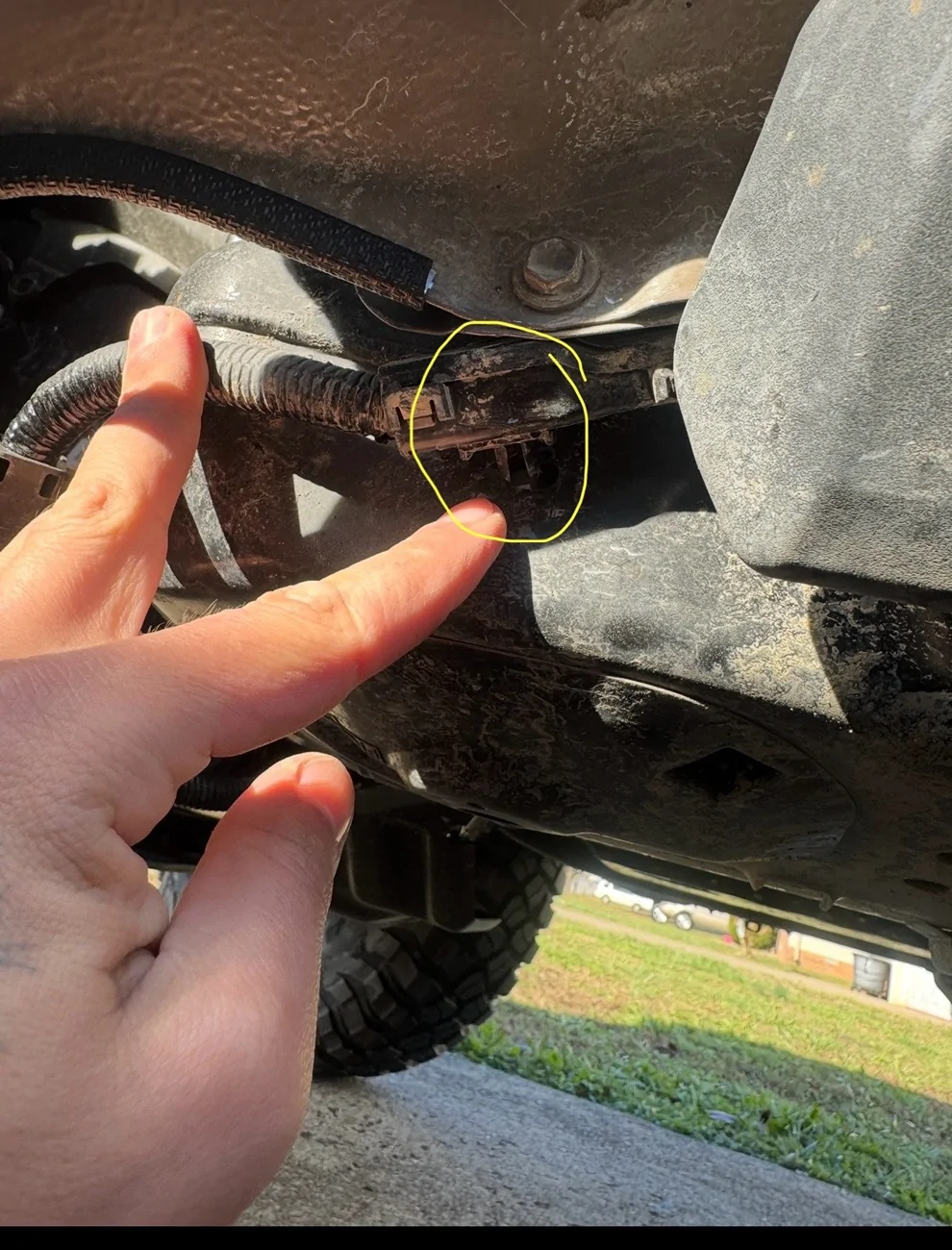

2024 Tacoma How to: Relocate Sway Bar Disconnect Harness to Fit Larger Tires on a 4th Gen Tacoma (DIY writeup) IMG_1439

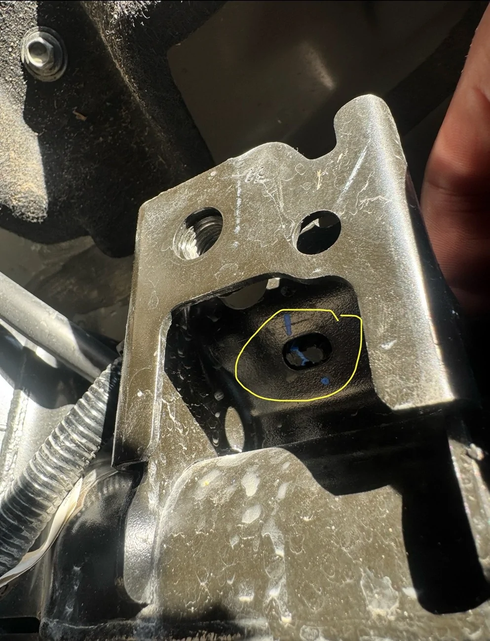

Once removed, go ahead and undo the grey and black harness. The black harness will only be attached by a clip where the blue line is in the photo above. Go ahead and just pop it out.
2024 Tacoma How to: Relocate Sway Bar Disconnect Harness to Fit Larger Tires on a 4th Gen Tacoma (DIY writeup) IMG_1440

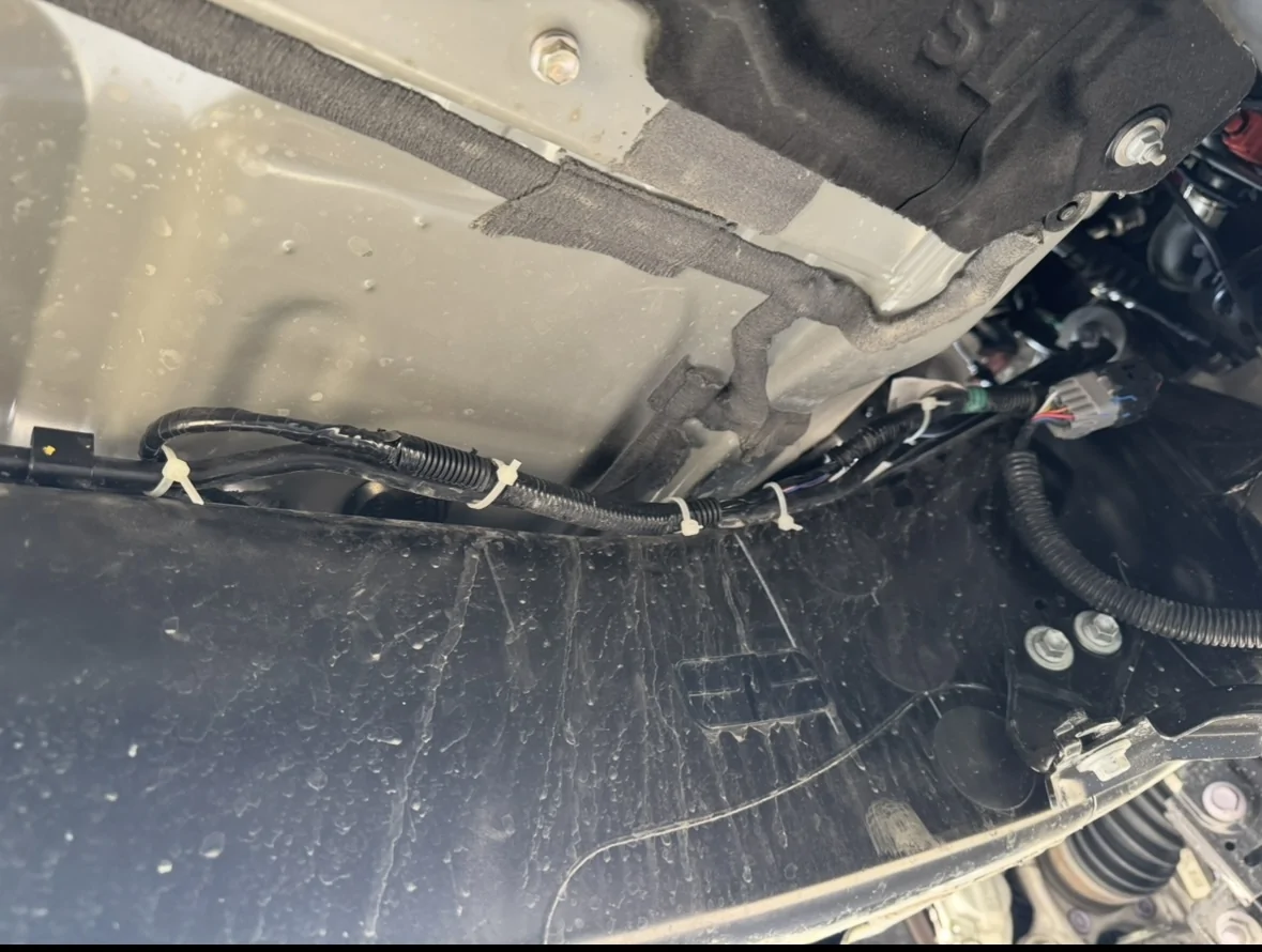

Next, you will pop out the clip that’s at the very back of your wheel well.
2024 Tacoma How to: Relocate Sway Bar Disconnect Harness to Fit Larger Tires on a 4th Gen Tacoma (DIY writeup) IMG_1441
Keep tracing the wiring until there are one or two more clips to undo. I believe it’s two.
2024 Tacoma How to: Relocate Sway Bar Disconnect Harness to Fit Larger Tires on a 4th Gen Tacoma (DIY writeup) IMG_1442
2024 Tacoma How to: Relocate Sway Bar Disconnect Harness to Fit Larger Tires on a 4th Gen Tacoma (DIY writeup) IMG_1443

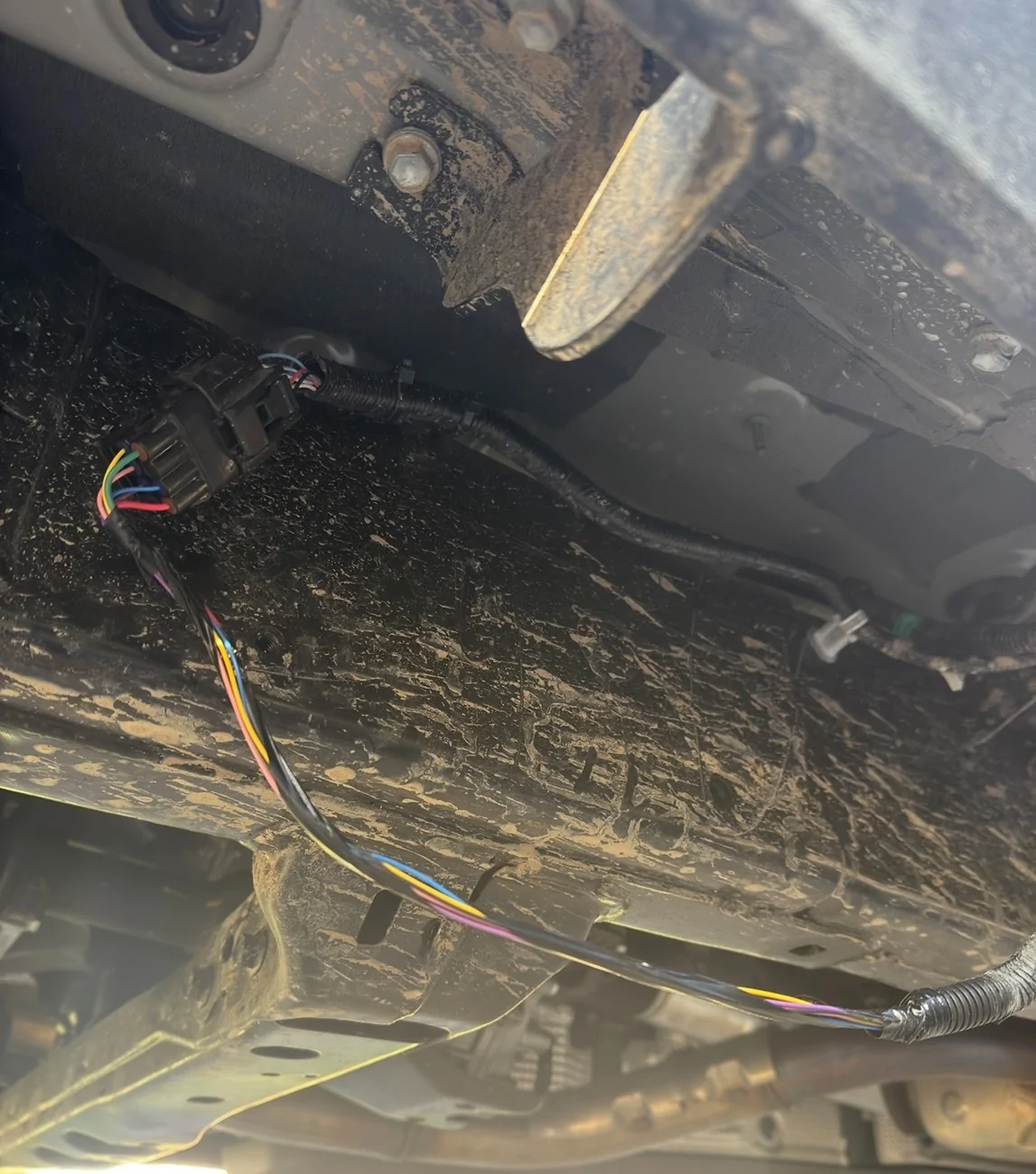

Now you will have enough of the wiring free to move it behind the cab mount and over the frame.

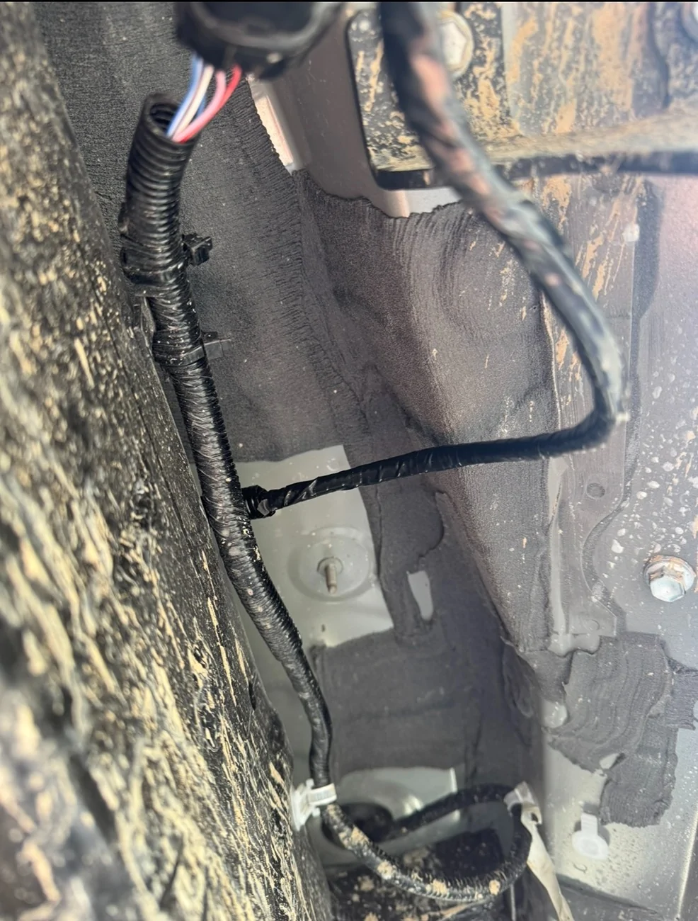

The wiring will be encased in a plastic cover. I was able to get it over the frame and place it where I wanted it, but it caused the end of the wiring to sit at a crazy angle, and it looked like it was putting a lot of stress on the wires. I opted to remove the plastic and wrap the entire section in electrical tape.

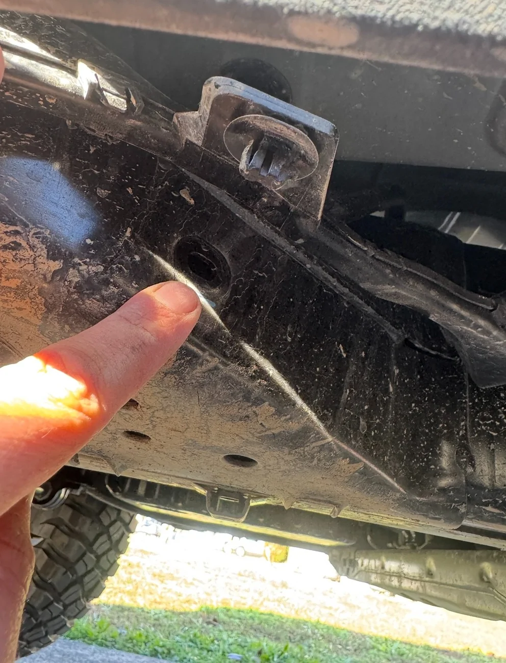

2024 Tacoma How to: Relocate Sway Bar Disconnect Harness to Fit Larger Tires on a 4th Gen Tacoma (DIY writeup) IMG_1444
Once I taped up the wires shown above, I ran the full length of them over the area shown below. It's easiest to get it through right in front of the bolt sticking down and then run it forward along the cab.
2024 Tacoma How to: Relocate Sway Bar Disconnect Harness to Fit Larger Tires on a 4th Gen Tacoma (DIY writeup) IMG_0324
Once that was complete, I just reattached the two main harnesses and zip-tied them down. It’s pretty easy to relocate. The plastic bracket covering the harness on the body is kind of a pain to undo—I ended up just breaking it off. I’m sure if you had more patience, you could find a better way to keep it functional, but I don’t think it’ll be needed.

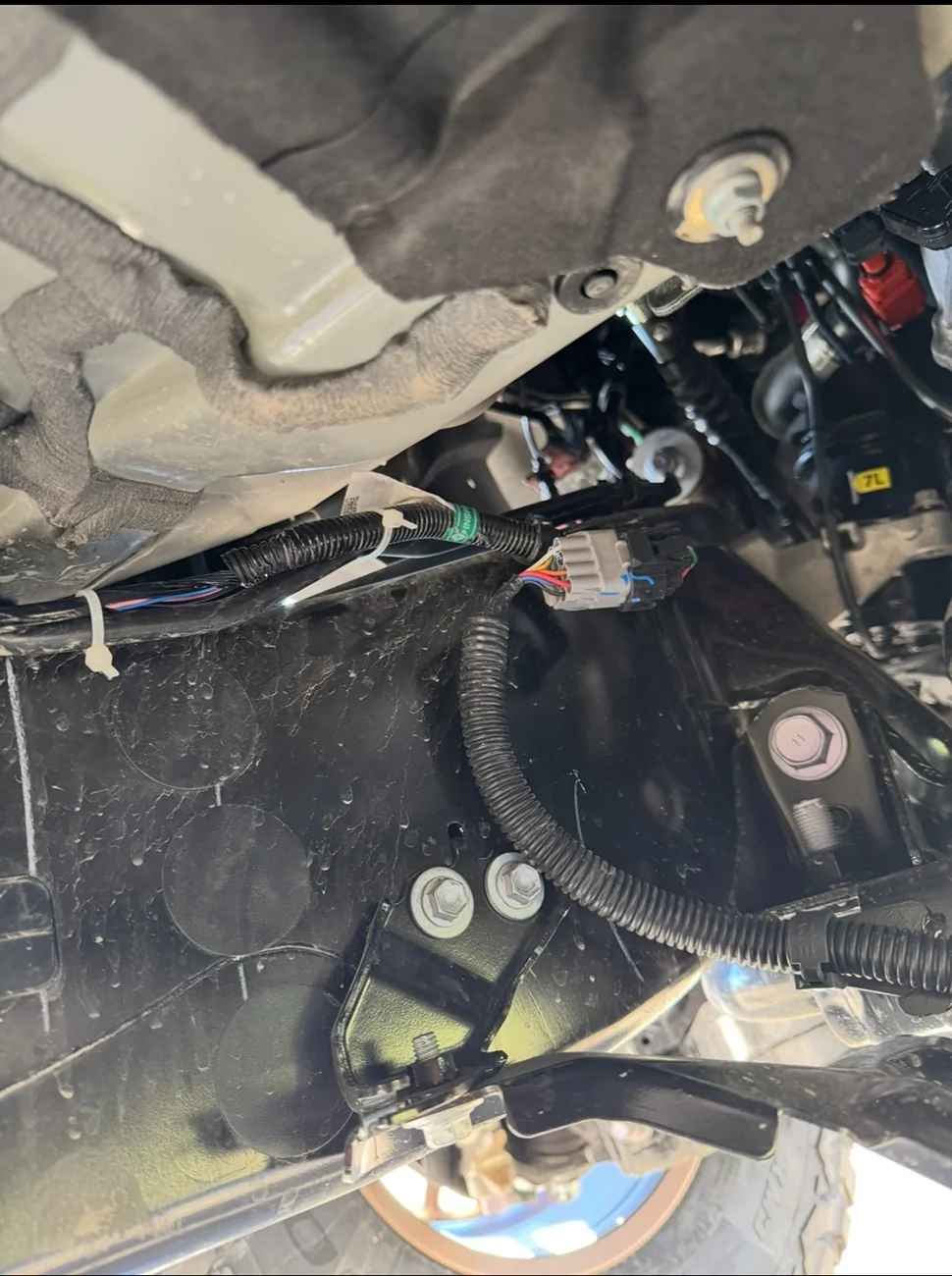

looks like the way you moved it may be less work, but keeps it right behind the main bracket in the wheel well.
I’m unsure if I’m going to that top bracket off in the future when I cycle the suspension so I routed it a bit further back
