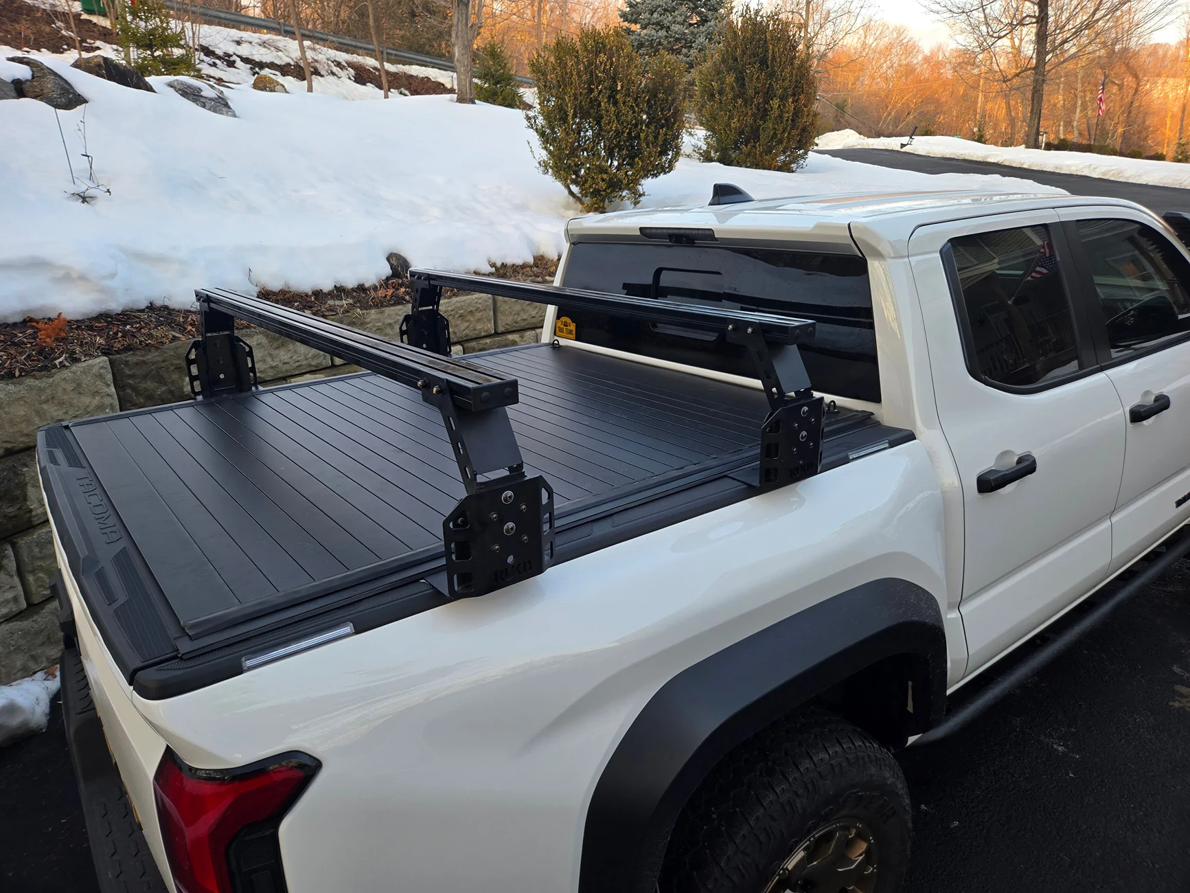

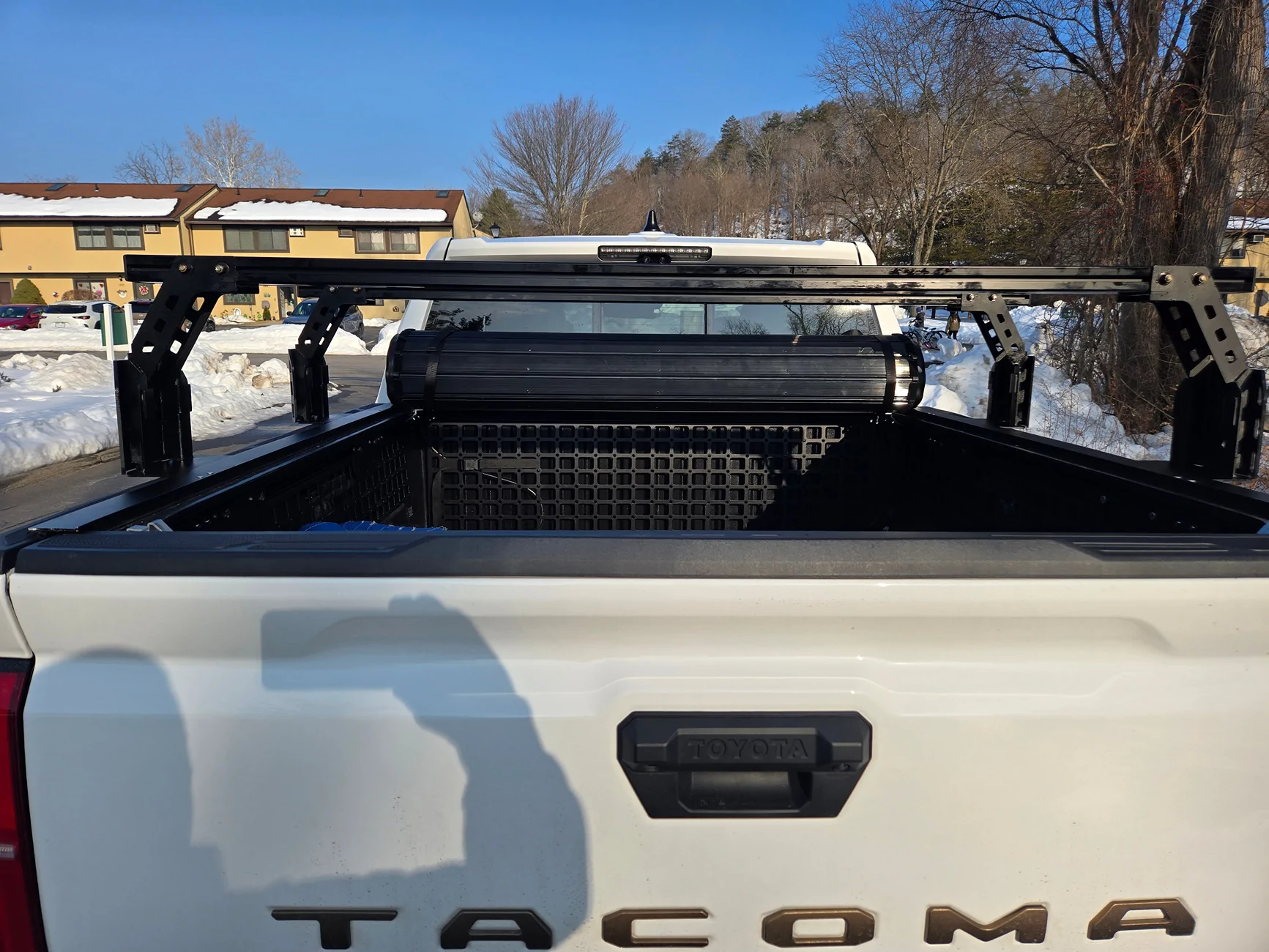

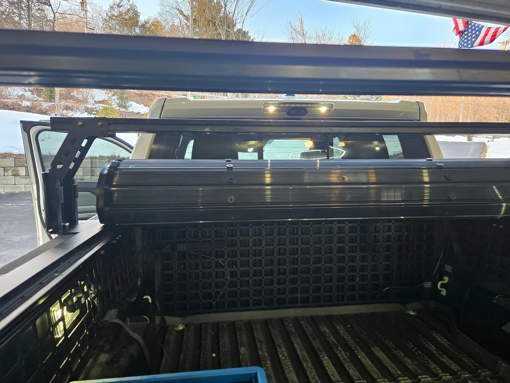

Wanted to share the combo that I finally figure out to work. I didn't see any info on this combo.
I wanted a cover to deter any prying hands from the bed, And still run a rack for my RTT and bike racks on the rails when the tent is not on the rack.
The combo is the following-
Rough Country hardroll With a TRUKD T Series 12.5" Bed Rack
The RC hardroll is mint...It does take some time to align and alot of adjustment to get perfect. Haven't had any issues.
Every few weeks I follow up with making any adjust again and go around tightening everything up.
I just picked up this mid rise bed rack for my rooftop tent. I wanted a mid rise as I didn't want the tent to hang too much over the front cab.
If I do need more height I will get replacement side rails to bring the height up.
I have enclosed a pic of the hardroll clearance at both the front and rear rail points.
Enjoy.
Enjoy.

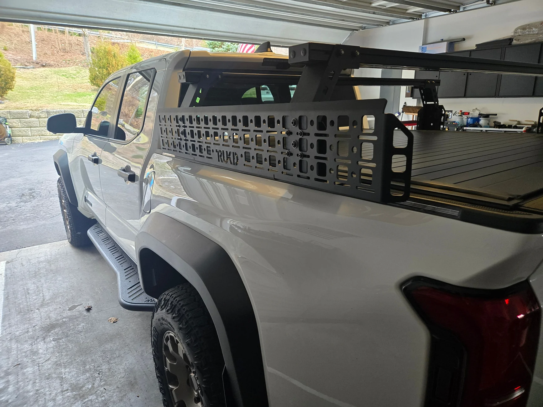

Added a TRUKD V2 6.5" Accessory Panel.
2024 Tacoma Rough Country hard roll up bed cover WITH TRUKD T Series 12.5" Bed Rack 20260314_093638
