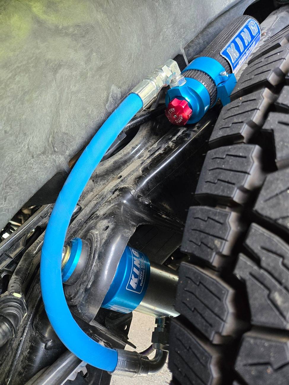

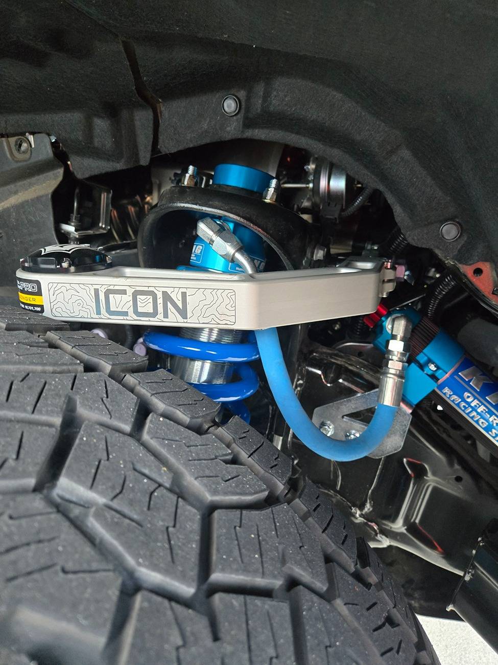

I don't have collars.
I have the king 2.5 king suspension. Only thing is I don't have the front sway bar links and the suspension was set at 2 1/4 height.
Thoughts ? What is your suspensions set at ?

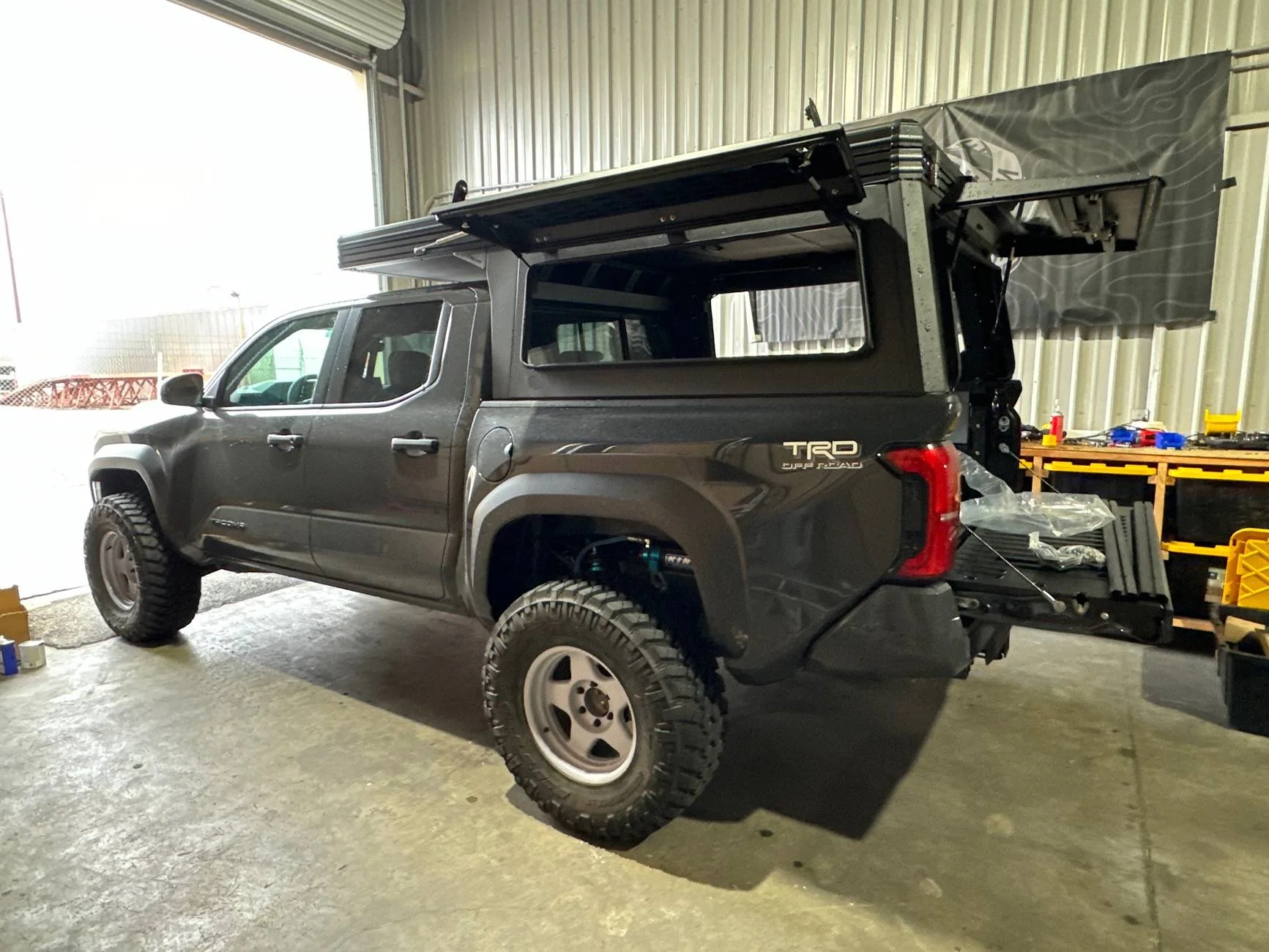

some of us went a little higher and a stiffer spring rate with the tundra rear springs ? but I also agree. Take the preload down and that popping will go away
I myself went with C59-819V from Dobinons. I netted 2.25” of lift in the rear and have 400lbs in the bed right now.
Is that a smart cap? I just ordered one. Reason why I went with the tundra 1.5” springs. It also gave me about 2.25” in the rear.

So you should have the sway bar links I don’t even think they would sell me the king shocks without buying the sway bar links. I don’t quite know what the are set up at but I know when I had the preload collar adjusted too low I would get a popping up and down on full lock turns
I just installed the front links this past weekend. And it's still popping.
Did yours stop ?
Went to yhe stop today and took the preload off to no preload. And it's still popping.
Called King and they said to bring it in so they can inspect it and make sure the shop didn't do something wrong

Any weird noises when entering a steep driveway at around full lock of steering ?
