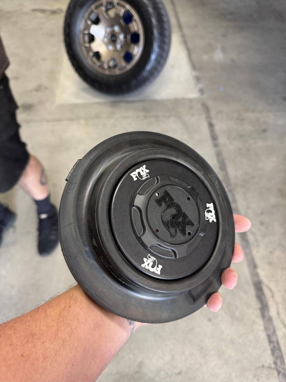

@Peak Suspension Does your team have any photos of the top mount spacer from the top prior to the assembly installed onto a truck?
I ask because I'm curious if this spacer would inherently act as both a lift, and way to support/brace the OE top hat from failing due to the design of the cast "cap" retaining the upper shock bushing.
Entertaining the idea (if its necessary to prevent top hat failures) of running the Peak rear spacers (1" lift), front lower spring spacer (1" lift), and a TheTacoGarage billet strut reinforcement plate (1" lift).
On paper that would result in a 2" lift in the front and a 1" lift at the rear.

I just need a small front lift and think this is the ticket. does the 1 inch top spacer require the top hat be removed from the strut or does it just simply fit on top? If I’m seeing this right it’s the easy way to go.
It installs right on top of the strut
