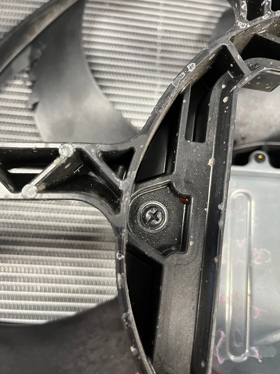

That’s for the fan shroud to mount on the radiator
Yea all the other parts are non serviceable. You can't repair just the fan or buy the hardware for the motor. If those parts are your concern then it is a non issue. There have been no failures related to hardware used, so Toyota won't fix it or issue a recall in that case.

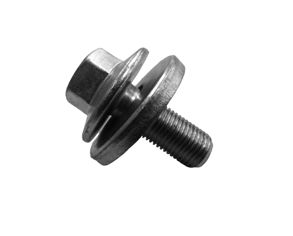

So I just took one of the screws out of mine real quick to get a better look at what you are talking about. The bolt has a flat flange head and that flange is larger than the hole it threads into. There really isn't any reason to believe this will be a point of failure. I have seen many vehicles do this before and this has never been a point of failure. If it is a concern for you, than yea absolutely put a washer on it, if that makes you feel more comfortable, but this is not something that HAS to be addressed.

Hasn't there been enough people that have bashed around 4Gs offroad that if this was a real issue it would be known by now?
If you go crashing into shit and you break your fan shroud, well, oops I guess.
But we bounced off the skid plate yesterday (ie zero suspension) and my fan shroud is very much in the same place it was when I opened the hood of the truck for the first time :cwl:
