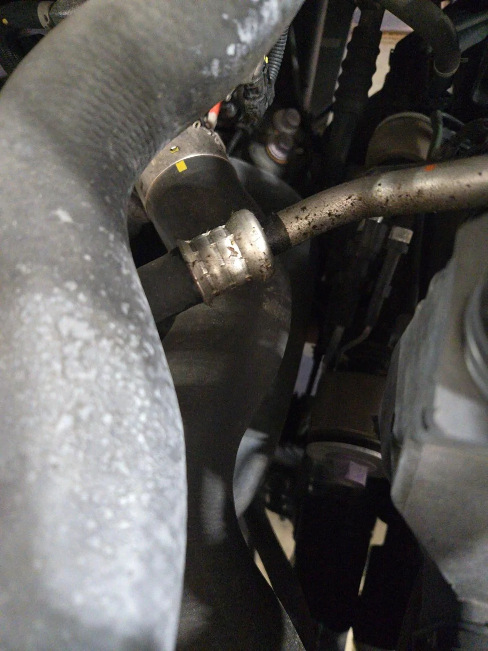

Notes from the service tech -
" NON RUNNING PRESSURES ARE EQUAL AT 80 PSI LOW BUT EQUAL. WHILE RUNNING THE LOW SIDE IS 0 HIGH SIDE IS 100. LOW SIDE LINE METAL TO FUBBER CRIMP IS WET AND LEAKING VISBALLY OIL FROM THE A/C SYSTEM. CHARGED PULLED FROM VEHICLE WAS .290 KG SPEC IS .530KG"
