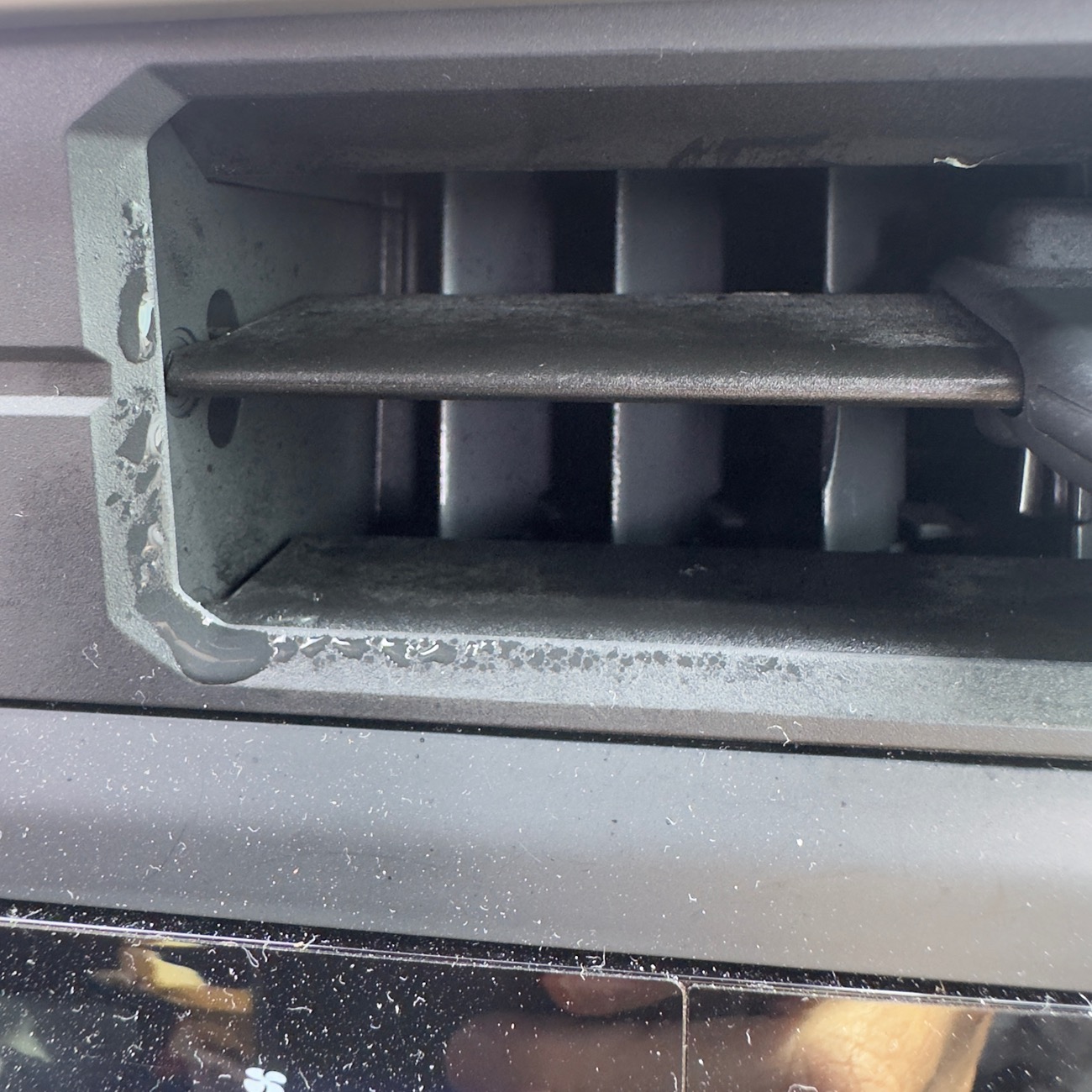

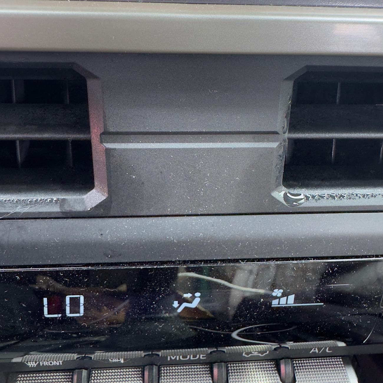

Has anyone experienced issues with their ac having moisture/condensation build up in the 2 main vents below screen? Just happens when ac is either on low or high. I already checked the drain hose and pipe all cleared

So you're seeing condensation in your actual vents that are beside the infotainment screen?

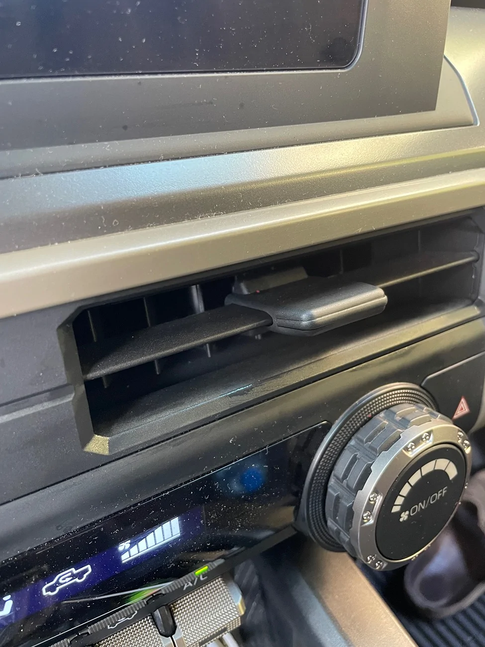

Yes. I just got my 2025 last week. I felt a drop on my foot while driving with sandals. Checked all the vents and sure enough condensation on all of them. I didn’t even have the ac button clicked on. The air blows so cold even when set at 70 degrees. I’m honestly concerned it might be always on or something idk. I didn’t feel the need to look into it honestly. Better blowing cold than warm if. Also I live in Michigan and it doesn’t get much passed 85. Obviously warmer when baking in the sun

That would be condensation. Had it last week in MN when it was hot. Normal on hot days.

update! I took it in for the brake line recall and also had it inspected. tech stated " that it has been a bit hot and humid in socal that's its normal." also check drain line, hoses and leaks everything looked fine.
personally myself a bit concerning for a brand new vehicle. my daily bucket doesn't even do that.
