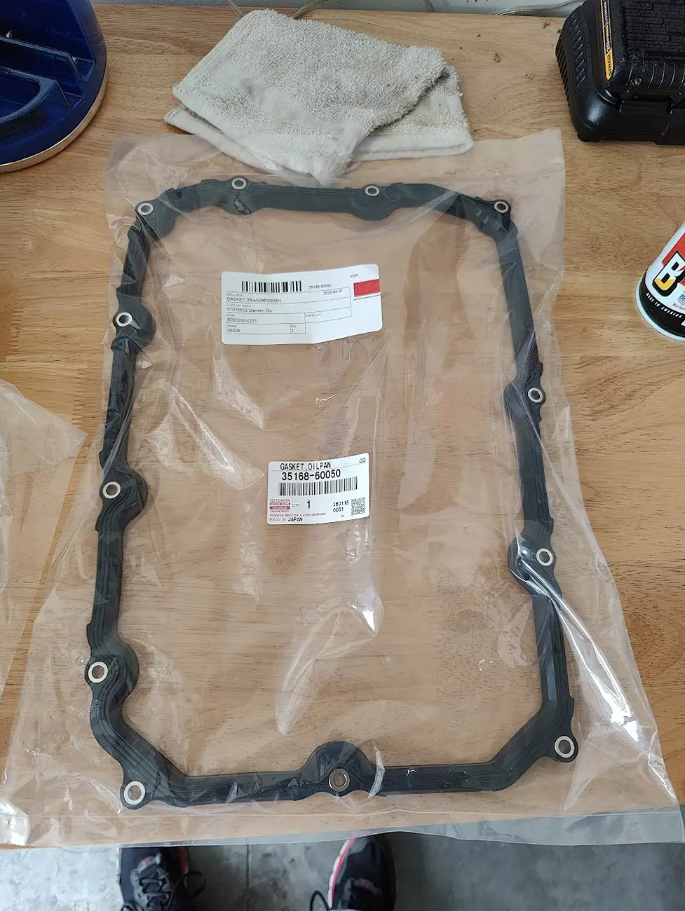

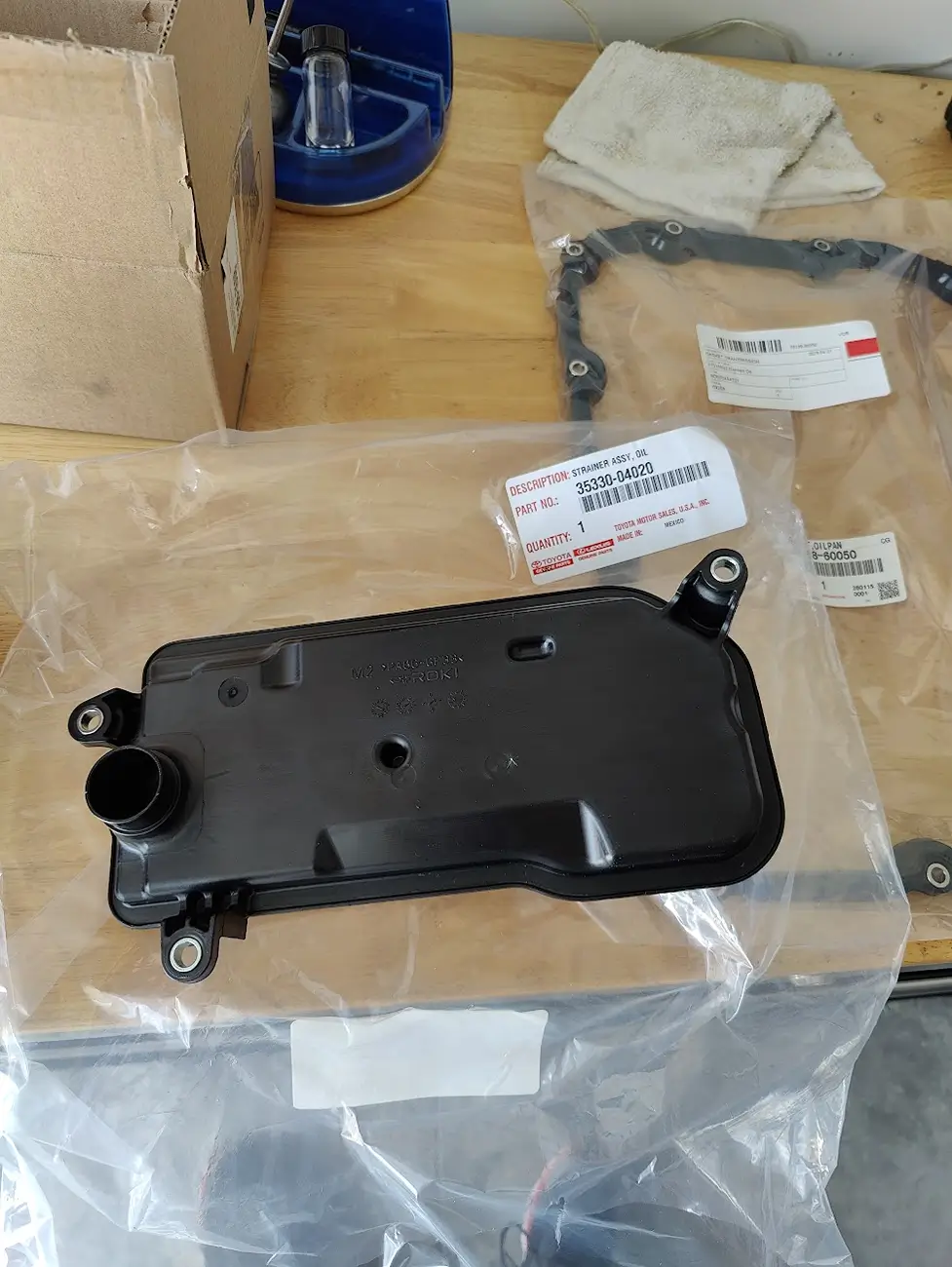

Transmission filter; part # 35330-04020
Transmission pan gasket; part # 35168-60050

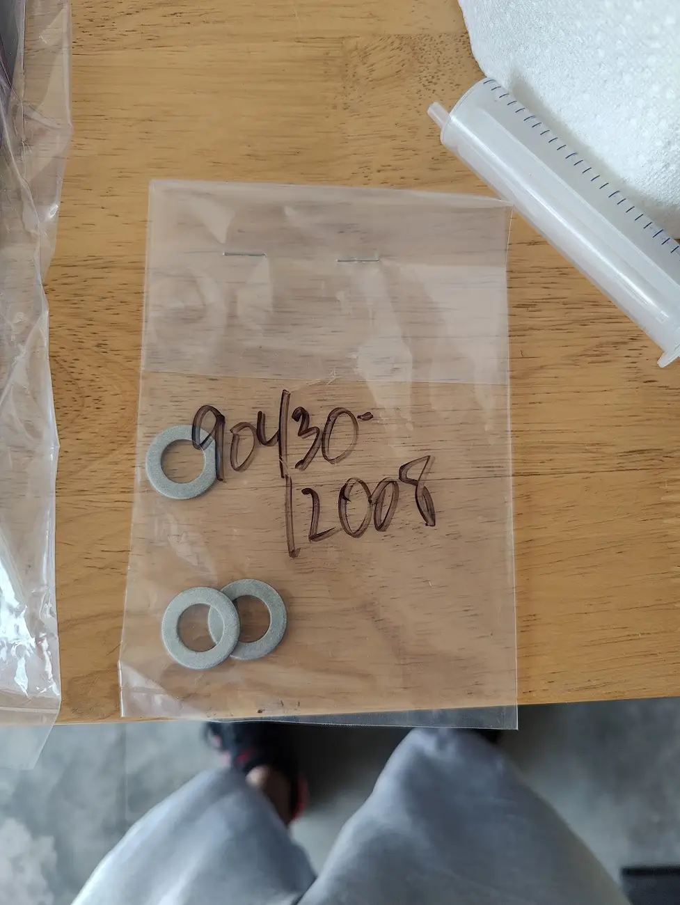

Transmission fill plug gasket; part # 90430-12008
Transmission fluid; at least 3.5 gallons (at least 14 quarts)
2024 Tacoma 4th Gen Tacoma Full Transmission Service DIY: Pan Drop 1777260025773-kf
2024 Tacoma 4th Gen Tacoma Full Transmission Service DIY: Pan Drop 1777260053084-fl
2024 Tacoma 4th Gen Tacoma Full Transmission Service DIY: Pan Drop 1777260179473-8

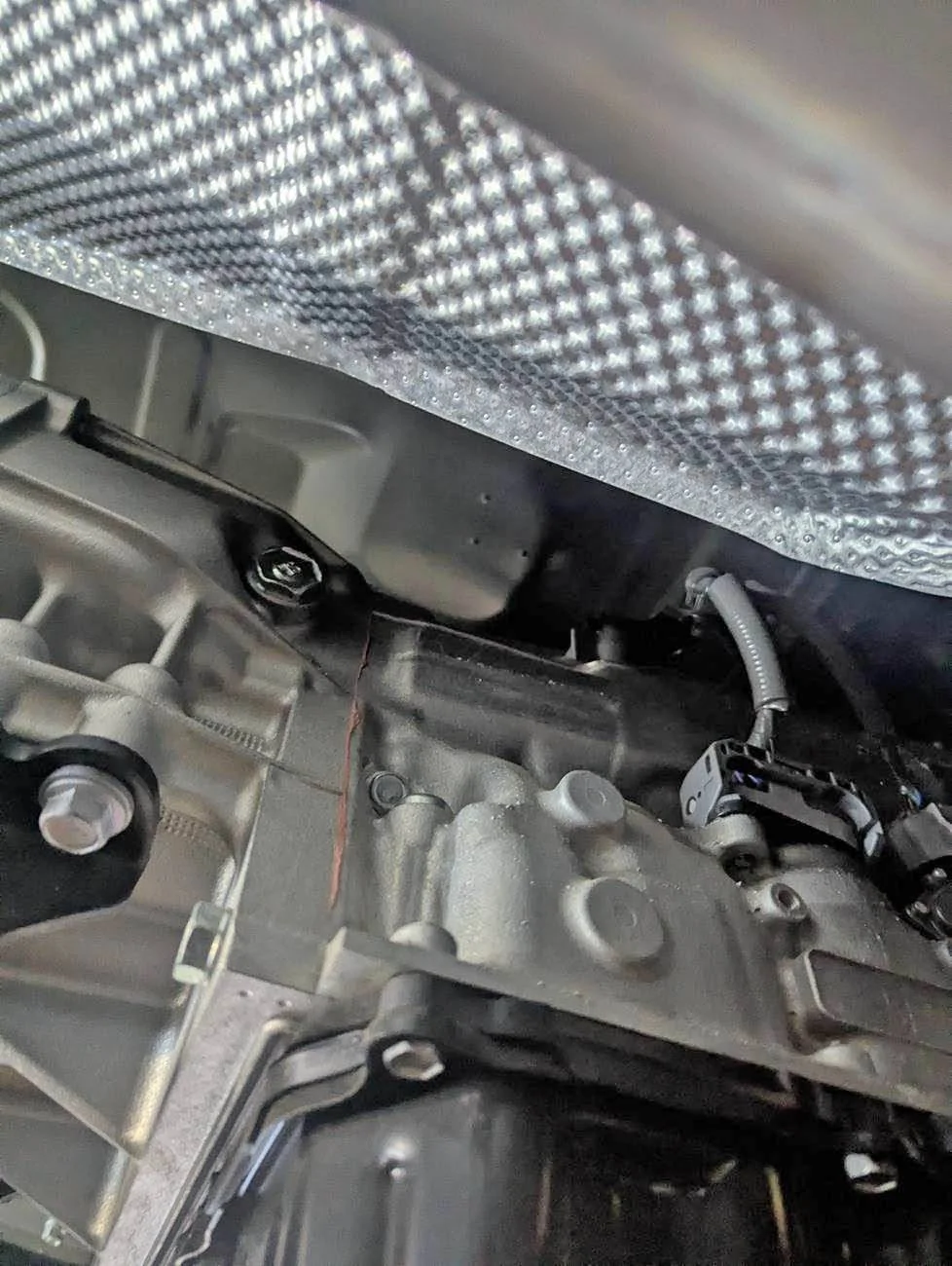

Get your transmission warmed up but not too hot to where the fluid is going to burn the hell out of you.

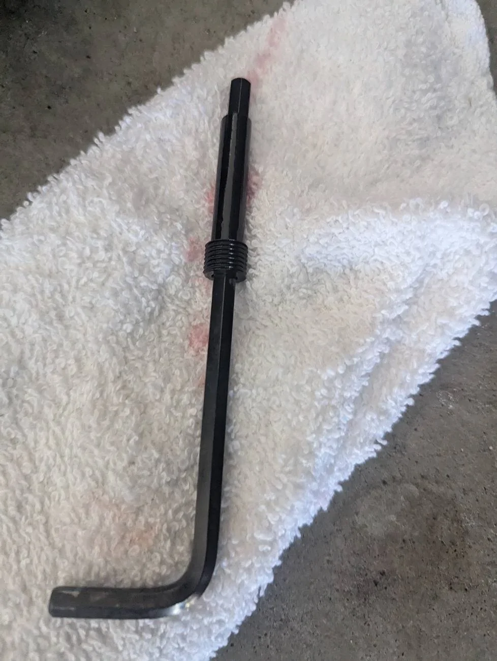

Use a 24 mm socket to remove the fill plug first. Use a 6 mm hex socket to remove the drain plug and allow the fluid to drain until is trickling from the internal “standpipe”. Once it’s trickling use a standard 6 mm Allen wrench to remove the standpipe. You will most likely get filthy doing this job, FYI. This will drain most of the fluid from the pan. Photo Cred 559Taco
2024 Tacoma 4th Gen Tacoma Full Transmission Service DIY: Pan Drop 1777259284018-k
2024 Tacoma 4th Gen Tacoma Full Transmission Service DIY: Pan Drop 1777259414055-el

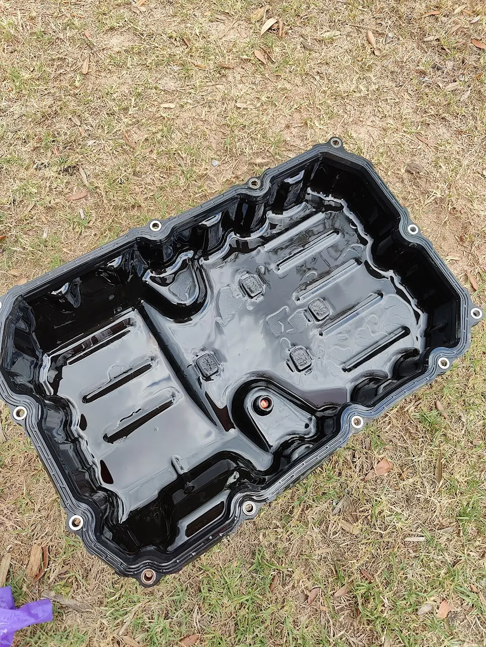

Remove the 10 mm bolts surrounding the pan. ¼” rachet is all you’ll need. The bolts are not tight. If you live in the north with salt, you may want to spray the top of the bolts a few days beforehand with PB blaster and let them soak. Most of the bolts are not captive so you can spray the top threads and let it soak down in. Remember that these are steel bolts in an aluminum trans housing so BE DILIGENT and ensure not to use too much force if bolts are being stubborn. I used to live in PA so I know how bad it can get. This truck has only seen the south and no ocean water so working on it is very forgiving.
2024 Tacoma 4th Gen Tacoma Full Transmission Service DIY: Pan Drop 1777259338980-z9
Be warned that the pan separated from the housing VERY EASILY so don’t make my mistake and let it fall into my catch pan and throw a quart or two of fluid all over the driveway. Shout out to my lovely girlfriend that sopped up the fluid as I was completing the job.

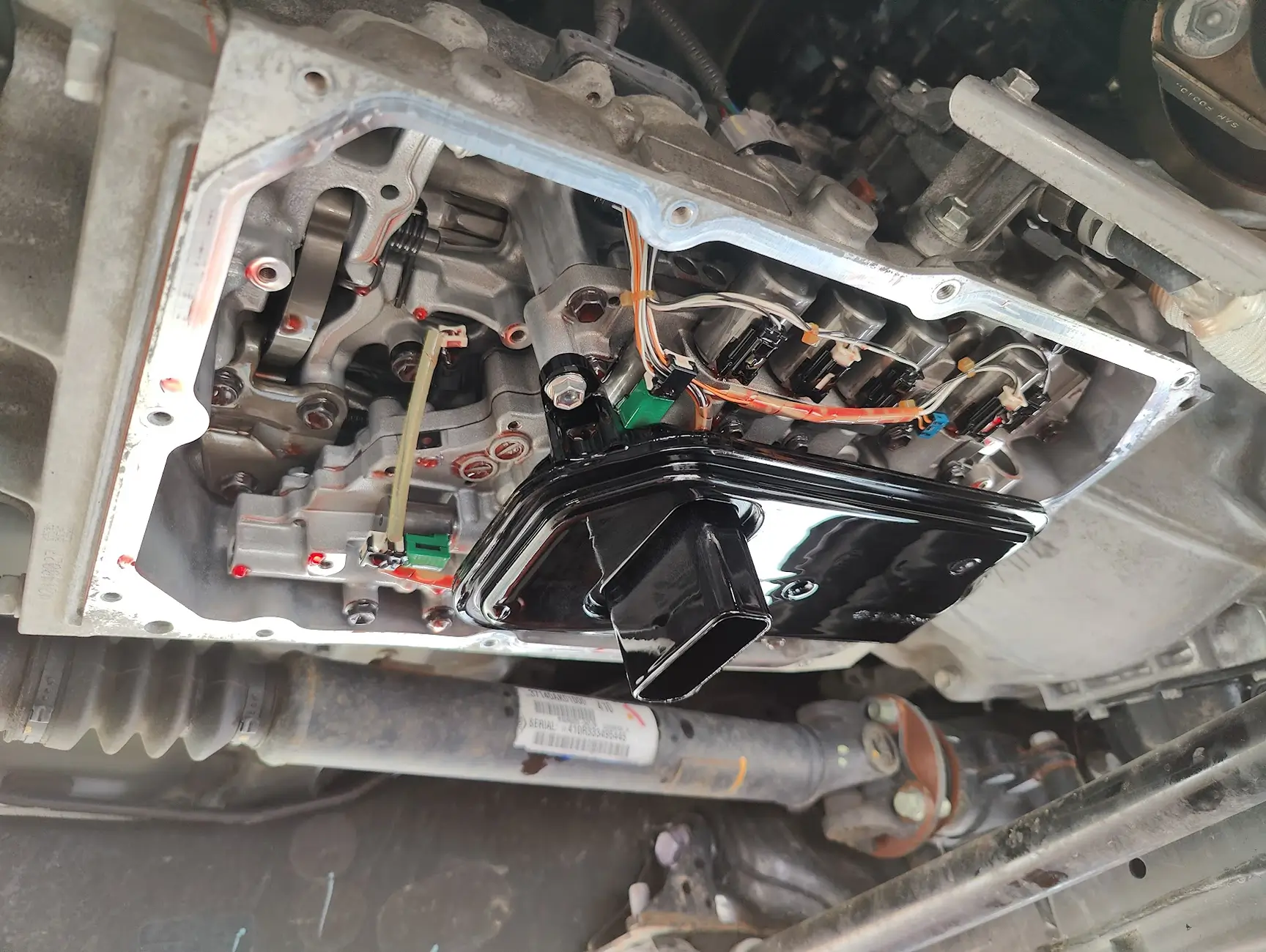

Once the pan is off, the filter can be removed by taking out (3) 10 mm bolts. Pull the filter out of the valve body. Note that the new filter does not come with an O ring that’s required to seal the filter to the valve body. I reused mine, and don’t know the part number. Due to it being low pressure, I’m sure reusing it even in high milage situations is not a problem. I don’t know the torque spec for the filter bolts. I made them wrist tight with just a little more of a turn with a rachet. Don’t overtighten.
2024 Tacoma 4th Gen Tacoma Full Transmission Service DIY: Pan Drop 1777259486266-sa
2024 Tacoma 4th Gen Tacoma Full Transmission Service DIY: Pan Drop 1777259555195-yz

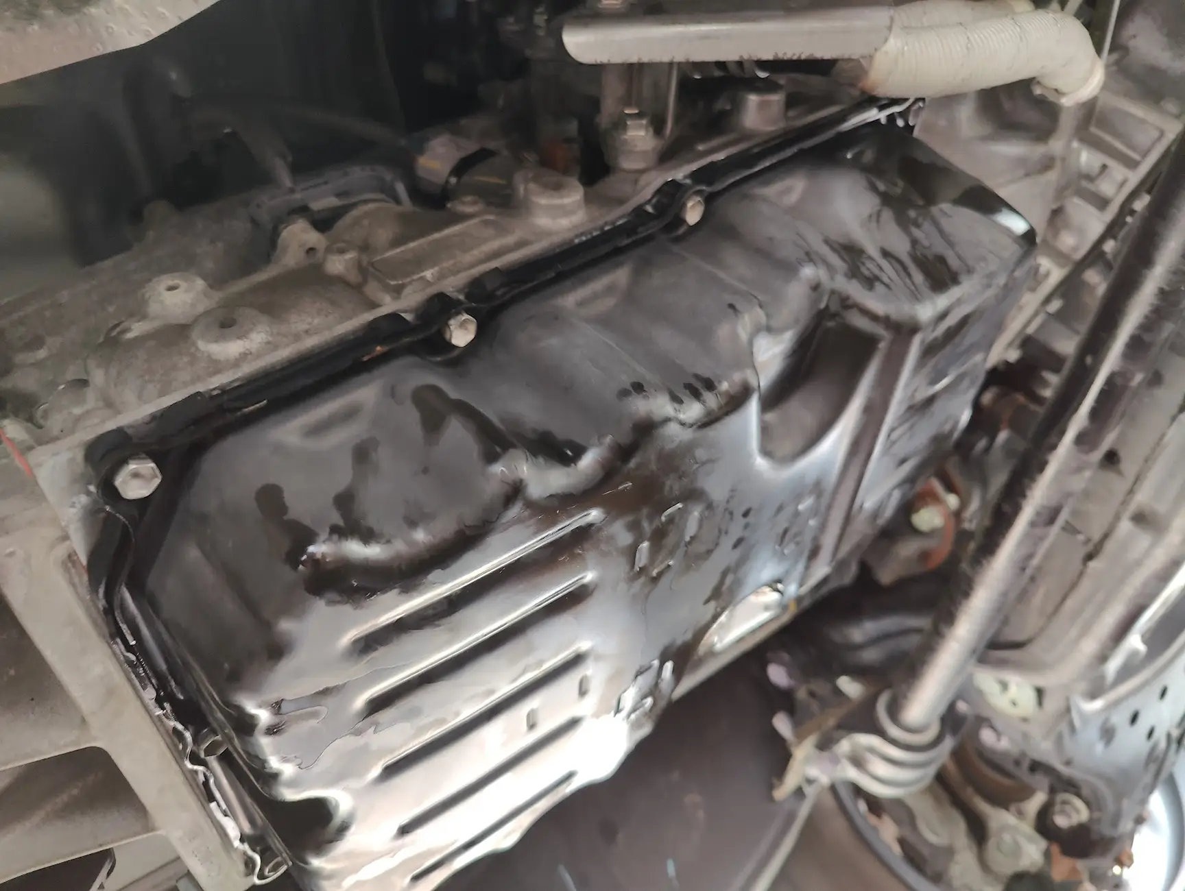

Do your pan cleaning and remove the old gasket as it fits to the pan with built in grooves. I used paper towels to clean the magnets and the very small amount of residual metal mud in pan itself. I followed this with brake cleaner to remove fibers left by the paper towels. Also use break cleaner and a rag on the gasket face of the trans housing itself. I left all surfaces related to the gasket install clean and dry. Once your pan and magnets are clean, install the new gasket to the pan.
Install the pan back on the housing and install all the bolts to finger tight. I used a bit of anti-seize on all of them because of the aforementioned aluminum-steel relationship. Once finger tight, starting at the middle of the pan in a star patten I used an in-lbs torque wrench to tighten the bolts. I started at 20 in-lbs, then 40, the 60 going in a star pattern each time. I could not find a torque spec but considering I’ve had no leaks and the bolts weren’t tight to begin with, I think 60 in-lbs is reasonable. Adding anti-seize also increases the torque a bit too, so be careful if you choose to go that route. Anyone chime in if they know the spec.

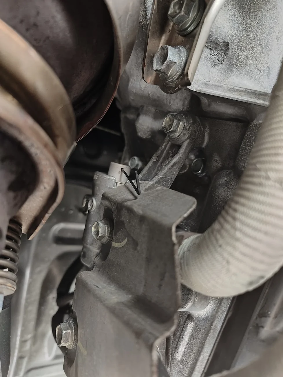

Make sure to open the thermostat at this point by pushing the plunger in with a screw driver and sticking a 1.5 mm pin into the side hole to keep it open. I used a 1.5 mm allen wrench. This allows the whole fluid system to circulate freely.

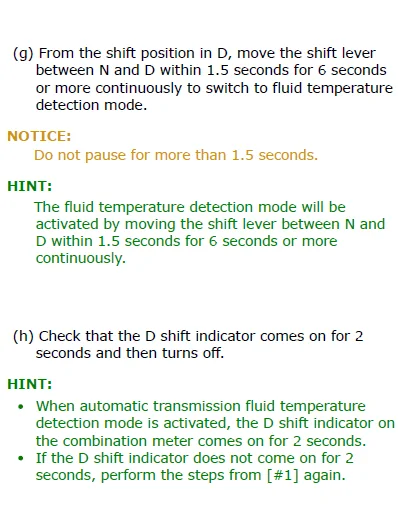

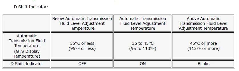

To check the fluid level properly you need to enter “Fluid Temperature Detection Mode” in order to ensure the fluid is at the right temp range to set the level.

After you set the level, use a new washer on the drain plug and reinstall the fill plug. The fill plug has its own built in o ring. Honestly, a new washer isn’t required but I bought them so I did. They’re just an aluminum washer like an engine oil plug washer.

Otherwise I threaded it back in until I could adequately thread in the drain pan bolt. Next time I'll remove the whole plan and replace the filter. Thanks for the update.
I ended up swapping out 4 quarts with that change. I also used the Amsoil OEM Synthetic ATF Fluid. I will mention that I also changed both diffs, and transfer case with Amsoil products, and I have to say the truck is driving noticeably smoother as a result.
Also, I want to make clear that the standpipe and the drain pan bolt are 6MM. I saw reference to someone saying the standpipe somewhere was 5MM. That's definitely not the case, both are 6MM.
Yep, I made the same observation where it was reported as 5mm and it is indeed 6mm. Both the plug and the standpipe.
As for the standpipe stop, in my experience there was a stop albeit its pretty far up there. I just used the long end of a 6 mm allen wrench and screwed in until it stopped. Gave it like 1/16 of a turn after finger tight so it was snug.
I can respect the hesitation of your end because if there isn't a stop and screwed it all the way into the pan... If it falls inside you're in for a whole world of pain lol
