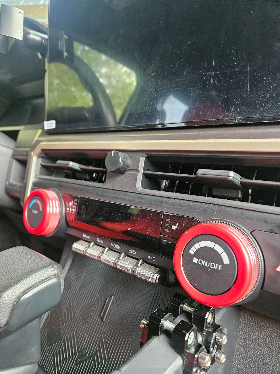

Well, finally complete it, a volume knob for the 4th gen Toyota Tacoma!

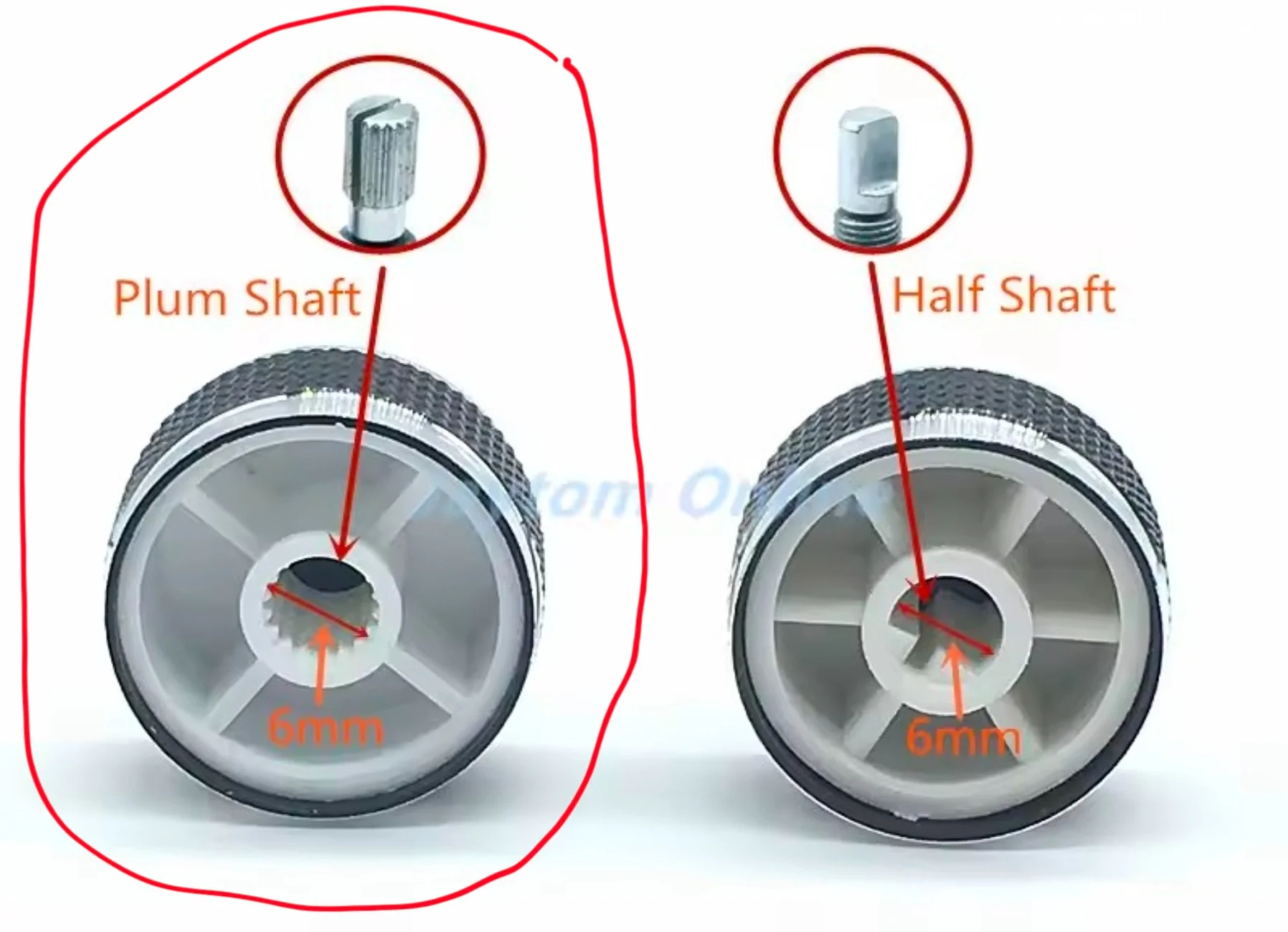

Note #3: I ended not using an included 1.5 inch metal control knob due to space constraints. An old radio volume knob with round spine known as Plum (knobs with half moon hole in the back may also with a bit more force but not recommended). 6mm or 1/4 hole (guitar) knobs with an allen screw may also work, plus you can easily adjust the height.

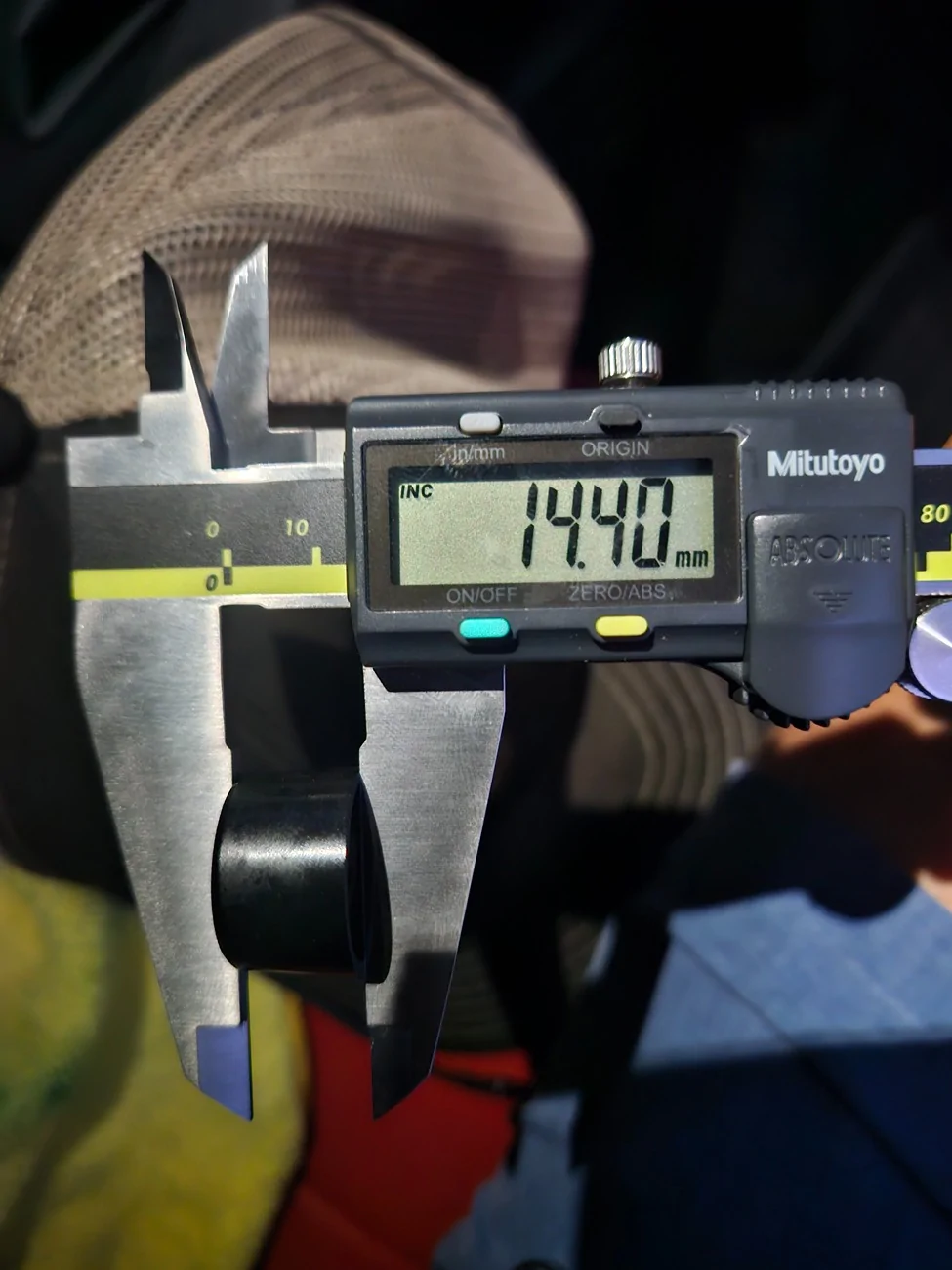

Note #4: The volume control knob should have included metric Pot Nut and Washer, if not... https://a.co/d/0cENIVti
Note #5: On the AliExpress basic knob option (cheapest), funtions includes volume up/down, center push for mute or pause, if command is accepted by app by default. There are other kits that by factory design, may have more functionality. Look around, the only constraint is the board size to fit inside de aprox 2"x3" space between the vents to mount the project.
Note #6: round 1 inch (25mm) wide by 3/4 (16 to 19mm) height Control knobs are available in most online marketplaces:

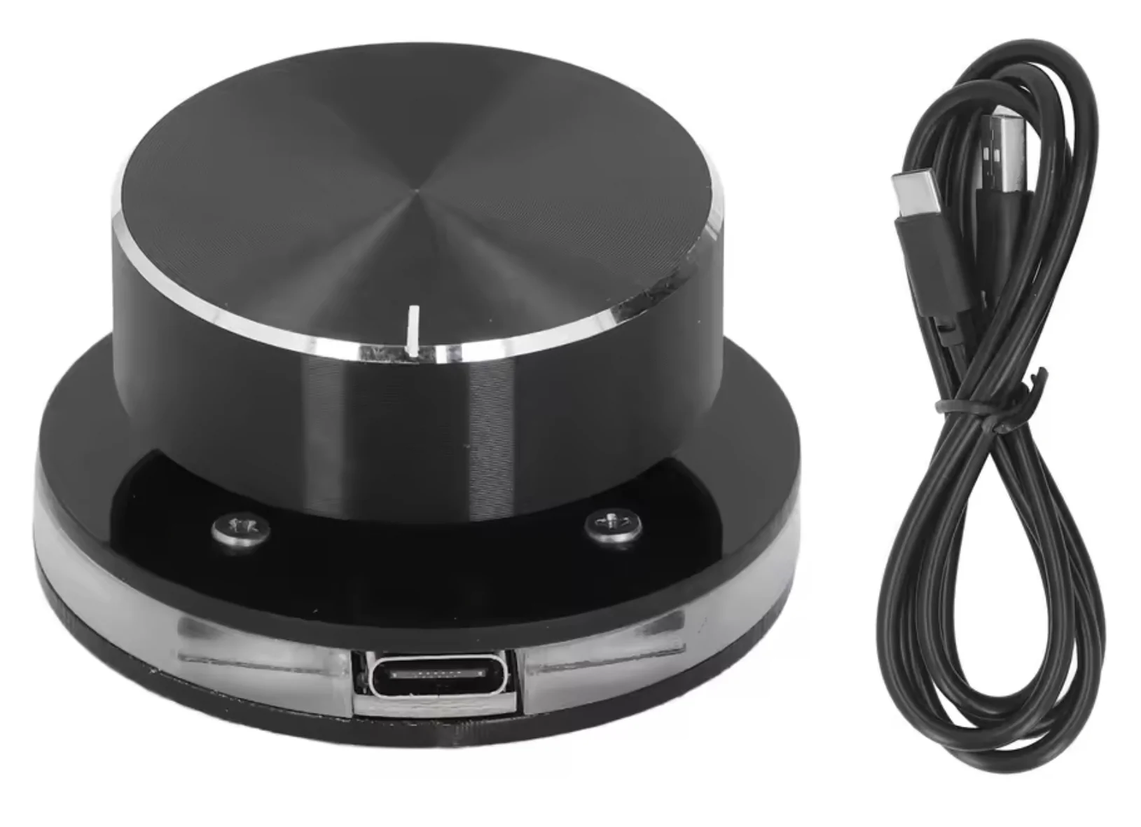

1. USB Type-C Volume knob with mute (here's an economic version, but any other with the same size/characteristics should be fine, the RGB LED function, is not used)
2. USB A to 90 degree Type-C one foot cable: https://a.co/d/06TiNeiQ (a data cable, not only charging). The AliExpress volume knob comes with one but the space is very limited and a 90 degree Type C plug is required.
3. Volume control knob, also known as a Pot (potentiometer) Hat.

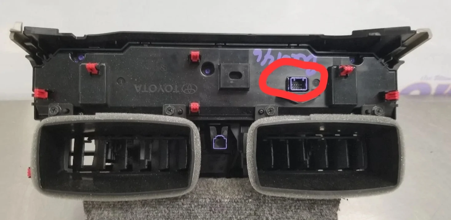

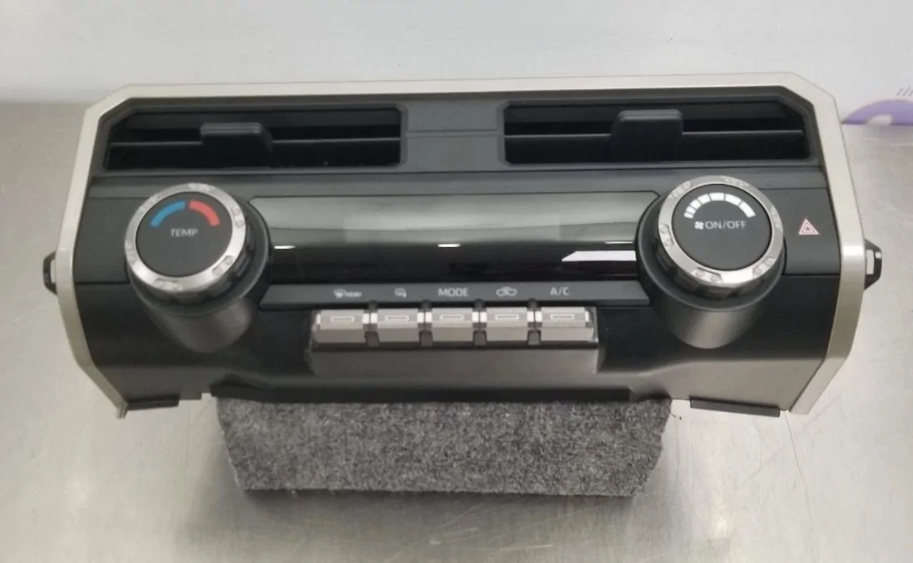

5. Carefully pull TEMPERATURE A/C CLIMATE CONTROL console with integrated vents. AVOID PULLING FROM THE SMALL TRIM surrounding the panel, tabs can break easily. Squeeze and disconnect rear electric/data plug.

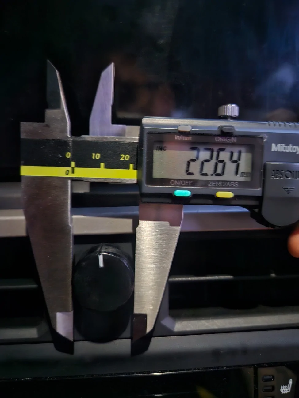

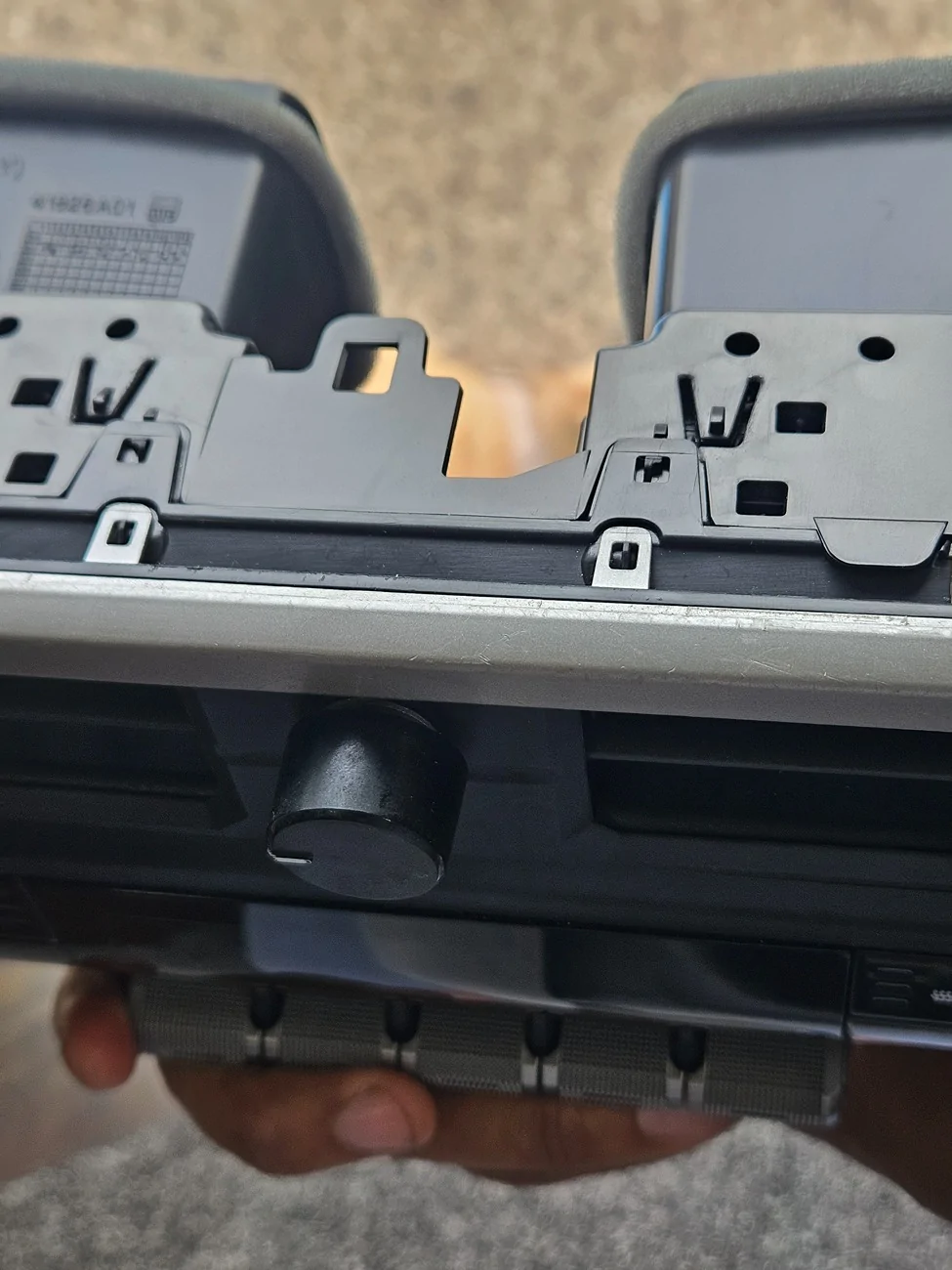

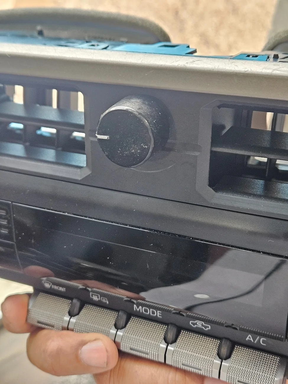

6. Test/prop your preferred position for the Pot mounting hole, about 1.5 inches from the top/1 inch side to side and mark the drilling position.
7. Drill mounting hole, starting with a small drill bit and make it bigger as you check the position again with the Pot/hat.
Mounting the Knob:

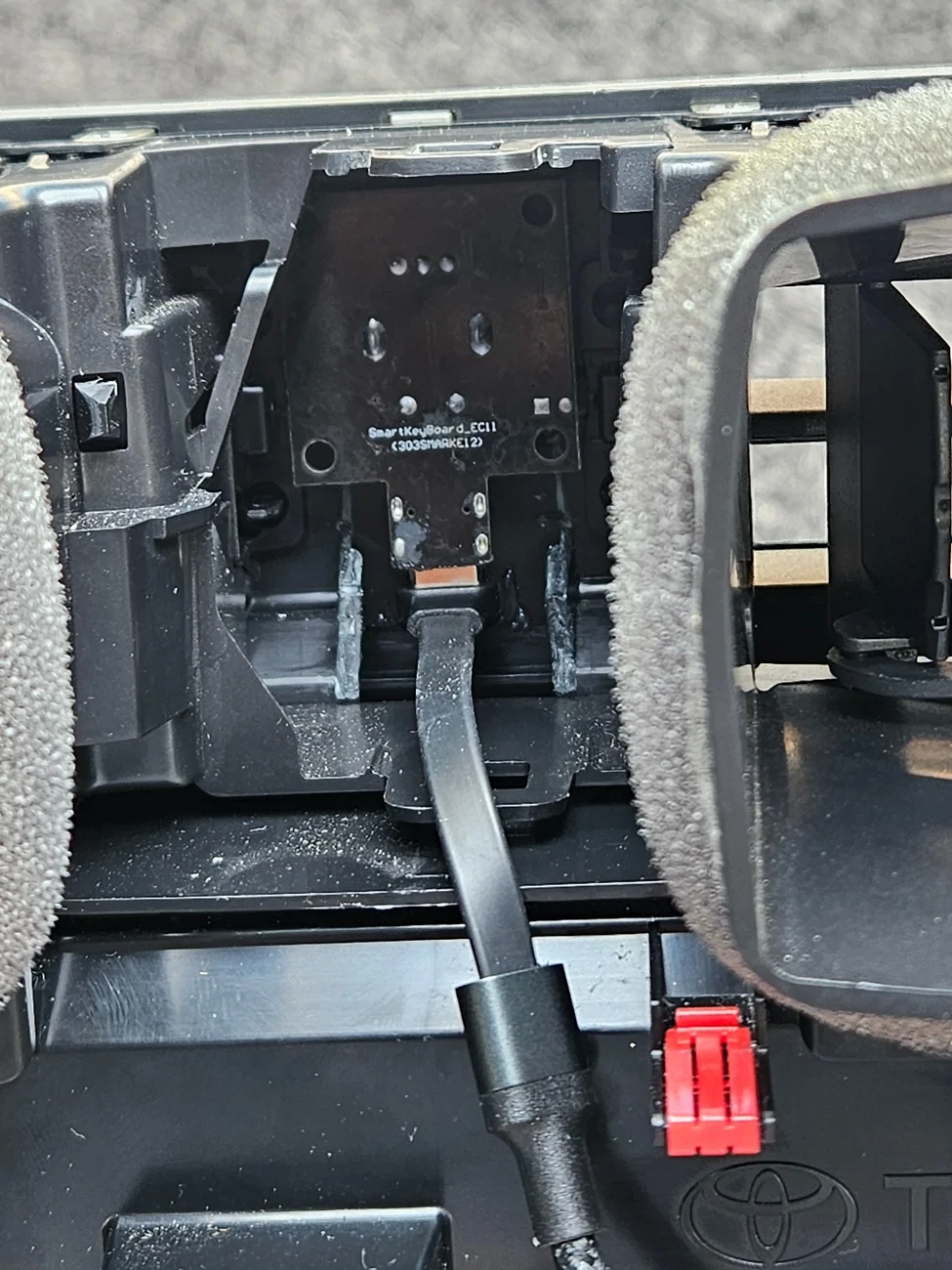

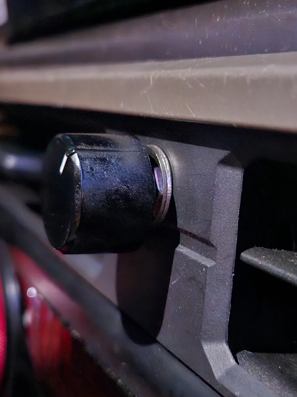

A. Insert the Pot from the back and secure it with 1 Pot Nut and one Washer. Test functionality by installing your Knob/hat and pushing/turning. If it is too far from the surface of the Temperature console, add a an inside washer.
B. Install and run to radio the USB cable.
C. Reinstall everything, the Large TRIM PIECE FIRST and its little pieces, followed by the temperature console (don't forget to plug the cable!), and finally plug and install the radio, 4 screws and the screws cover plastic piece.

The 8" screen volume knob is on the lower left hand side of the screen itself, while the (OEM) 14" screen's volume knob is in the center of the cluster panel below the screen (where OP installed his).
When you upgrade the screen size (OEM or aftermarket), without replacing the panel with the piece that has the volume knob, you lose it and the functionality of the knob.
