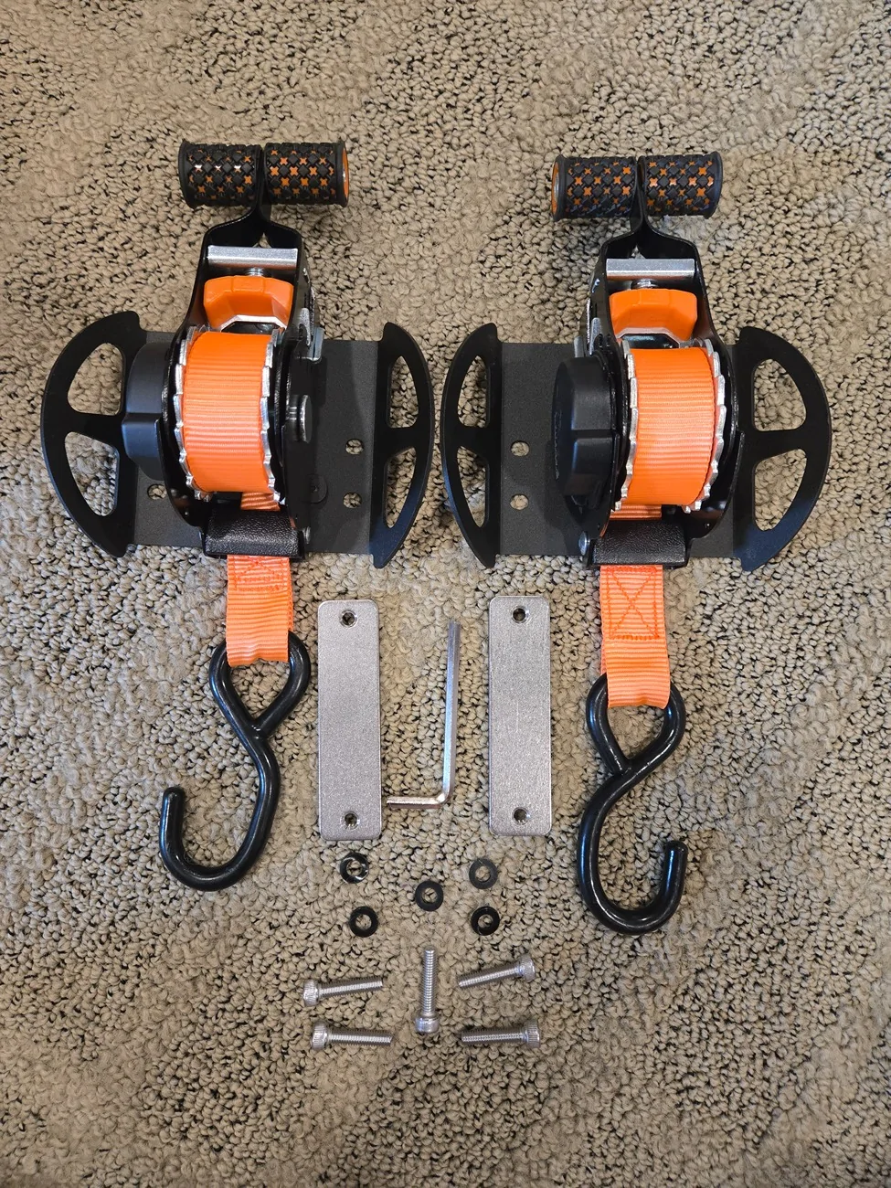

Packaging:
The packaging is superb. The two ratchet straps were individually bagged. The fasteners, plastic washers, Allen wrench and installation back plate were separately packaged in a zip-locked bag.
The instruction sheet was 'clear enough'.

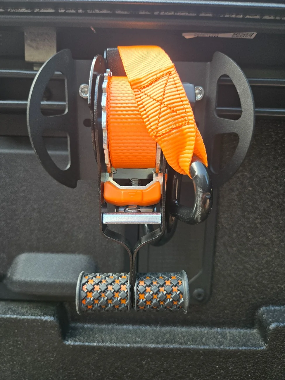

They're are two holes in the Ratchet Strap mounts but the instructions do not detail which one should be utilized. I used the top one after confirming that my OEM tri-fold bed cover would close with them in place on the bed rails.
Installation preparation:
I placed a plastic washer over each of the 4 Allen head mounting bolts and through the top (upper) mounting holes of the mounting / backing plate.
I tightened each allen head screw until I saw that it was even with the rear backing plate so I could readily slide them into the bed rails.
Installation:
I opened the OEM bed cover and removed the keepers (just push & pull) and skid the mounting/ backing plate into the channel of the bed rail (both sides).
Note: push the mounting plate passed the first round head mounting screw (attaches the bed rail to the truck bed).
I used the included allen wrench to tighten the 4 Allen head screws (2 on each side). Done.
Please note that the hook sits at the TOP of the ratchet strap.... NOT the bottom.

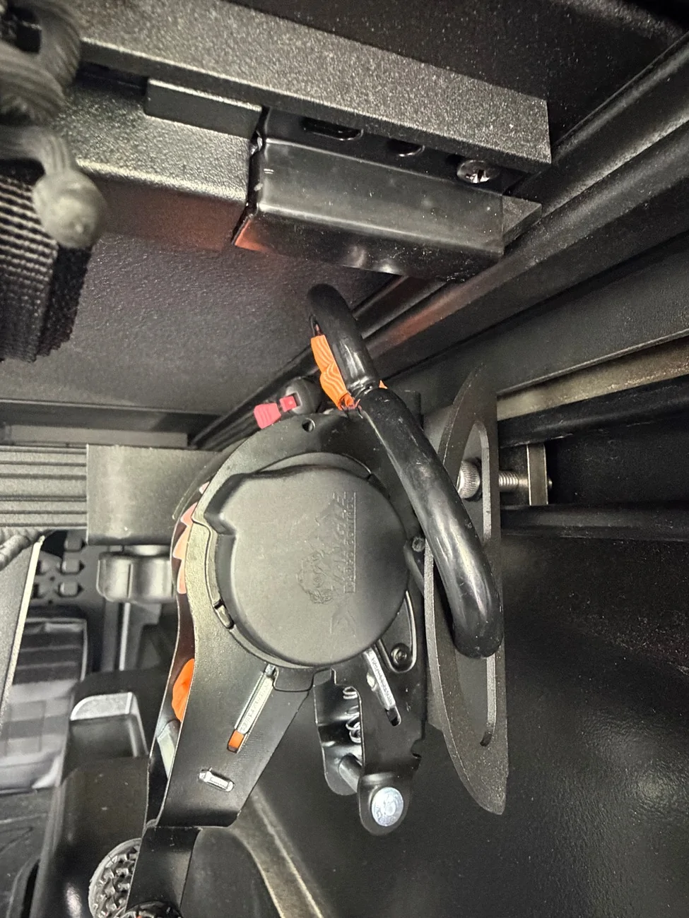

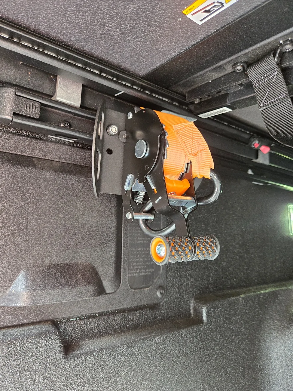

2024 Tacoma Mabett Ratchet Straps for Tacoma Bed Rails - installed review & photos 20260817_093246
2024 Tacoma Mabett Ratchet Straps for Tacoma Bed Rails - installed review & photos 20260817_093452
2024 Tacoma Mabett Ratchet Straps for Tacoma Bed Rails - installed review & photos 20260817_094736
2024 Tacoma Mabett Ratchet Straps for Tacoma Bed Rails - installed review & photos 20260817_095204
2024 Tacoma Mabett Ratchet Straps for Tacoma Bed Rails - installed review & photos 20260817_095238

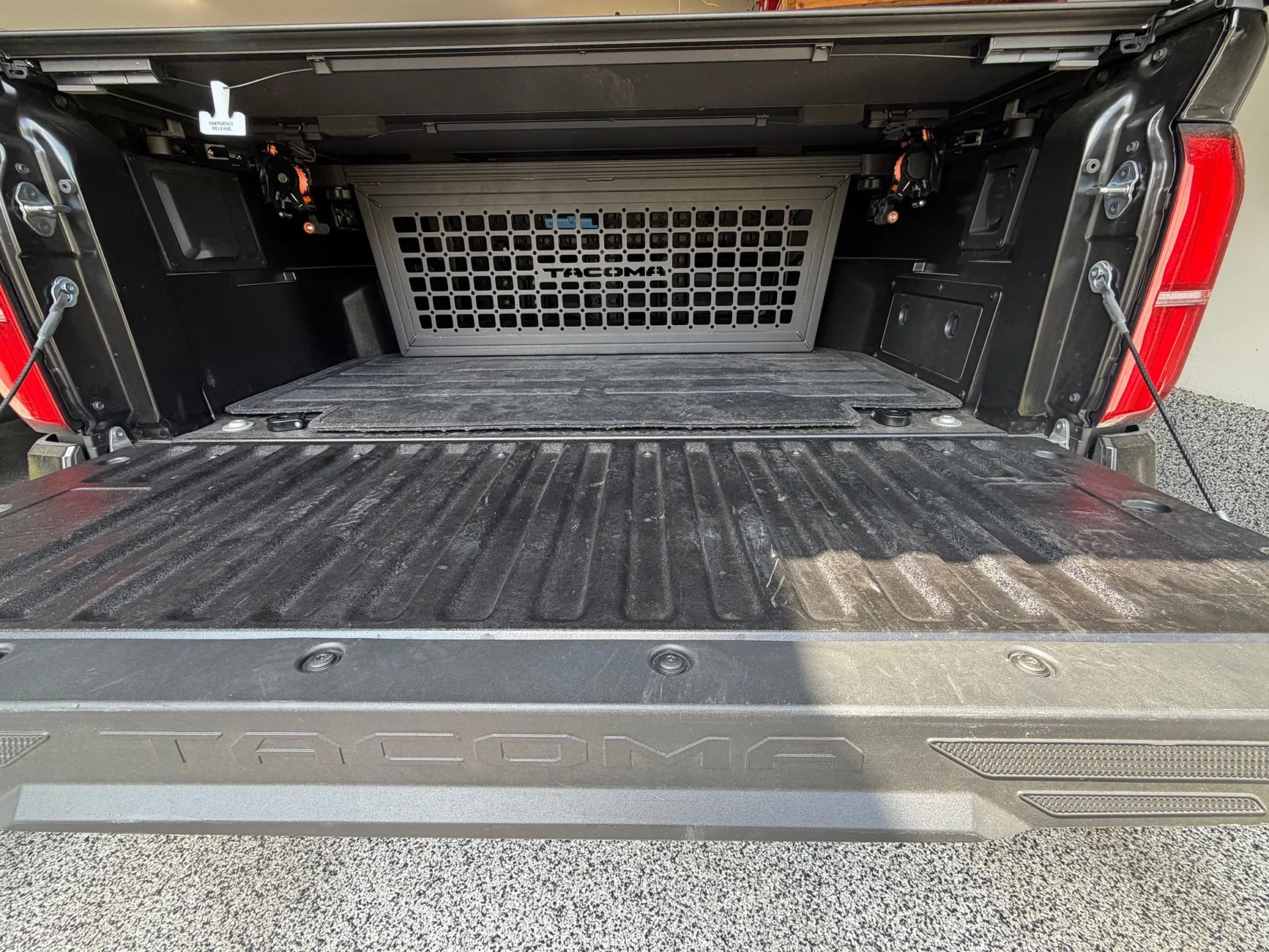

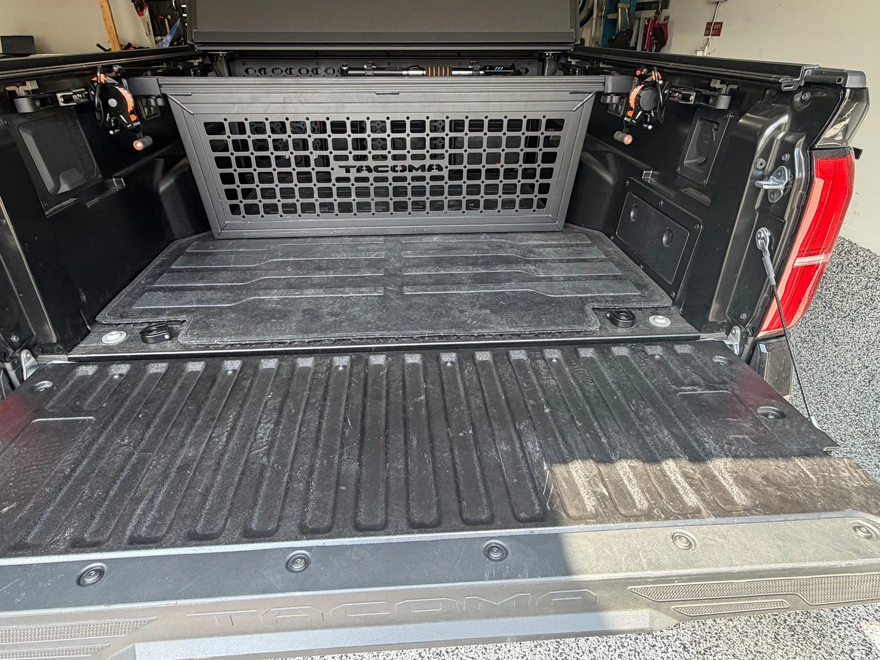

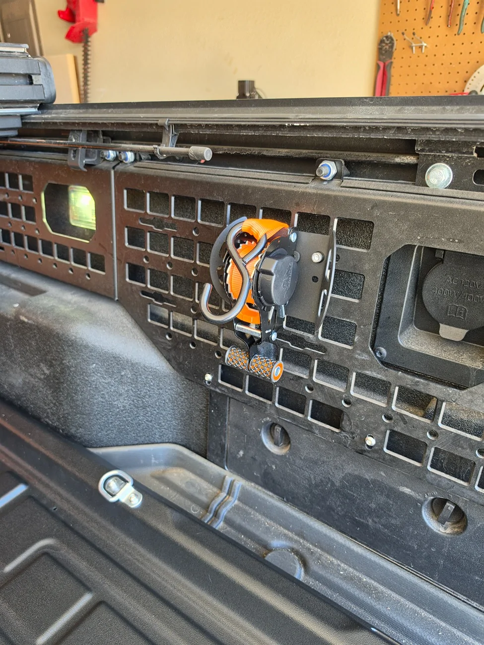

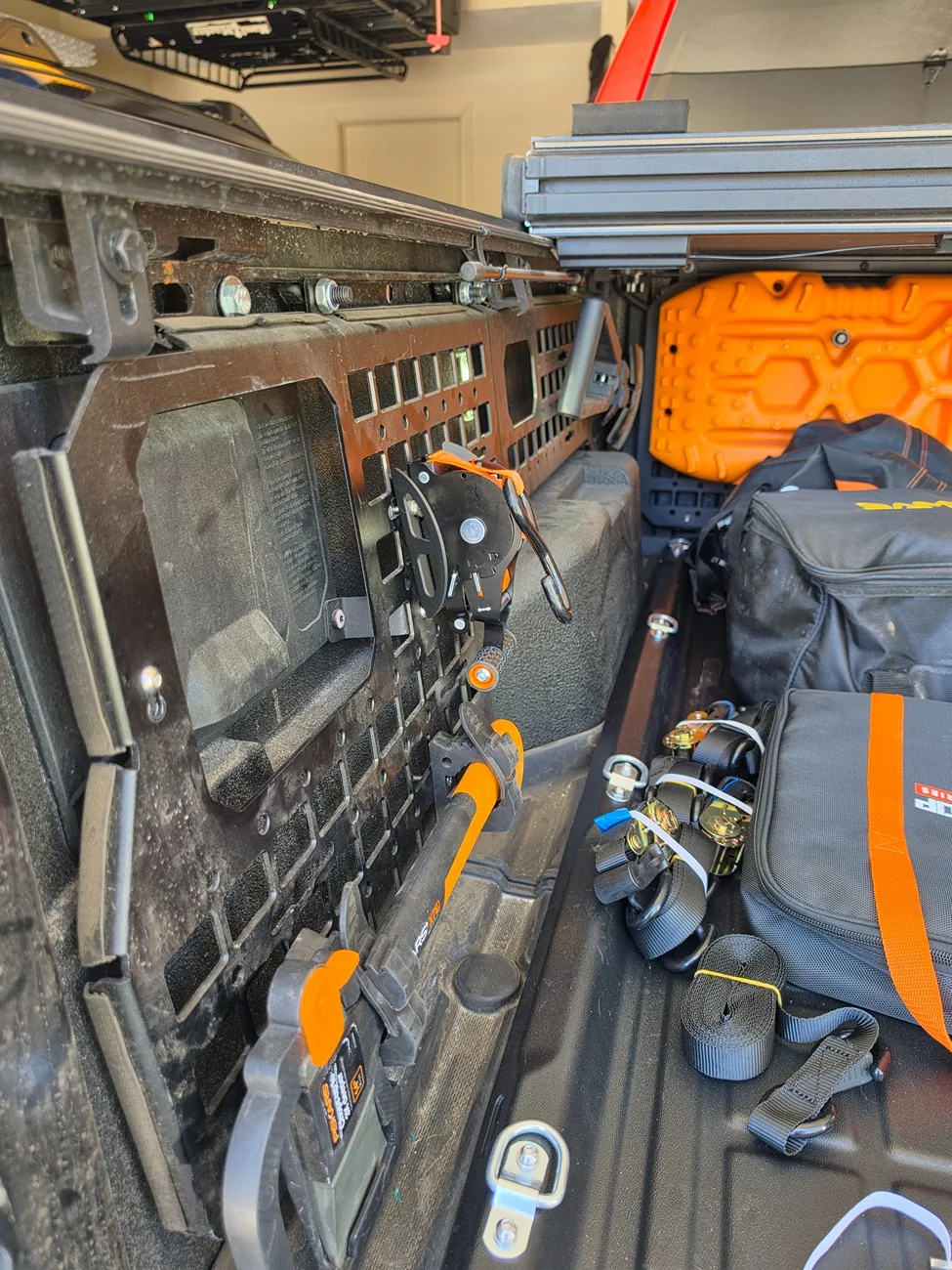

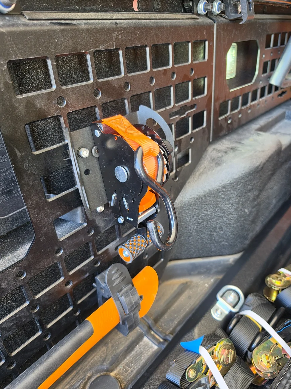

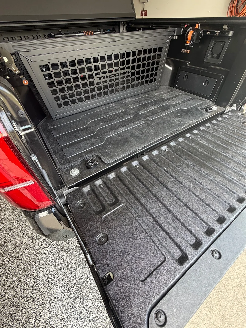

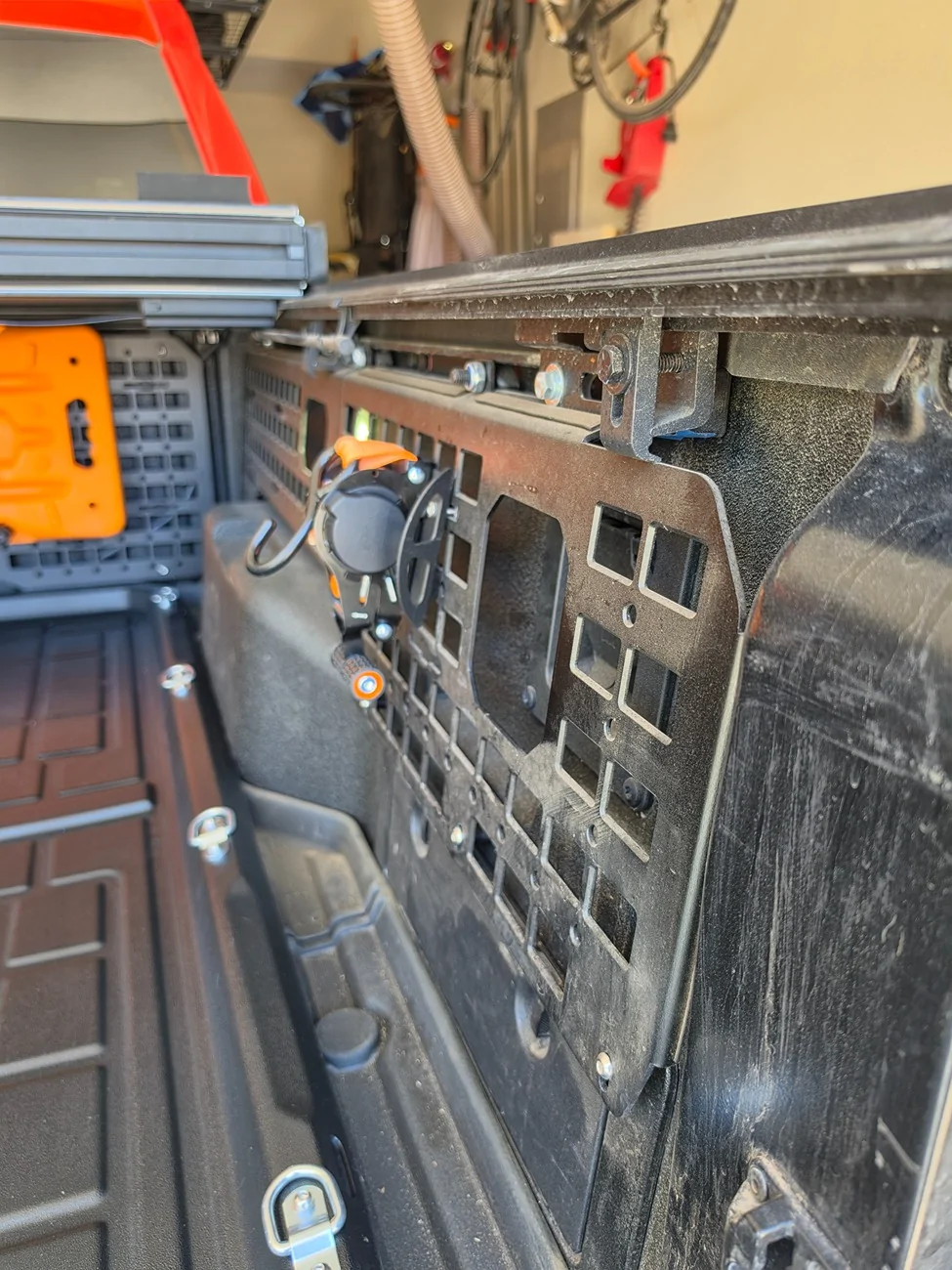

Just got mine installed! I have a molle panel on the rails so i used the molle panels themselves. The install was super easy and they look great (IMHO)! Thank you to @Mabett for working with me on sending out this product.
Well done on the molle. I like that!

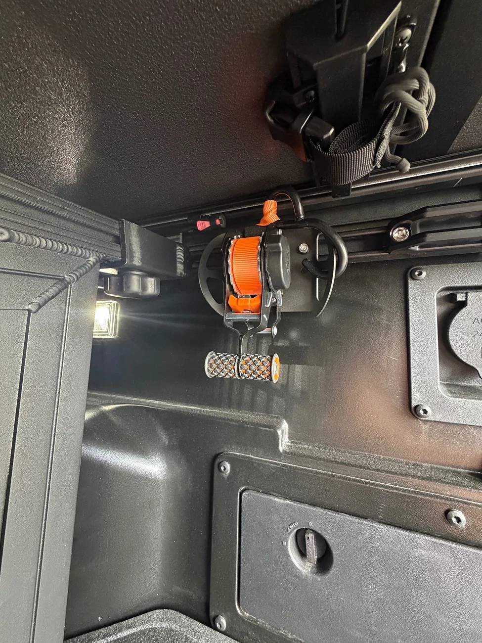

I was another tester. Install was easy, product is definitely beefy and seems to be well made. Operation is smooth and does the trick. Super convenient to have the ratchet straps out and ready to go, rather than dig them out from storage.
I’ve got the OEM tri fold, as well as the OEM cargo divider. The straps work and fit without interfering with anything.
One improvement I can think of is if the ratchet heads could pivot, which would make them a bit more useful. Time will tell as I haul more loads that are different shapes if the lack of pivot will be a deal breaker.
Overall, I’m impressed and would recommend.

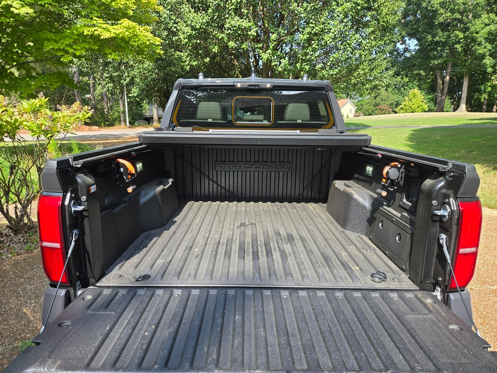

2024 Tacoma Mabett Ratchet Straps for Tacoma Bed Rails - installed review & photos IMG_0398
2024 Tacoma Mabett Ratchet Straps for Tacoma Bed Rails - installed review & photos IMG_0396
2024 Tacoma Mabett Ratchet Straps for Tacoma Bed Rails - installed review & photos IMG_0394
2024 Tacoma Mabett Ratchet Straps for Tacoma Bed Rails - installed review & photos IMG_0395
2024 Tacoma Mabett Ratchet Straps for Tacoma Bed Rails - installed review & photos IMG_0397
