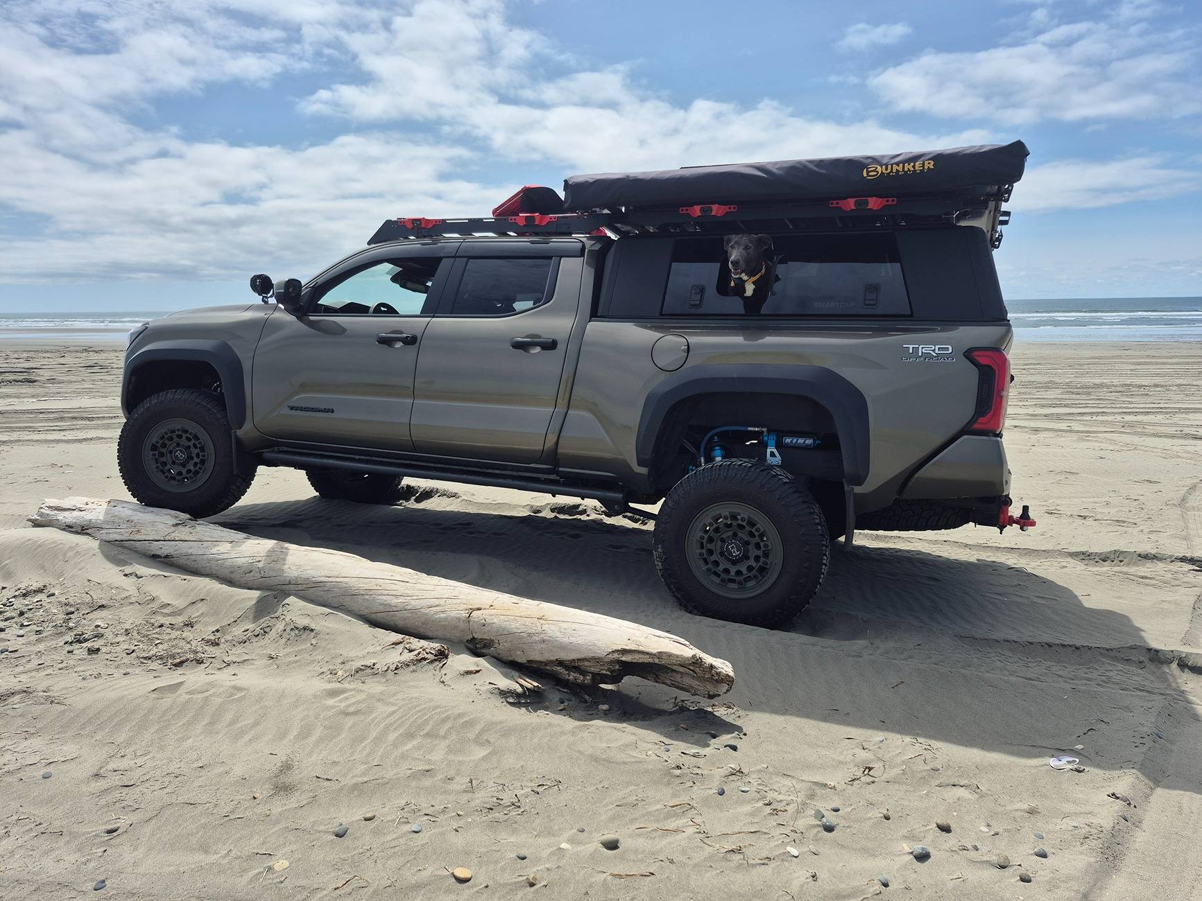

I have 285/75R17 inch tall Nitto Ridge grapplers on my 24 trd off-road with the sway bar disconnect on stock wheels and fully flexed I get no rub. I do have a 1.5 inch front and rear lift from all dogs off-road though.
Thanks for the info!!
