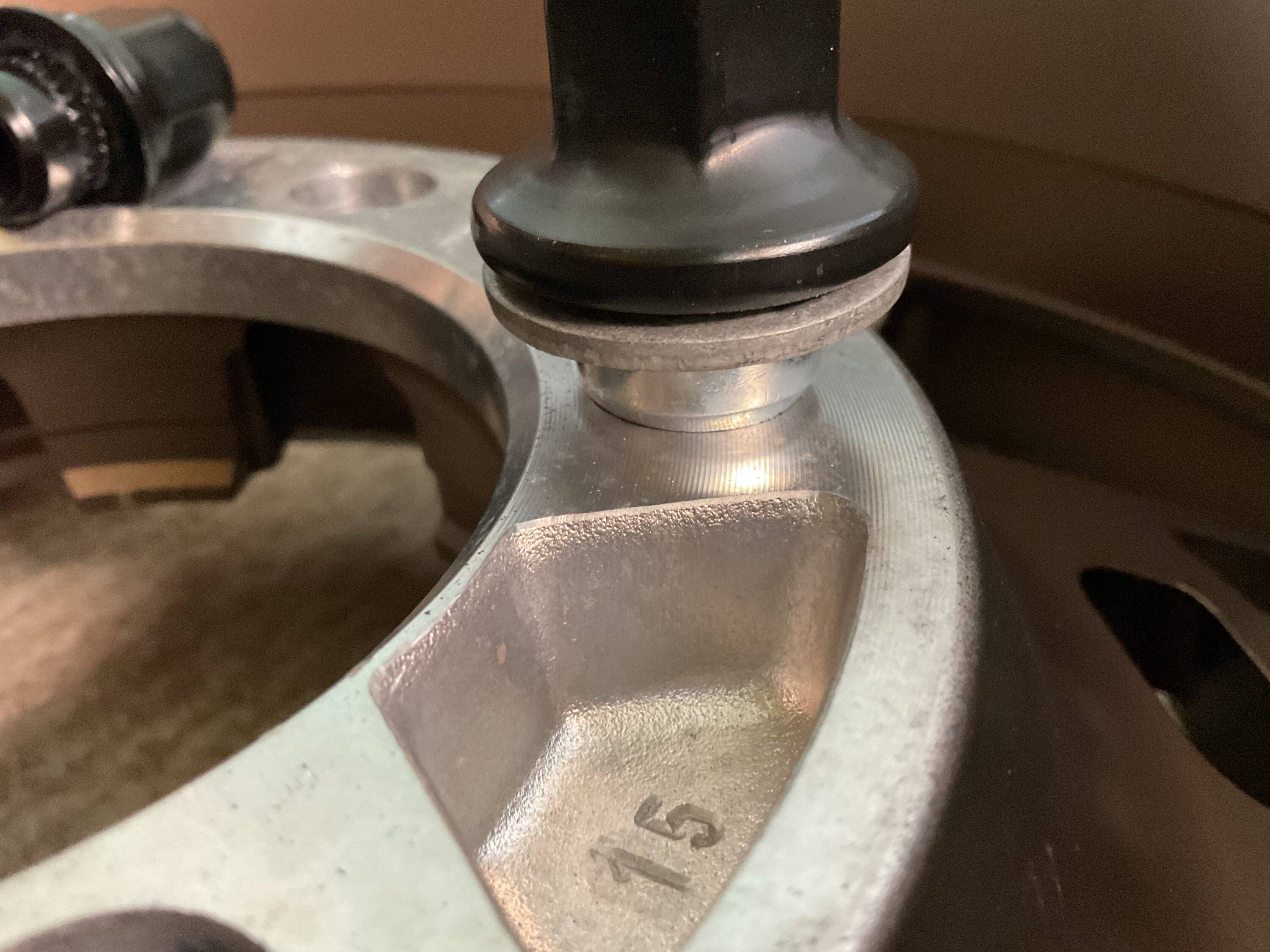

No lift was required, but hub rings make it much easier to get wheel centered correctly. Specs for hubrings are: 95.1mm ID to 106.1mm OD
I’m trying to do the same thing. I have the wheels sitting here in boxes, but scratching my head on the lug nuts. 4g lug nuts won’t go through the 3g wheel and 3g lug nuts are too small for the 4g stud. What do I do?

What's the diameter of the 4G lug shank?
.87 inches or 22 mm.

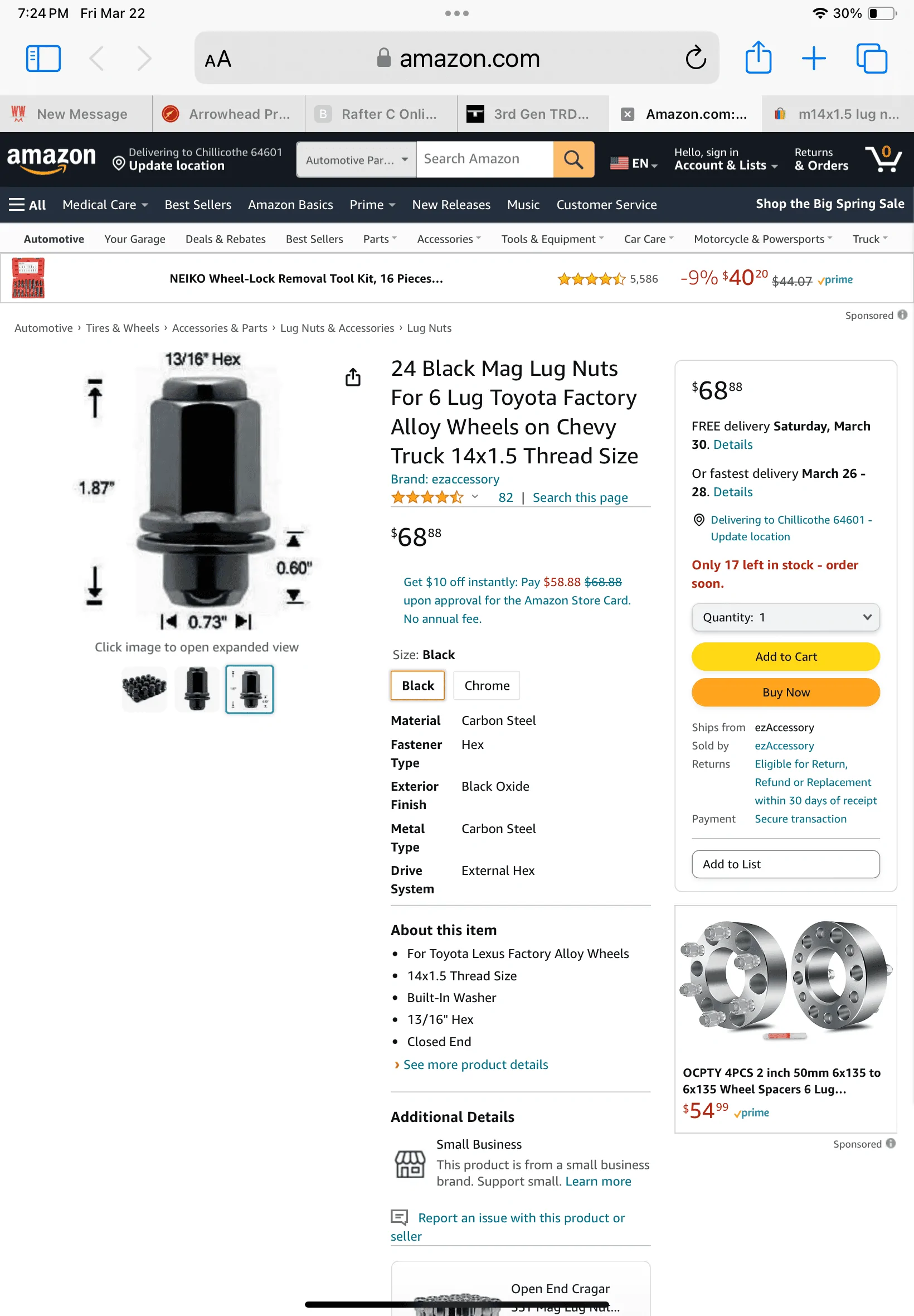

Found lug nuts that I believe will work if detail measurements are correct. They are called Toyota on Chevy Lug Nuts. Another member and I have been discussing all day. He gets the credit for finding them

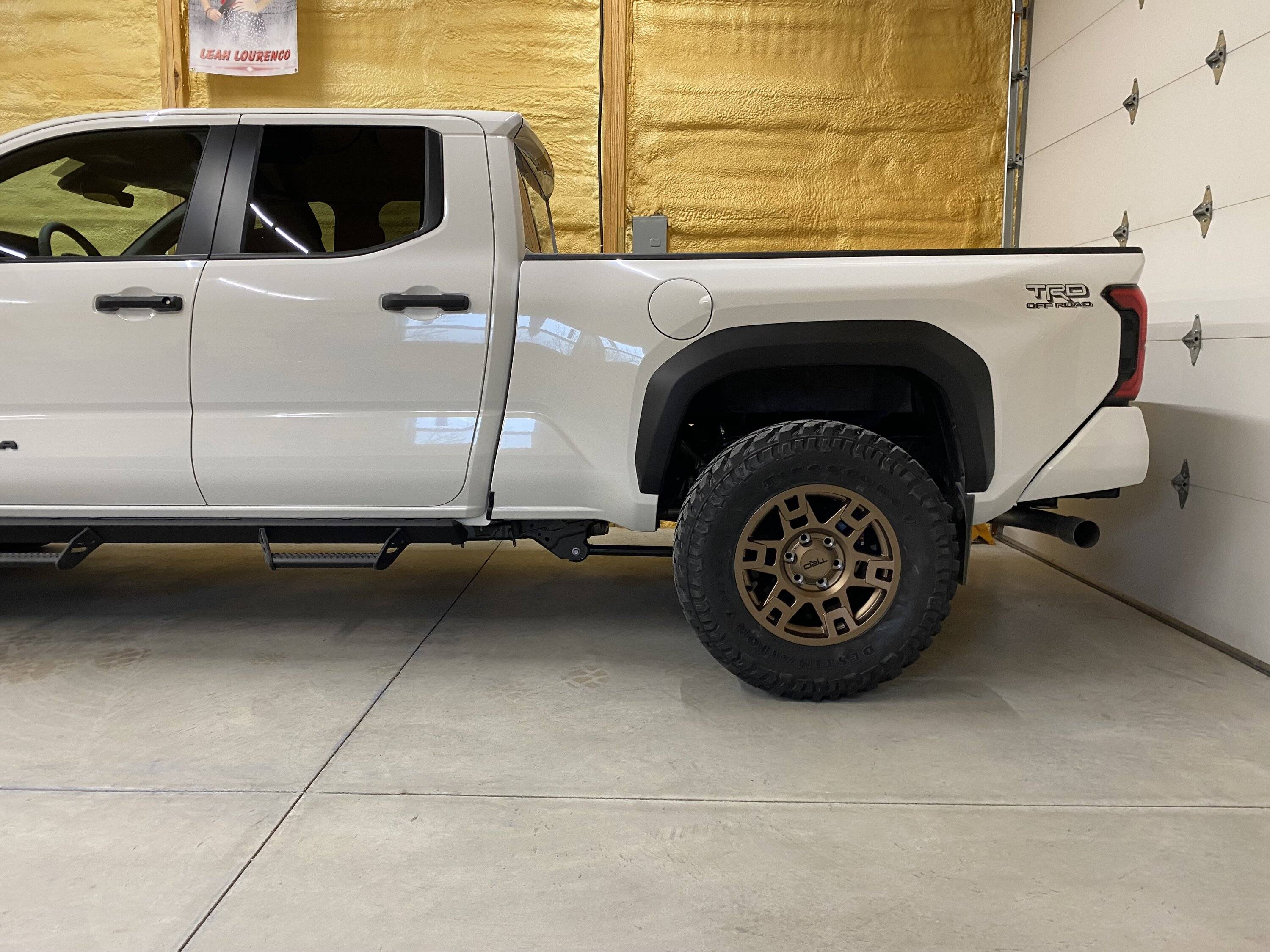

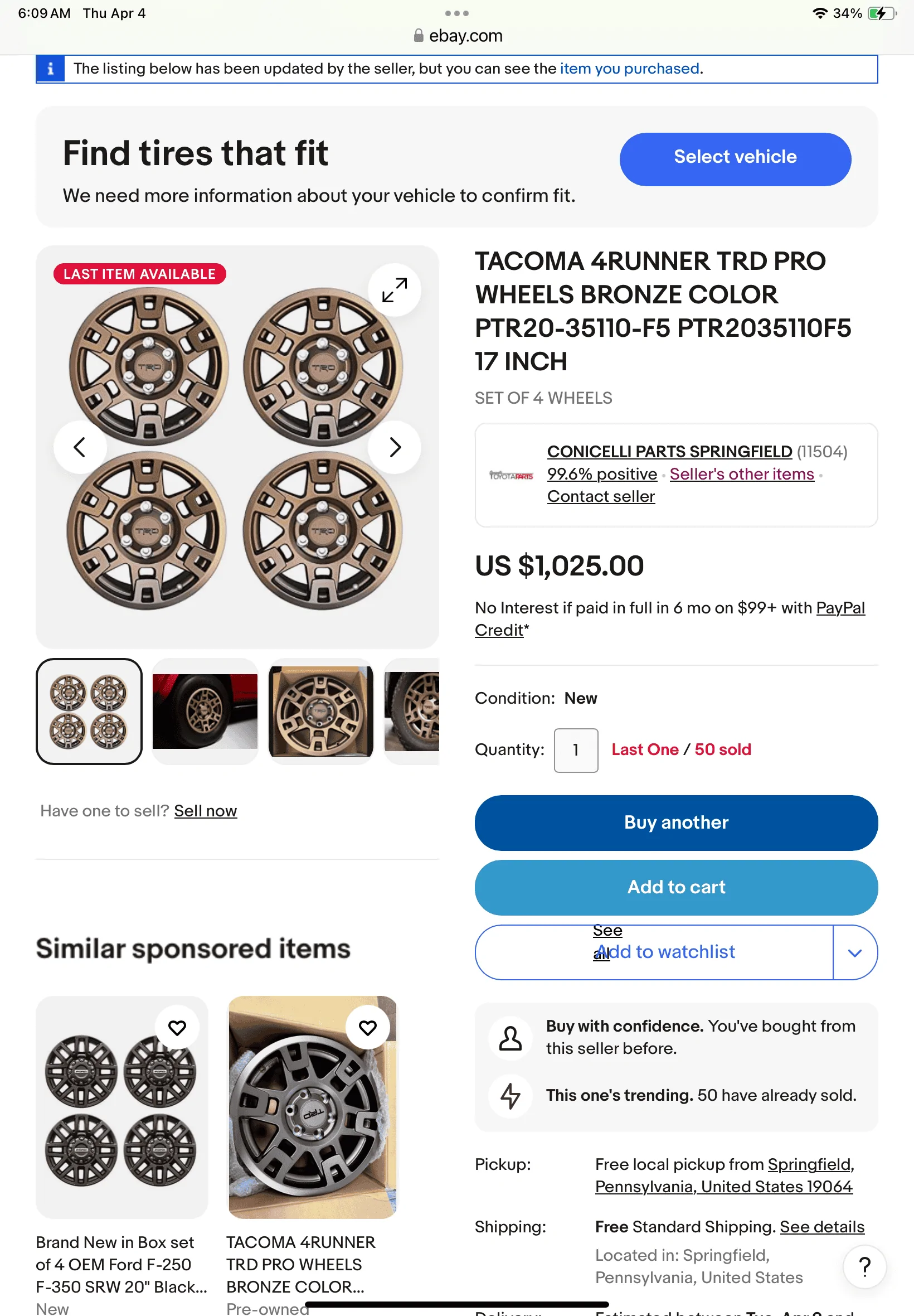

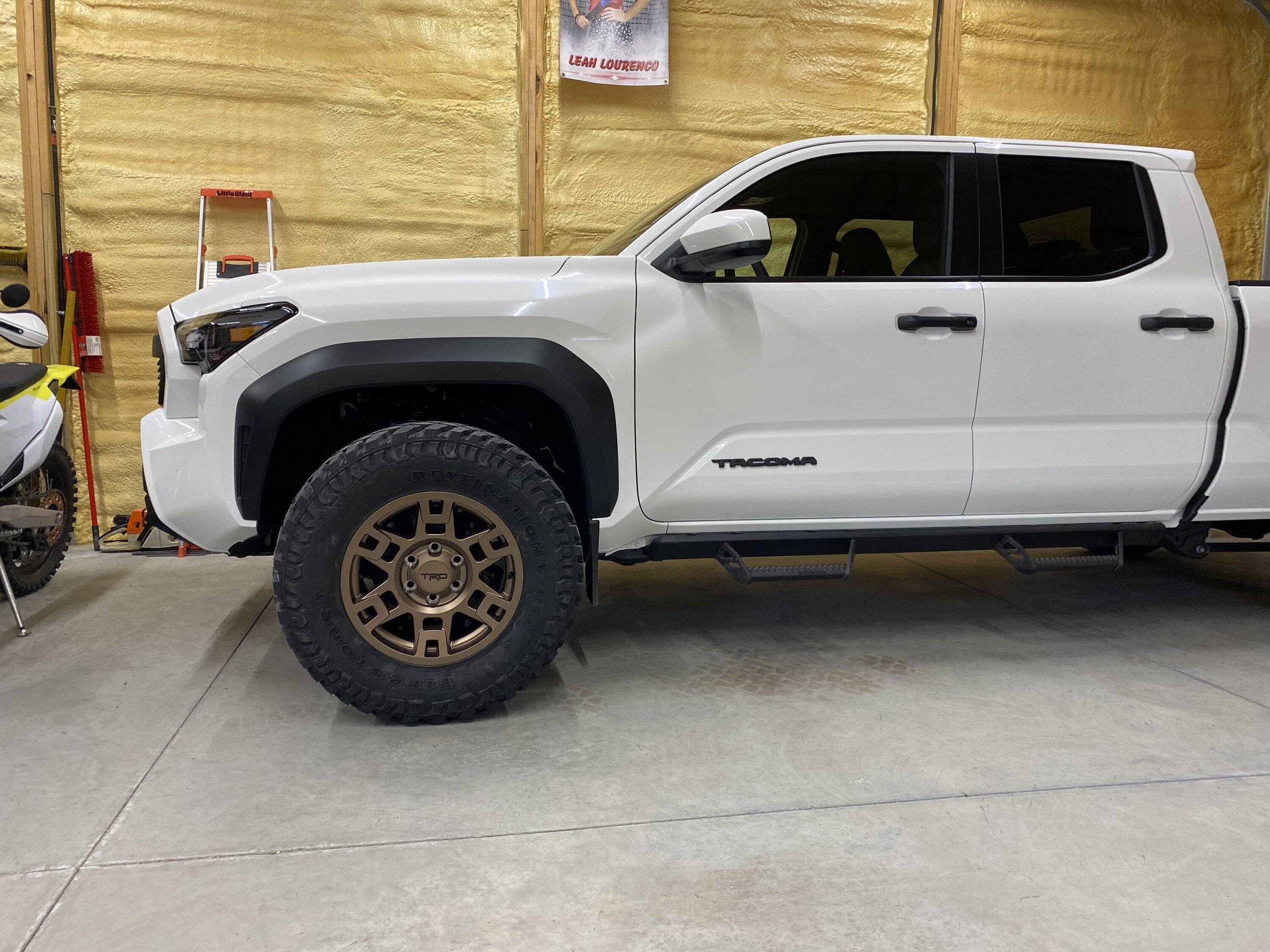

I bought my wheels on eBay from a Toyota dealer in Pennsylvania. No problem at all. They have all the colors if you search. I did one thing different than most. I went 255/75/17. Some refer to them as pizza cutters. They are narrow compared to what most are doing. But true 32 inches tall. I did this mainly because I want as little poke as I can with these wheels. These wheels offset is not ideal for the 4g in my opinion. I ordered the lug nut I showed in this thread a little ways back, but they showed up the wrong color (chrome). Black ones are shipped and I’m waiting for them to arrive to get them mounted on the truck. The picture of the wheel next to my truck is just sitting there not mounted so not accurate proportions. Hopefully I’ll have the lug nuts by the weekend and I’ll share my final report asap.

No. Ez accessories on Amazon sent the wrong lug nuts three times in a row. Or i should say the dimensions didn’t match their description. I’m gonna go to a Toyota dealer next time I’m in the city and see if I can find the lug nuts the op in this thread was able to find.
