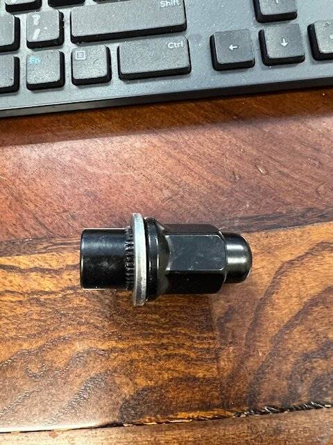

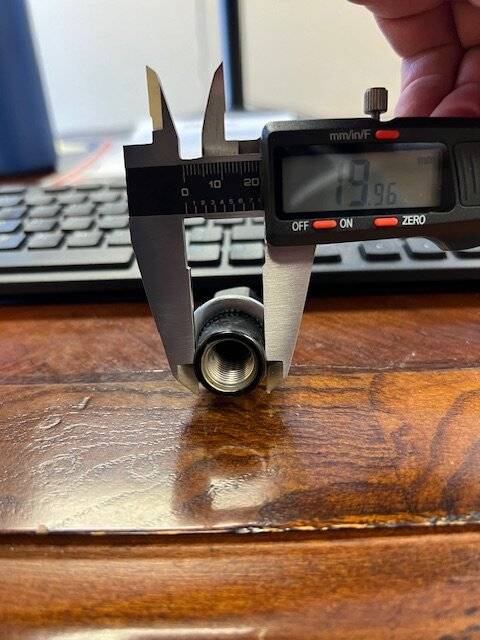

My partner company has these in stock. They only come in 32 packs though. But I can probably work something out. But you may want to measure the lug hole wheel first.
This lug is
20mm diameter
17mm long on the shank from the washer to the edge
30mm washer diameter
And yes, my keyboard is looking pretty dirty lol

Has to be .73 or .74 is my findings. .75 will not drop in.

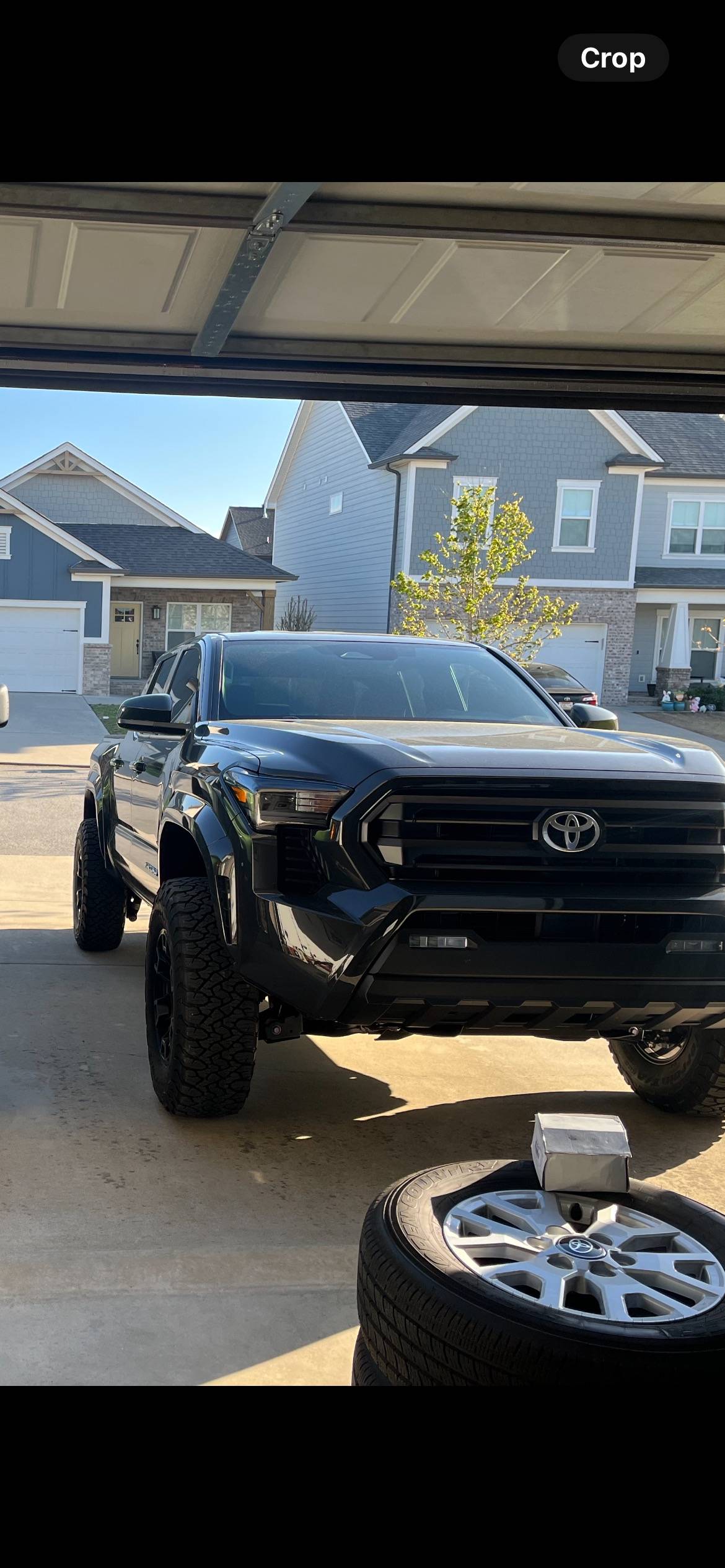

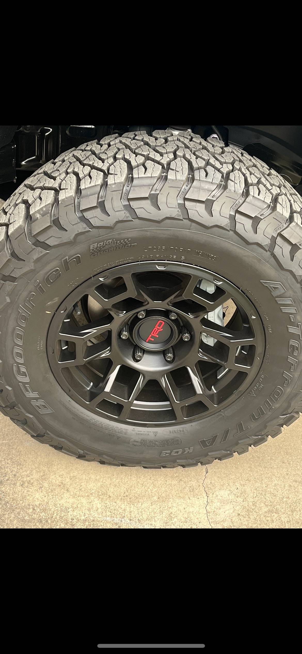

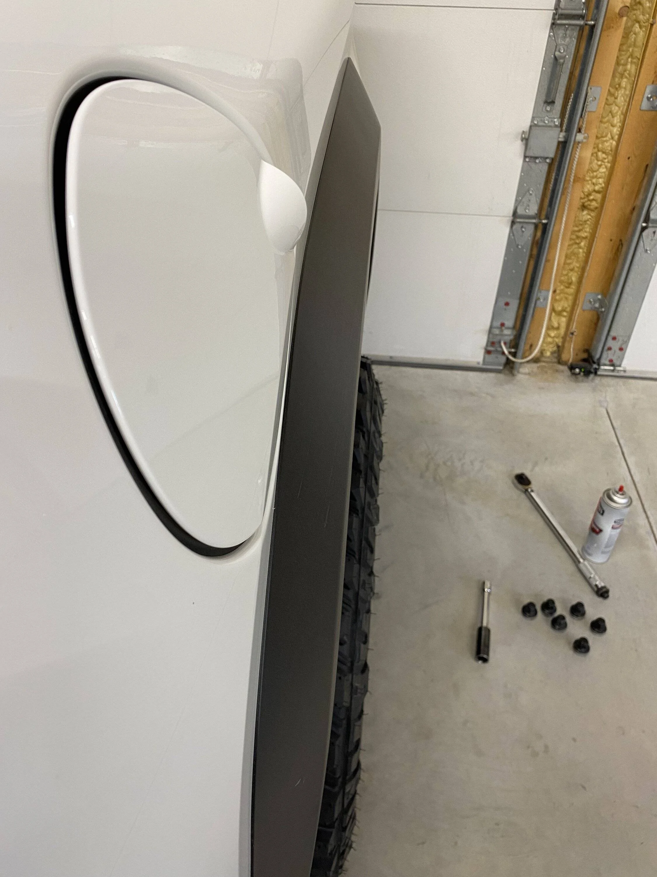

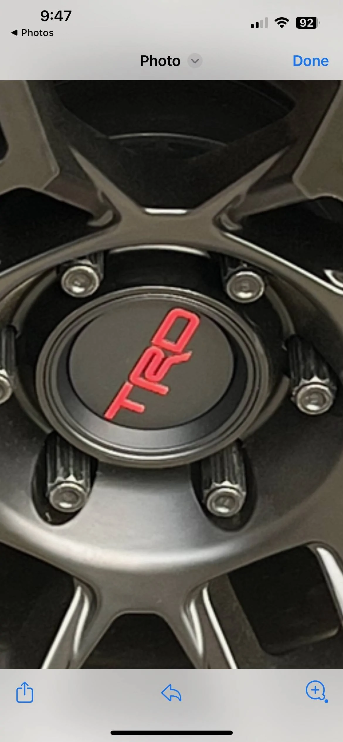

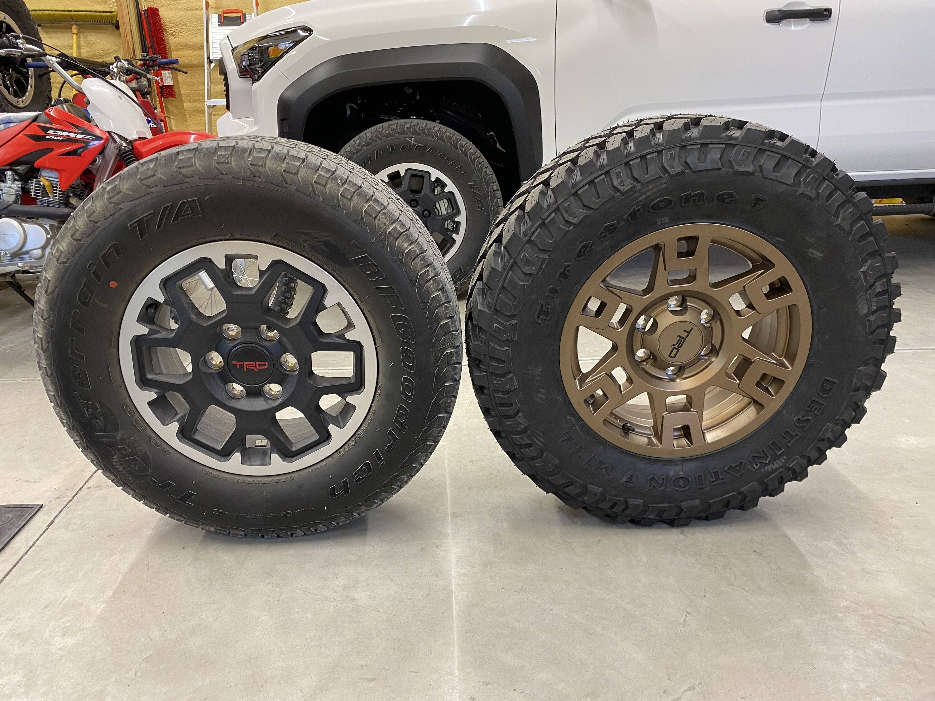

I wish someone would figure this out because I sure like the look. I don’t love the little bit of poke, but think I can live with it. Going to a Toyota dealer Friday. The other thread said his worked with a variant of a tundra lug? I’ll keep reporting until I find a lug nut that works or I drill the holes bigger.

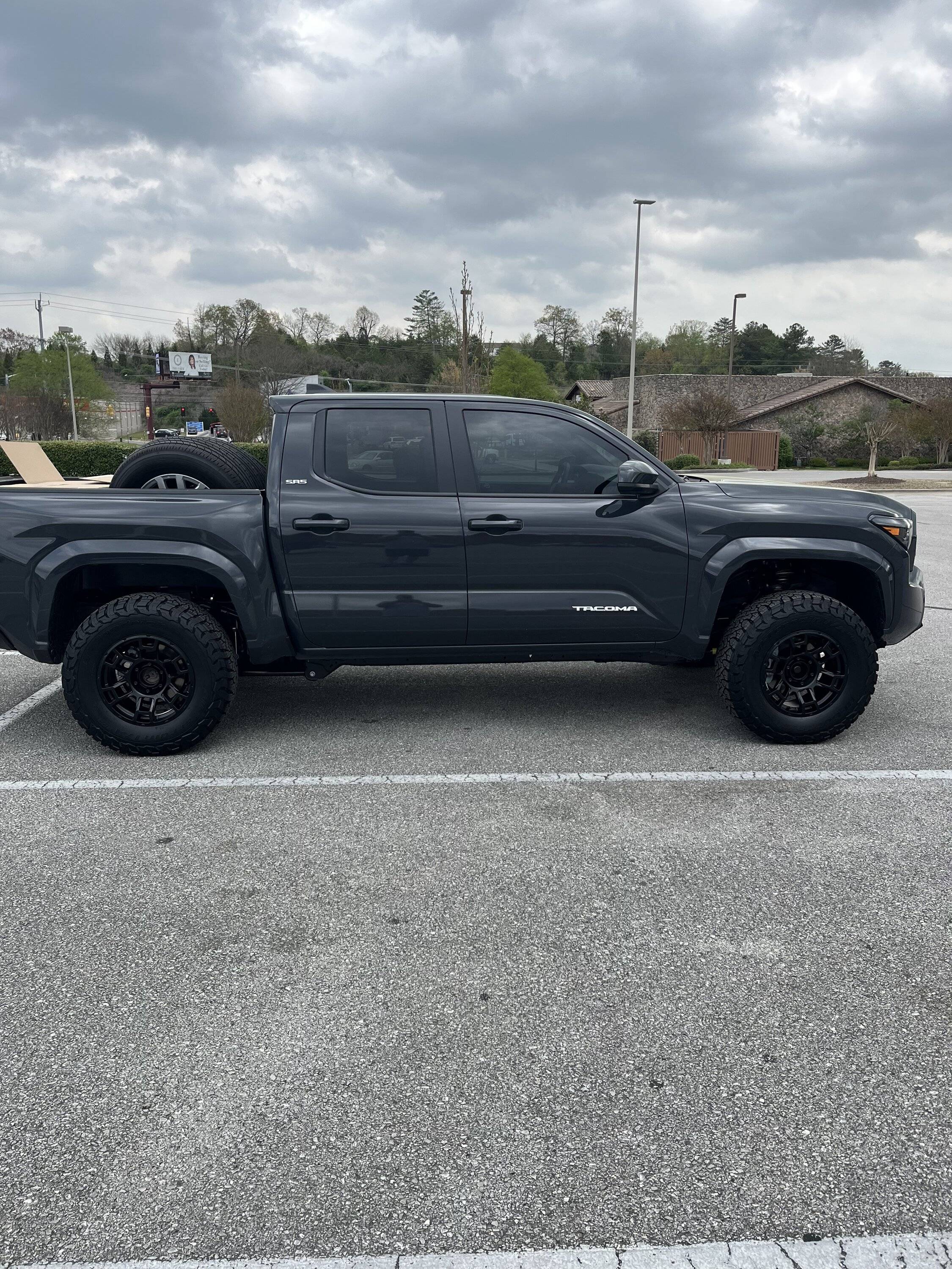

I gave up on the factory TRD wheels and went with these aftermarket.

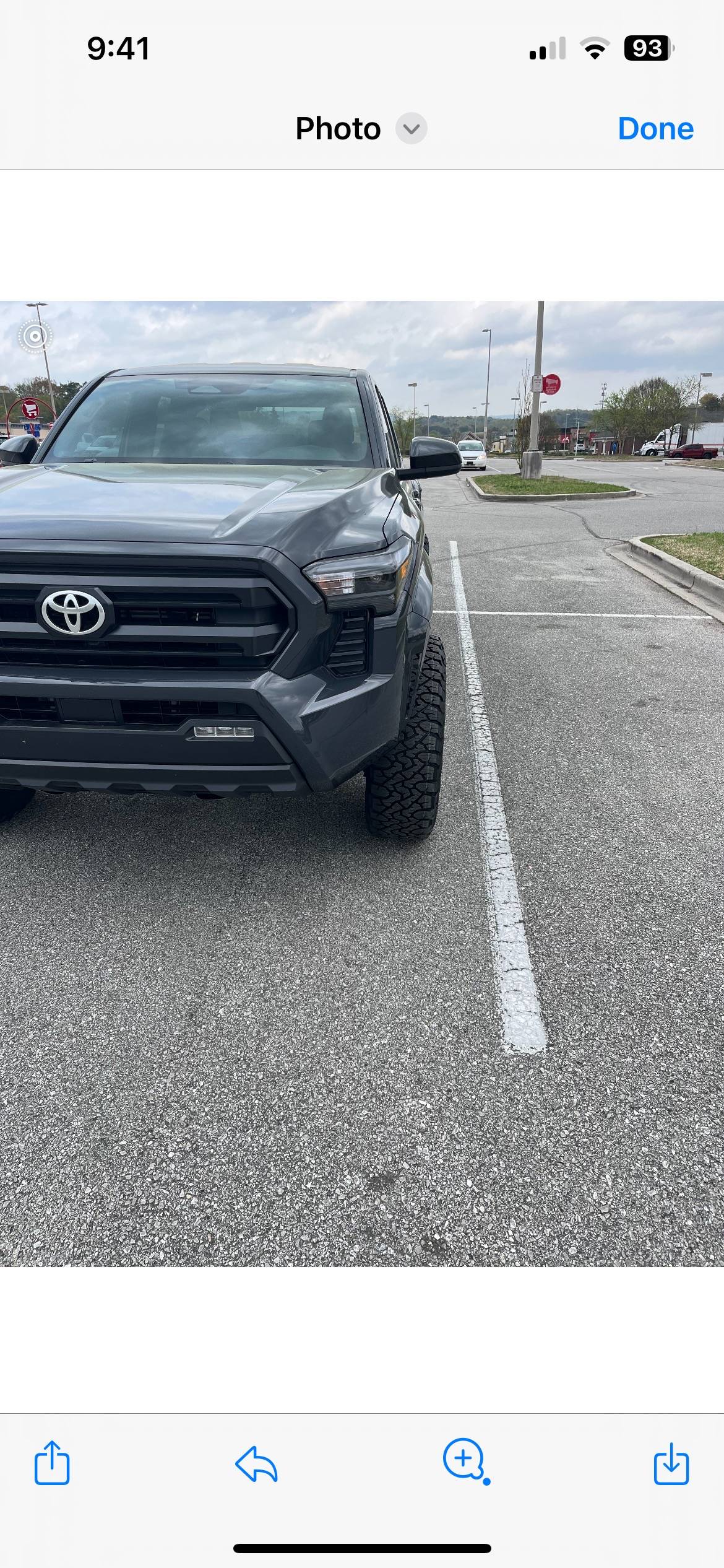

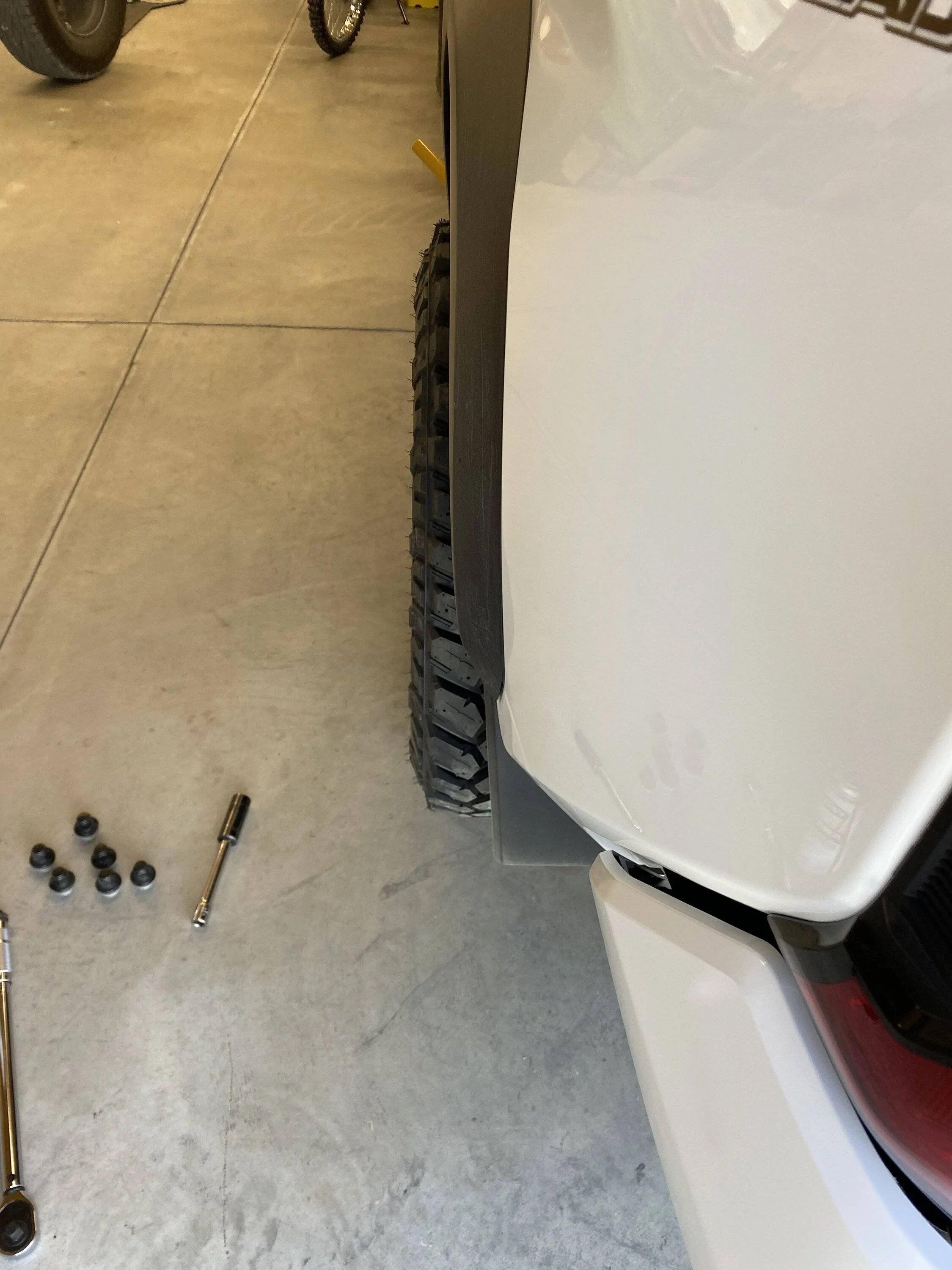

Looks sharp! What size tires and id be curious to see the poke if you have a picture?
285/70/17 KO2
0 offset
VOXX Pro 139.7
It’s a replica wheel
Had to order Factory
Factory tacoma centers were too small
I had to order factory TRD Tundra center caps.

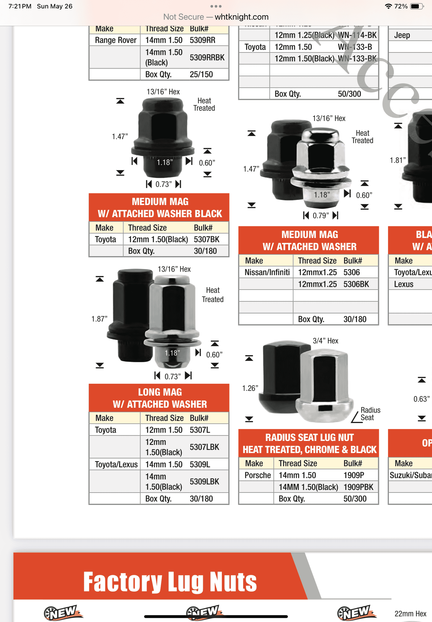

I’m trying to do the same thing. I have the wheels sitting here in boxes, but scratching my head on the lug nuts. 4g lug nuts won’t go through the 3g wheel and 3g lug nuts are too small for the 4g stud. What do I do?
did you ever find the correct lug size for the 3rd gen wheels? Currently running into that issue now

I believe that the lug nut we need is 5309LBK (if you want black), but the few places that carry them are out of stock. I found a place online that is supposed to notify me when they get in. ??? They originally said it possibly could take 90 days.

The 5309 Lugs I keep finding say they have a 0.87" diameter shank, which I think is same as the stock 4G. I thought the magic number was 0.73" or 0.74" ?
I am actually considering the chrome option of the ezaccessory lugs that were posted earlier. I am planning to go with something like the AGP Pro 17"x8" Hyper Black (Silver) wheels with 5mm offset, and then go with 255 x 75 x 17 pizza cutter KO2s. At that point, the chrome lug nuts should look ok.

5309LBK for black. I believe the .87 is 5309D
