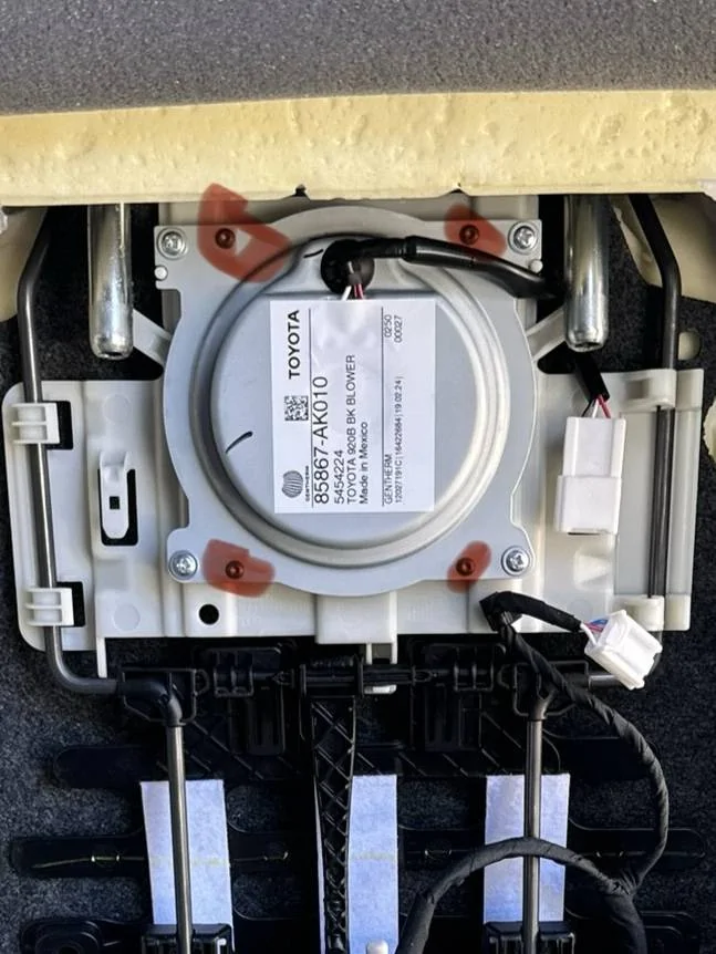

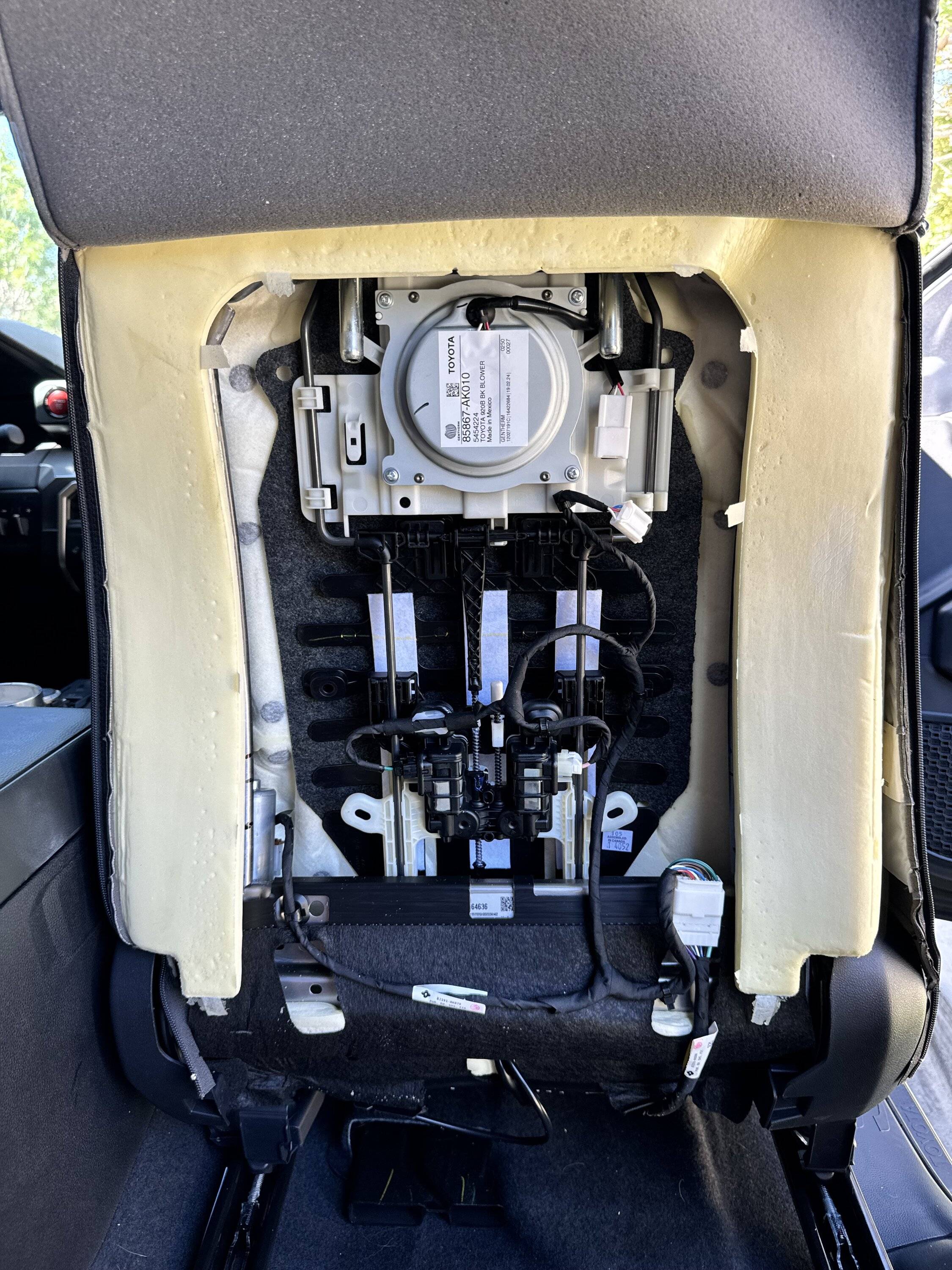

My OR premium passenger ventilated seat was making a louder noise.
Almost like the fan was hitting something. Was going to tell dealer at first free oil change. Was bored today and decided to take things into my own hands.
Unzipped the seat back and removed the fan. Plastic was slightly warped. Didn’t tighten as much on the reinstall. All good now!

Not likely as the fan is isolated from the heat element. It was either warped or too tight. I just took it all apart and sounds good now.
The fan is the circular part top center. Held by 4 screws.

My passenger seat is noticeably loud too, I didn't realize there were two fans. So you just loosened the fan assembly and that gave enough room to clear any warped blades?

I took the fan completely out and took it a part. Try just loosening these 4 black screws without removing the whole fan. See if that helps.

I did mine earlier today... took about 15 minutes. All it was was 1 overtightened screw. Turned the fan on and started to back the screws out little by little and as soon as I started to loosen the first screw, the fan noise stopped.
Sweet. I’m glad I could help.

I did mine earlier today... took about 15 minutes. All it was was 1 overtightened screw. Turned the fan on and started to back the screws out little by little and as soon as I started to loosen the first screw, the fan noise stopped. The culprit was the silver screw on the bottom right. Didn't even touch the black ones.
